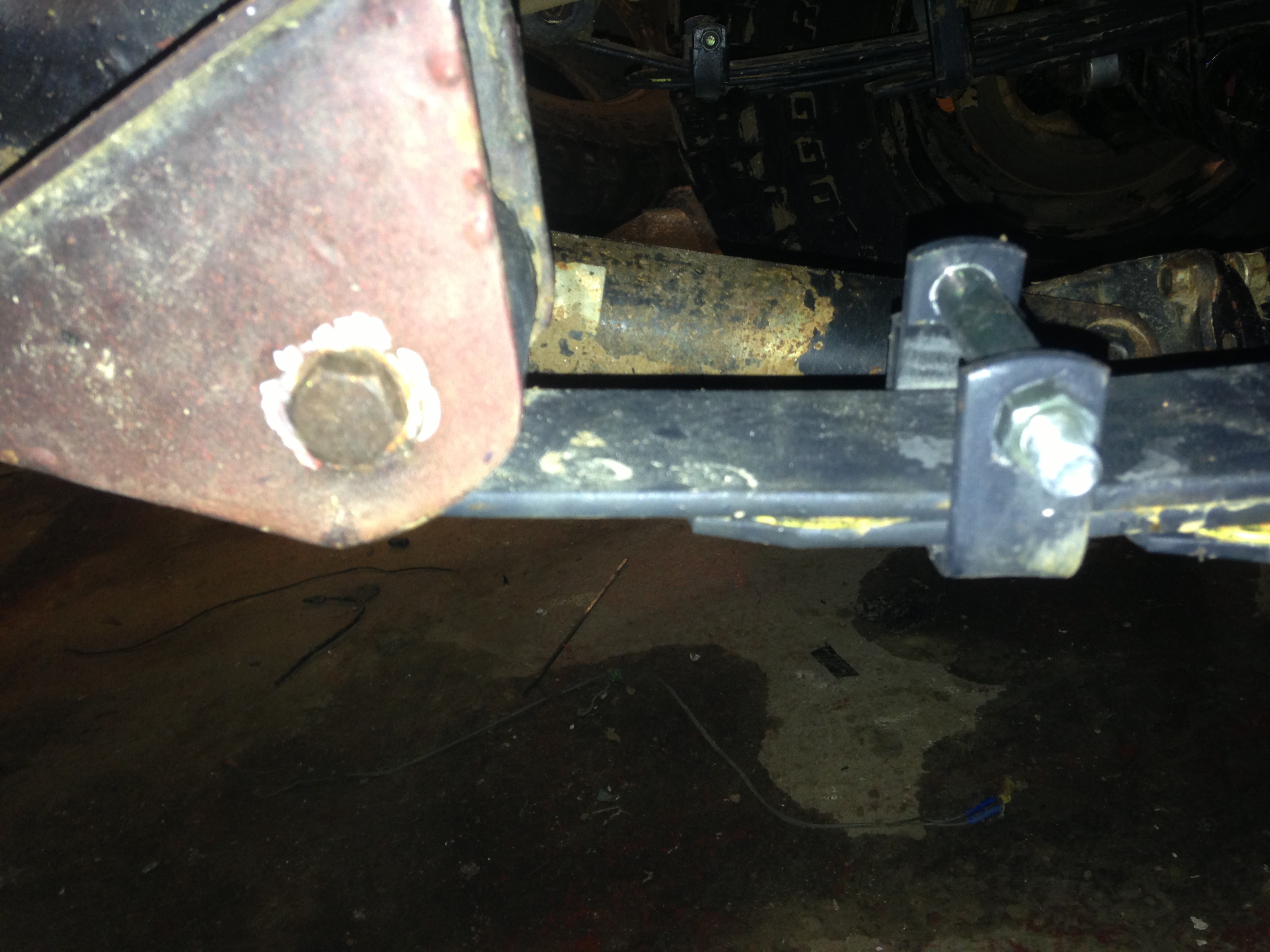

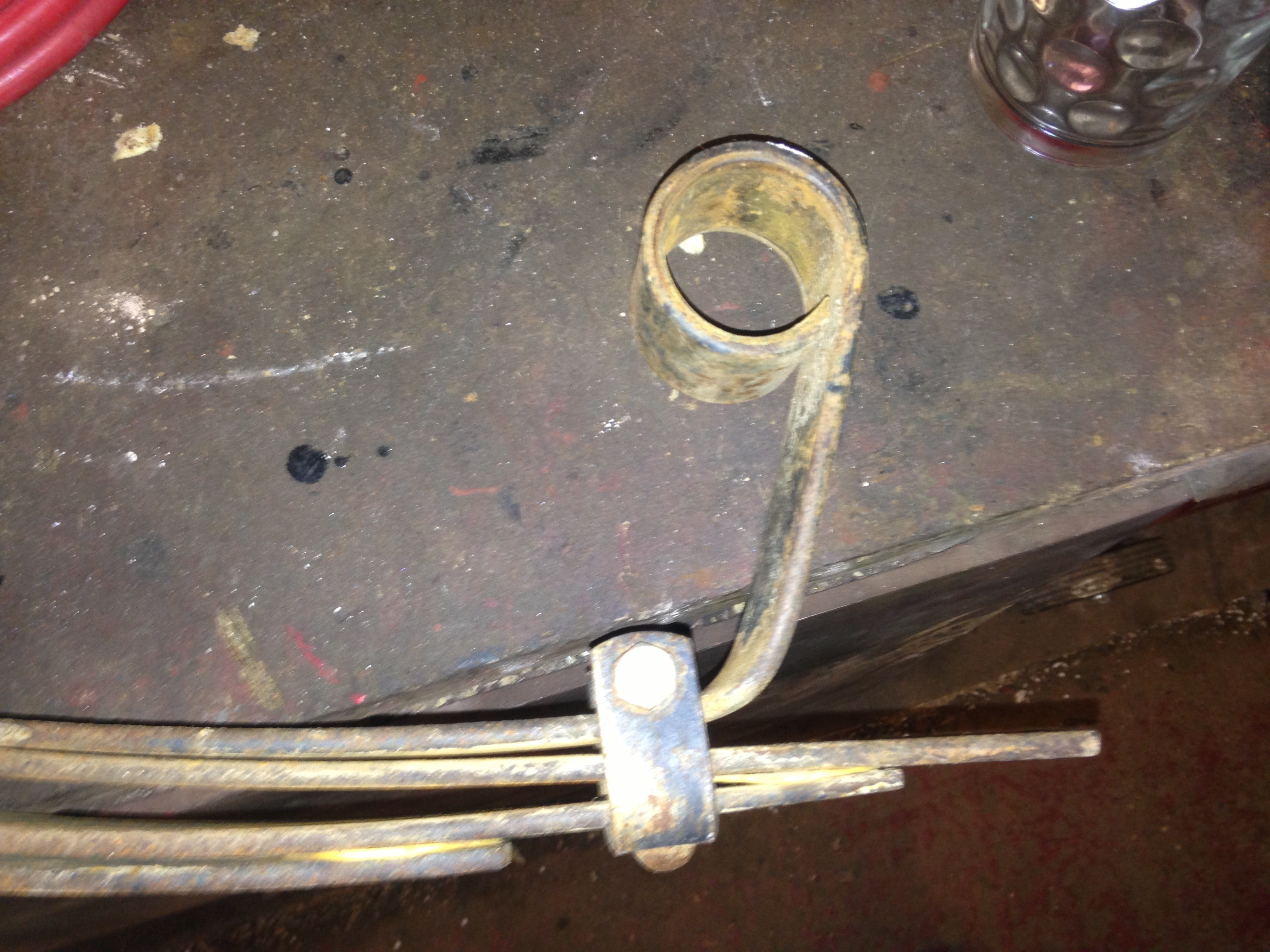

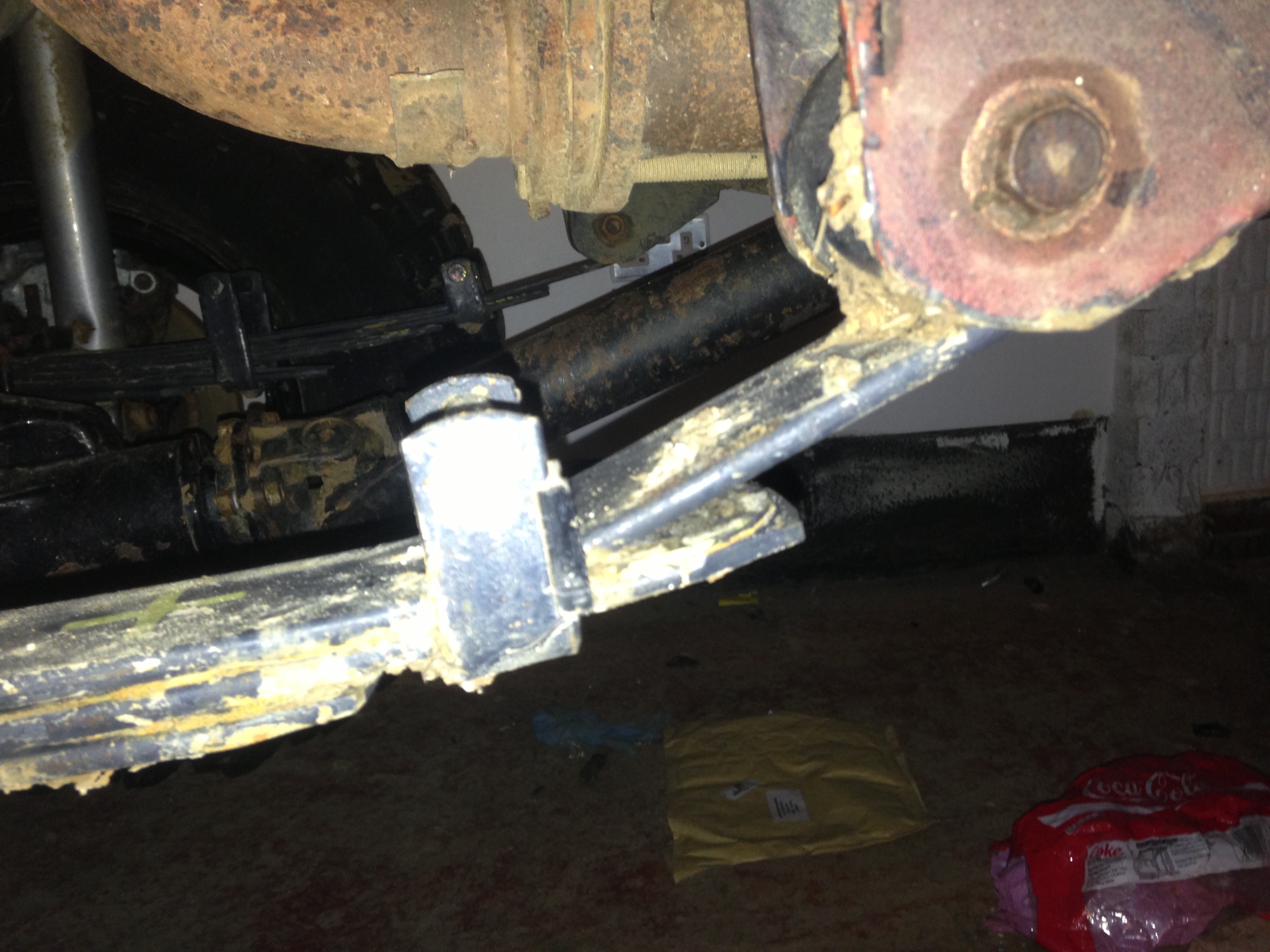

More
- This is the near side
- image.jpg (1.52 MiB) Viewed 5704 times
- Offside
- image.jpg (1.4 MiB) Viewed 5704 times
- How the old one bent
- image.jpg (1.81 MiB) Viewed 5704 times
- This happened too, again it's the wiping bending in on itself
- image.jpg (3.33 MiB) Viewed 5704 times
- mike harris
- SCUK is my life
- Posts: 1828
- Location: hascombe Surrey
The issue is the missing links, when they open the springs is free to swing back, this is when it's put in the position to bend. We are talking hard winching though, it's only done it in extreme situations.
My plan is to use some other springs I have, and the top leaf will wrap around the current top spring at each end, a loose fit to still allow flex, have them clipped as far back as possible, I think that would cure it.
I flat refuse to fit a bam bar front or rear, I don't see the need, and there is no way I will reduce my front flex.
I spoke to someone not so long ago who made there links with a pin, so you could lock them to stop them opening. I could look into this, but I think it's a faff.
