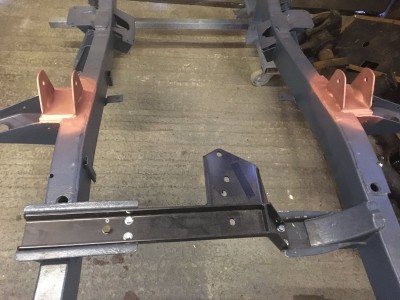

Guess i should probably add my tiny amount of progress I made just before the Lockdown :lol: Auto gearbox crossmember fitted and swb rear spring hangers welded on for my RUF conversion.

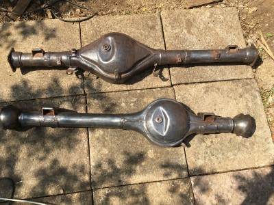

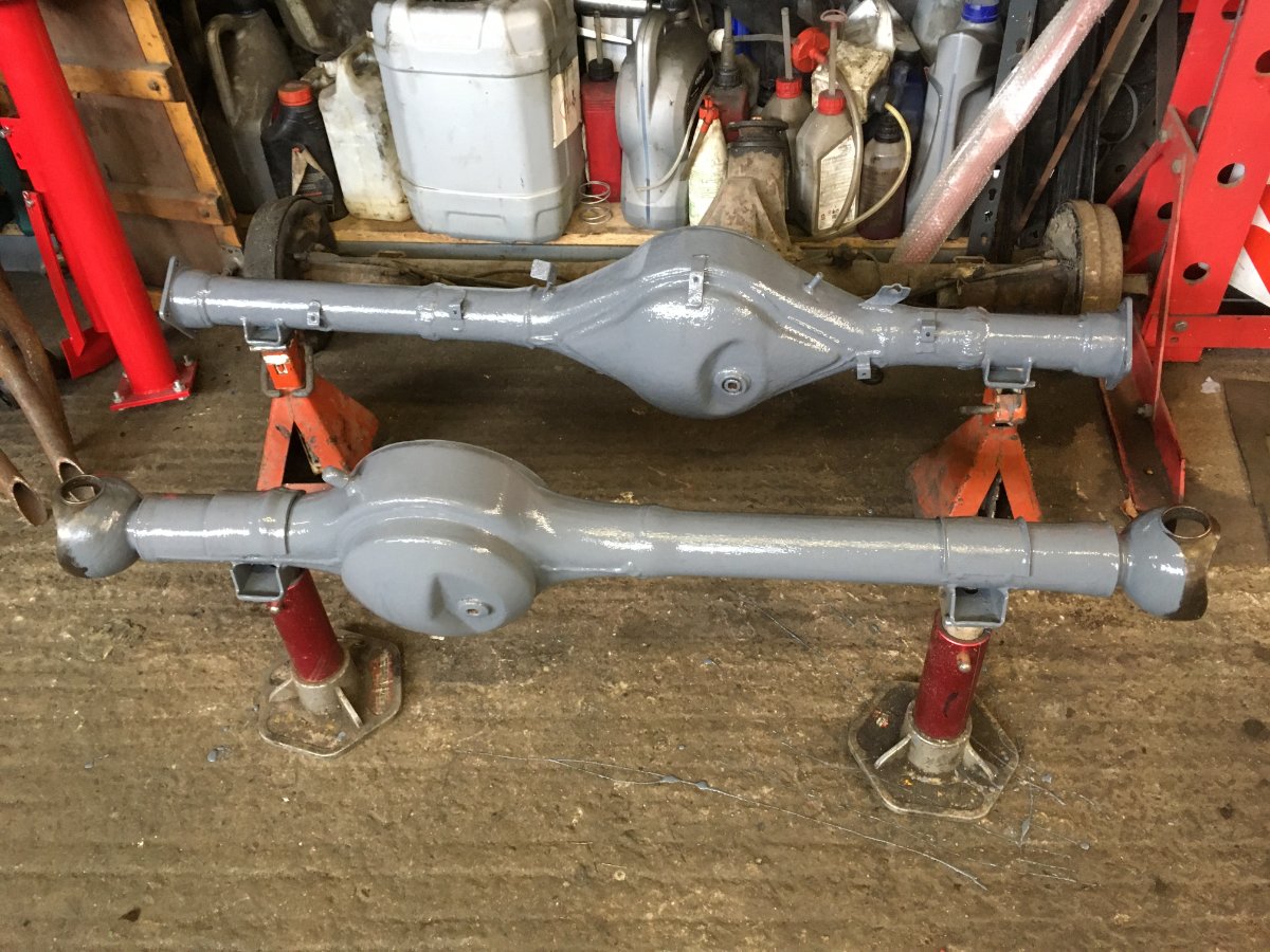

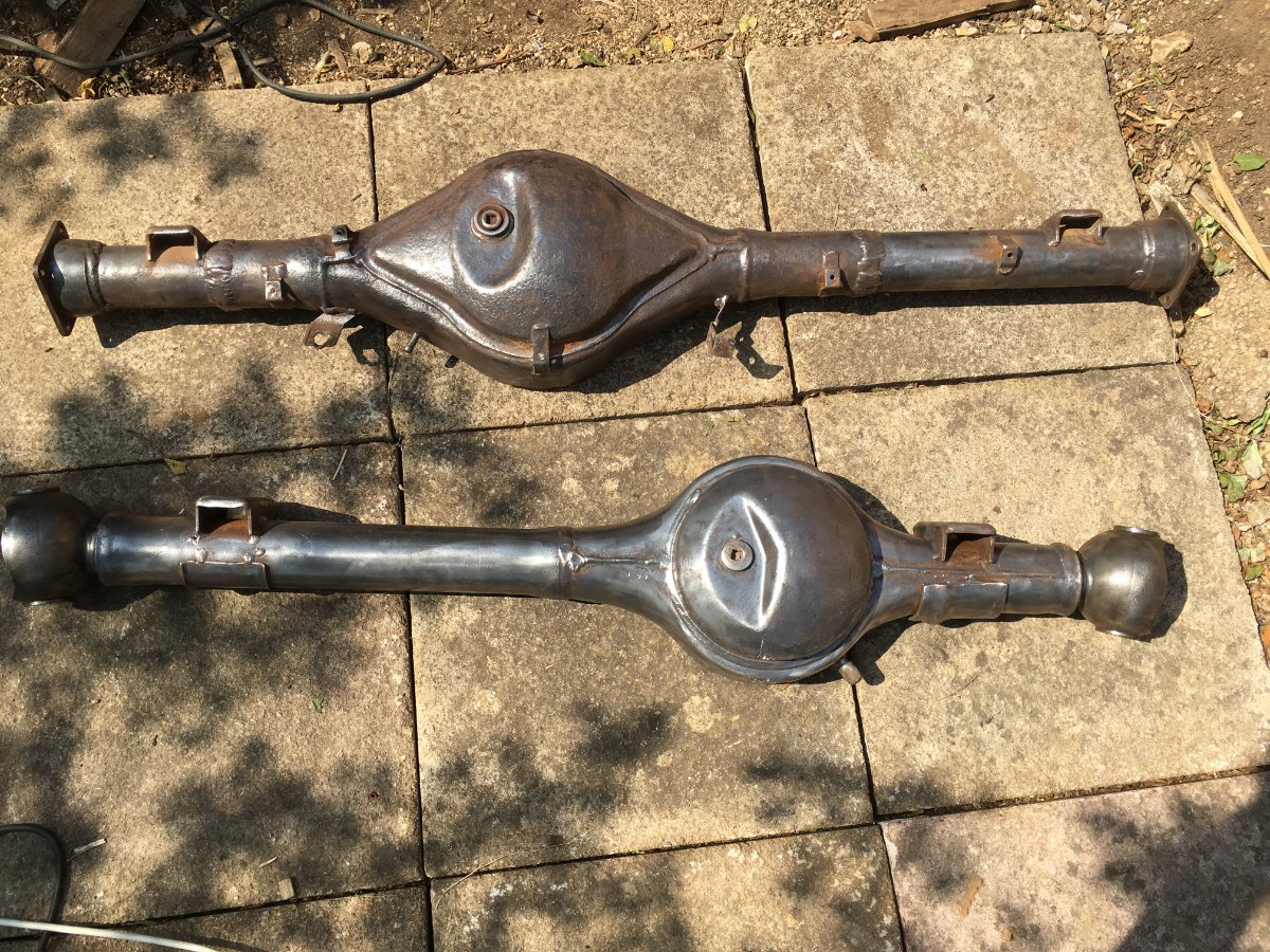

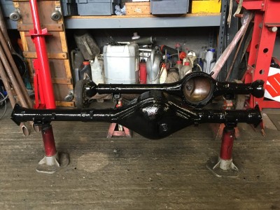

Cleaned up and slapped some rust treatment, primer and paint on the axle cases, I picked up a vit/sammy hybrid axle cheap, it's not pretty but it seems to be straight so i'm gonna run it and see with 4.3 diffs front and rear.

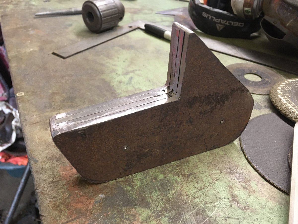

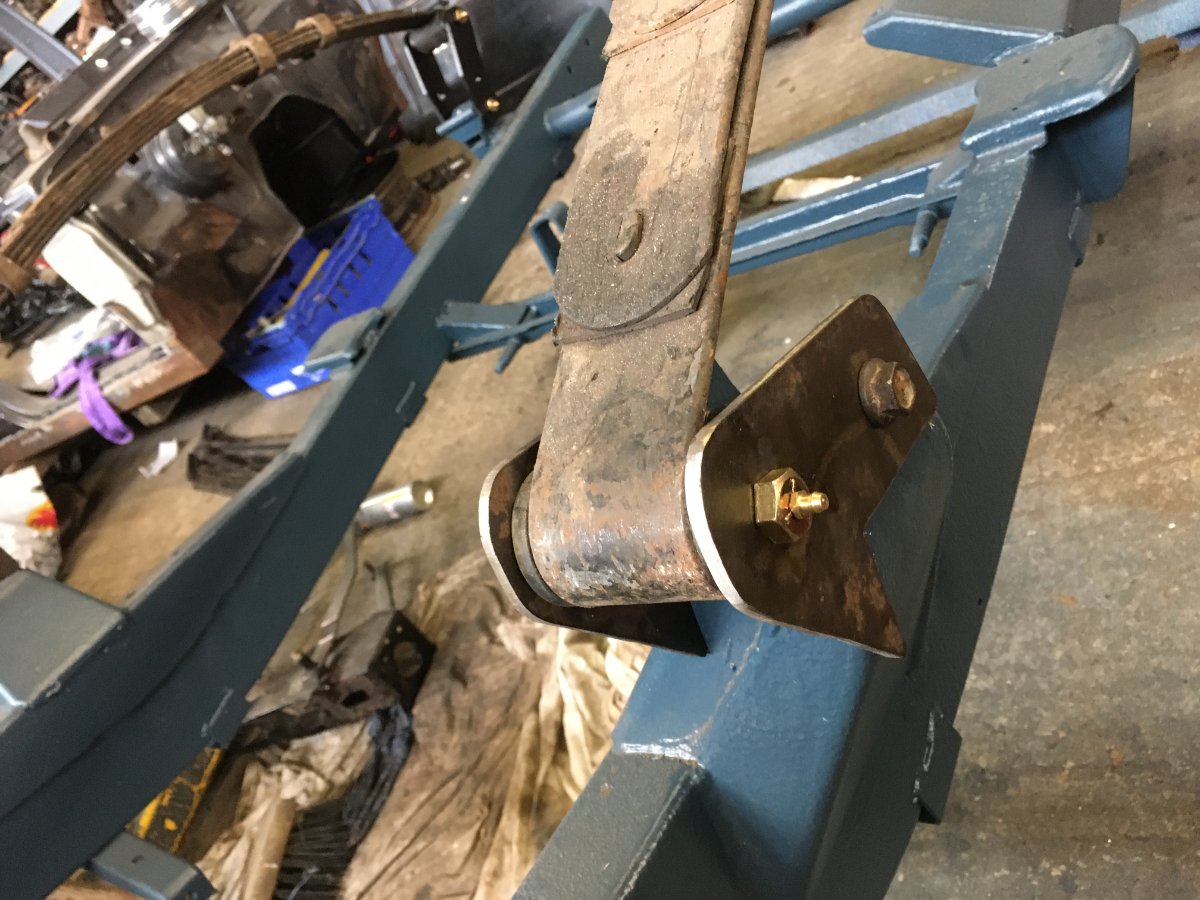

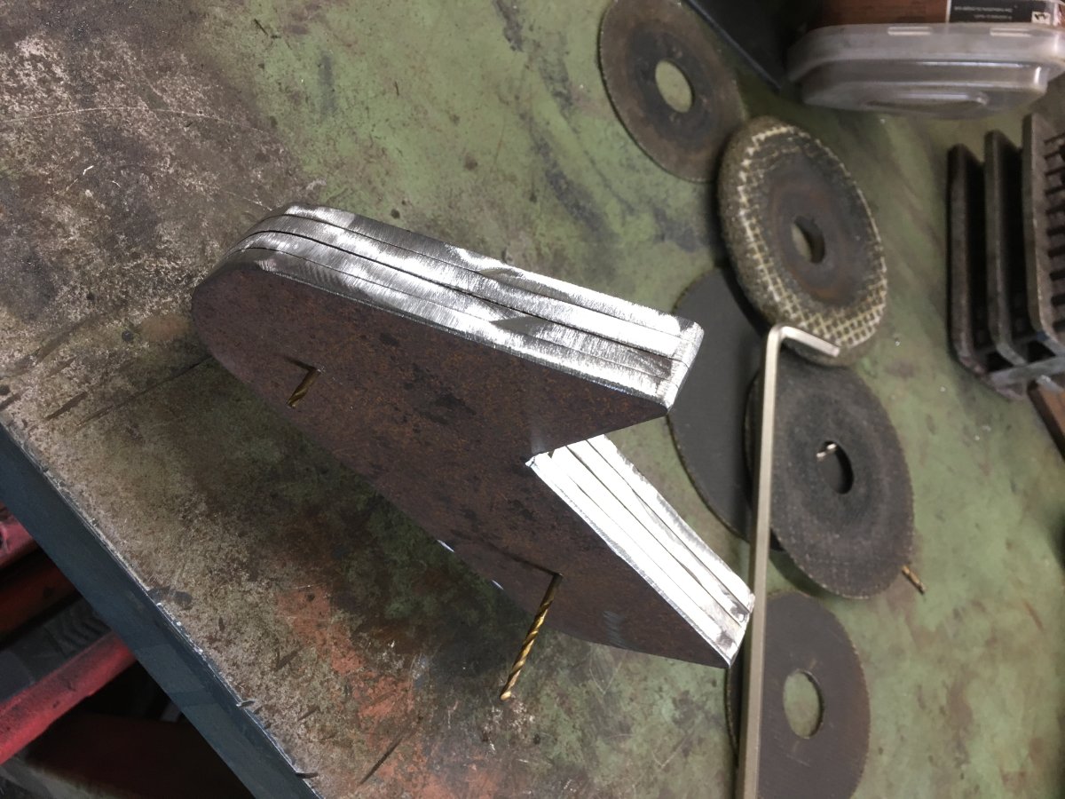

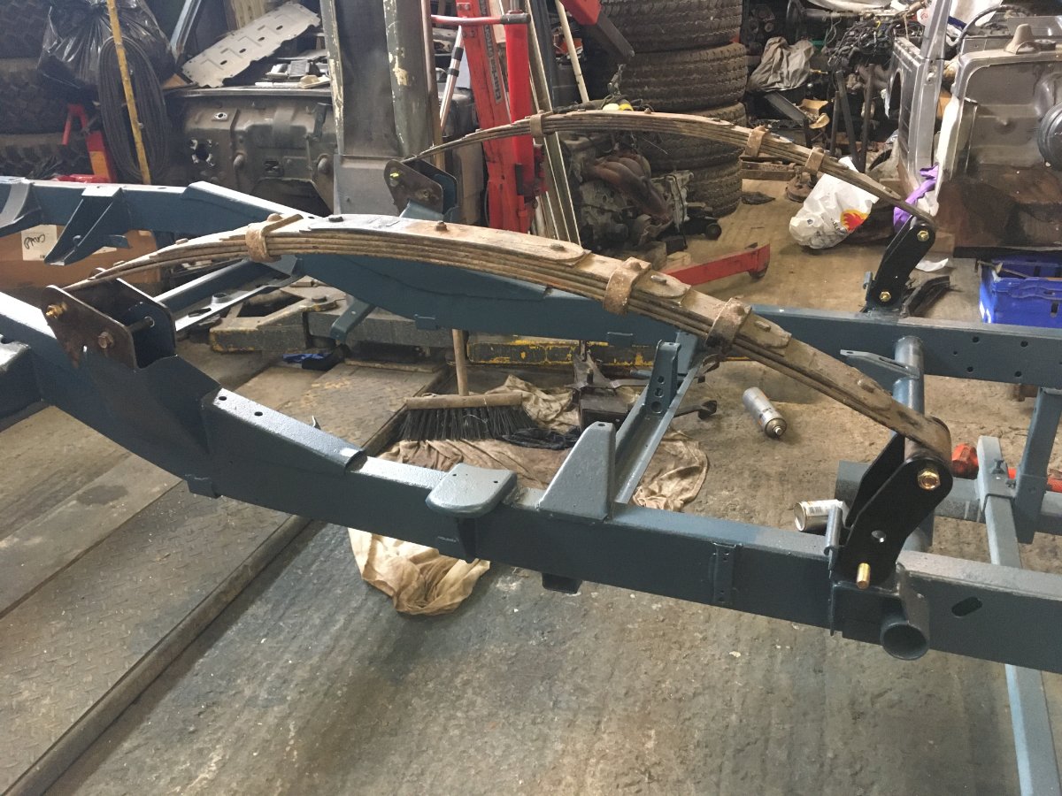

Then started work on the rear YJ set up. This was fun as my old Fobco star pillar drill seems to have devoloped a lot of run out so I ended up drilling these by hand. Gonna whip the chuck off the drill when i get a chance, hopefully it's just the chuck.
Focusing on the narrowboat project over the last few days but i'll finish the YJ mounts off next time I'm up the workshop.
Re: Lwb daily drive and laner build
Post by donkeychomp » Sun May 24, 2020 9:22 pm
Scottie are those mounts made of three seperate bits welded together? Whatever you've done it seems to work!
