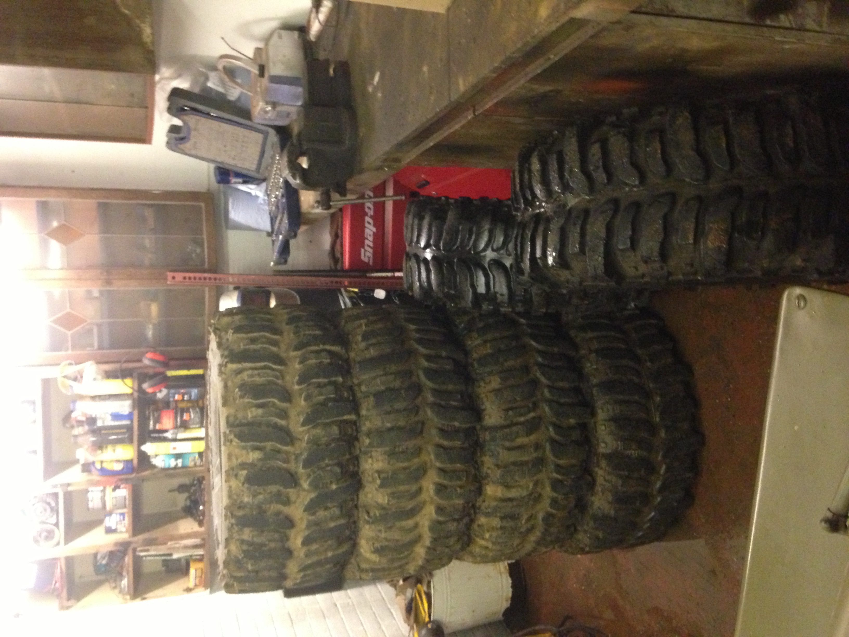

I got my new boggers at the weekend. Not sure about them yet though, there big. 35 14.50 kind of big.
The issue I have is my boggers clog in mud, but every time this happens all other trucks at these events all have clogged tyres as well. No tyre cleans that well. So what I am thinking is, is it worth it? In sandy terrain or rocks yes. But mud which is most of what I do, I am not so sure.
Conundrum.... Fit them, see what needs cutting to make them fit. Try them.
Or sell them and forget about the whole thing.

Mike - the thing about tyres "clearing" mud is that you can't just look at them and tell.
See, when your tyres *look* like slicks made out of mud, you have to bear in mind that it's only there temporarily - the moment you start moving again, it'll get squeezed out at the bottom and replaced with new mud. Or if you floor it, it'll fling the mud off.
So even when your tyres are completely clogged, you'll still get that "paddle boat" effect and get more traction with decent MT's than you would with road radials or AT's.
Essentially, the new mud squeezes the old mud out through the sides. This is only really helpful if you floor it, or if your tyre cuts through the crap to the solid stuff underneath. When you're flinging mud around by flooring it, the ejected mud is actually sometimes all that is propelling you along - there's a whole science to it (it even has its own name, which I can't remember for the life of me) that the top rally car teams get right into.
But essentially it's a bit like a paddleboat - you push something violently in one direction, you move in the opposite direction. Which is one of the things that makes an SJ awesome - sometimes we "float" over things others sink into because we're so light, and this "paddleboat" effect keeps us moving.
When it goes wrong, you sink, bog down and dig in. Watch some of the american bog runners when they stop - they *visibly* sink. You can see the moment when they stop "floating" and start to sink/dig, and at that moment you know it's all over for them.
Click Here for Youtube Video
Having said that, I think your truck is too far beyond the rest, so for our sanity, you're going to have donate those tyres to the Anton truck awesomeification program...

I say get trimming and trying!

Yeh, il try them

There sat there looking at me.....
- image.jpg (1.63 MiB) Viewed 5016 times

New springs turned up today, so did the fuel pump and new fan.
Fitting a 35 on a wheel tomorrow to eye them up to see what they look like, my plan is to make my mind up on them then maybe cut the front end. I will also limit the upward travel, to stop the tyres from hitting the bulk head and front flitches. And maybe prolong the life of the springs.
The new springs are the same as the old ones but I am going to leave the bottom hard leaves in, like in the rear. These should help with axle wrap which I am worried about with the extra grip from 35 inch tyres.
