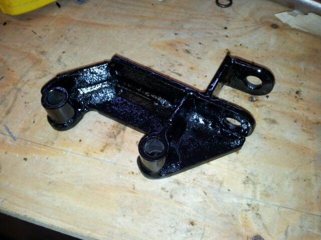

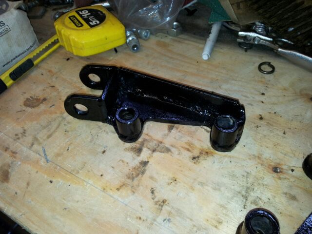

turbo-tom wrote:Very nice so pressuming the shock bracket will swivell on the 8mm plate or am I missing something? Looks like it really has been thought through :hands:
Thanks tom yeah It should swivel on the 8mm plate using the brass disc as a thrust washer to give slip and reduce friction at the joint

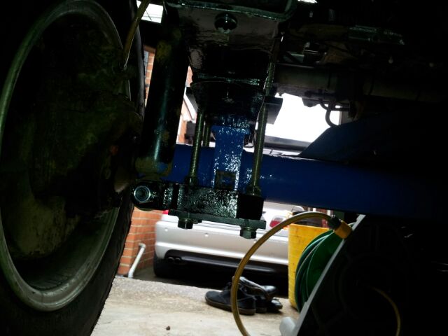

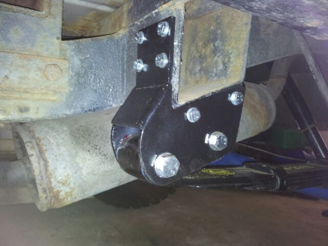

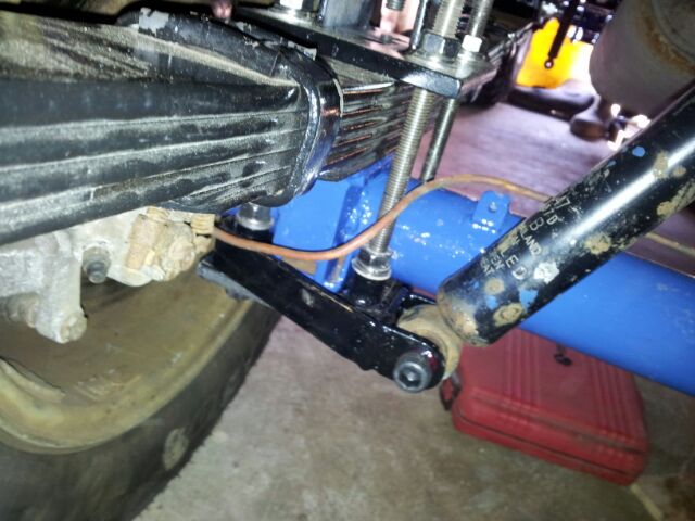

Firstly drilled the anti rotate holes in the rear mounts.
Then I made mounts for the bottom of the front and rear shocks
And then fitted them

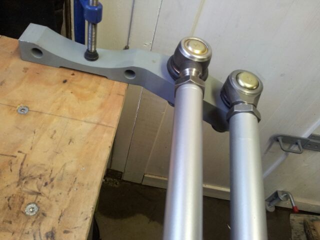

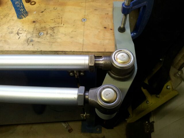

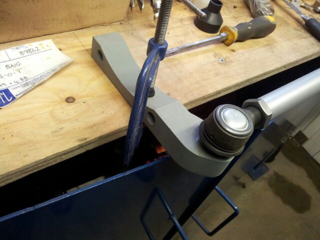

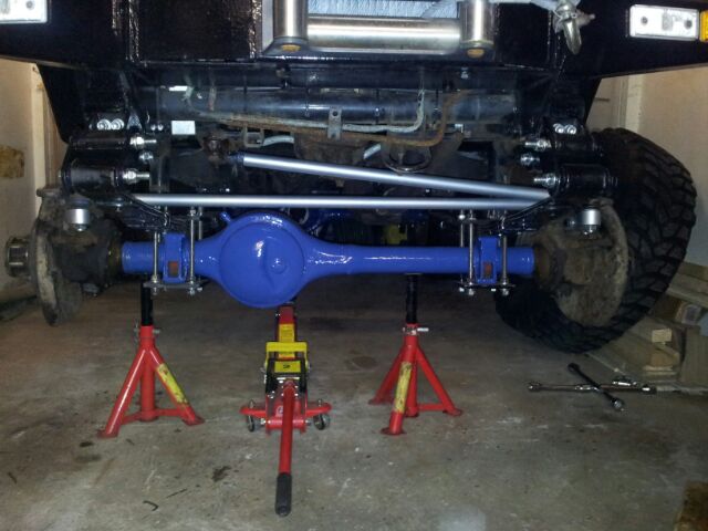

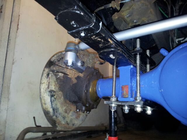

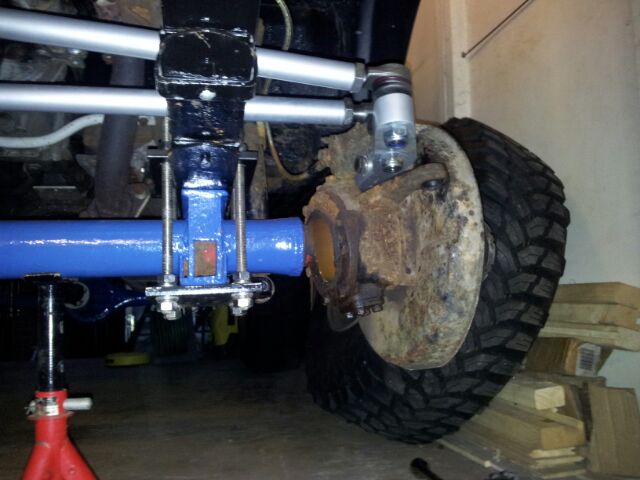

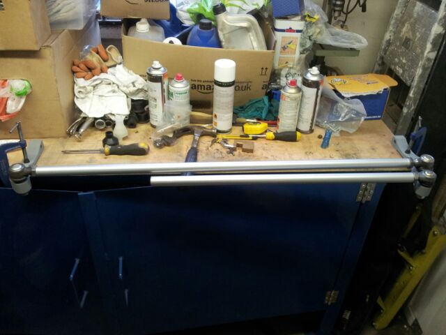

Right time now to revisit OTT steering as previously shown arms have been machined and now its sitting at the height I wanted ive now measured up the tie rods. I am using ford transit track rod ends with a m20x1.5mm thread both left and right hand to create a tracking rod then the other will be transit one end snd standard sj the other. Heres some pics of it on the bench just got to fit it now

by Jordi
That is super tidy!

Thanks for the comments, I had a bit more time today than I thought so I fitted it
Re: 1991 Suzuki Samurai build
Posted: Sat Oct 26, 2013 11:17 pm
by dazerede
Wow u have done a realy nice job on.this sj
