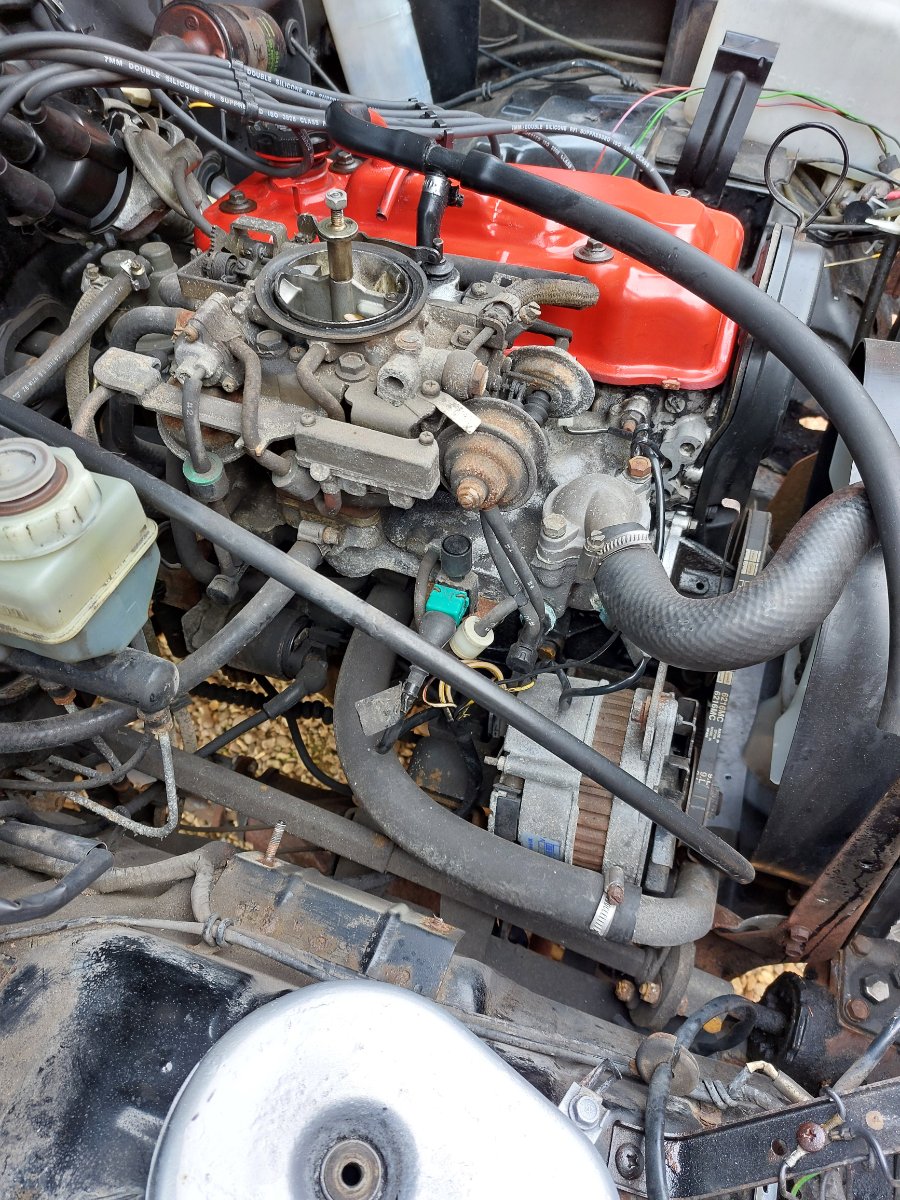

Next item is removal of carb and inlet manifold. Nightmare to understand all the hoses and what goes where??
Am replacing with a SU HIF44 and Rockwatt manifold. Not 100% sure what is retained and what can go.
The carb bolts are from the top of the carb. Another Spanish variation?

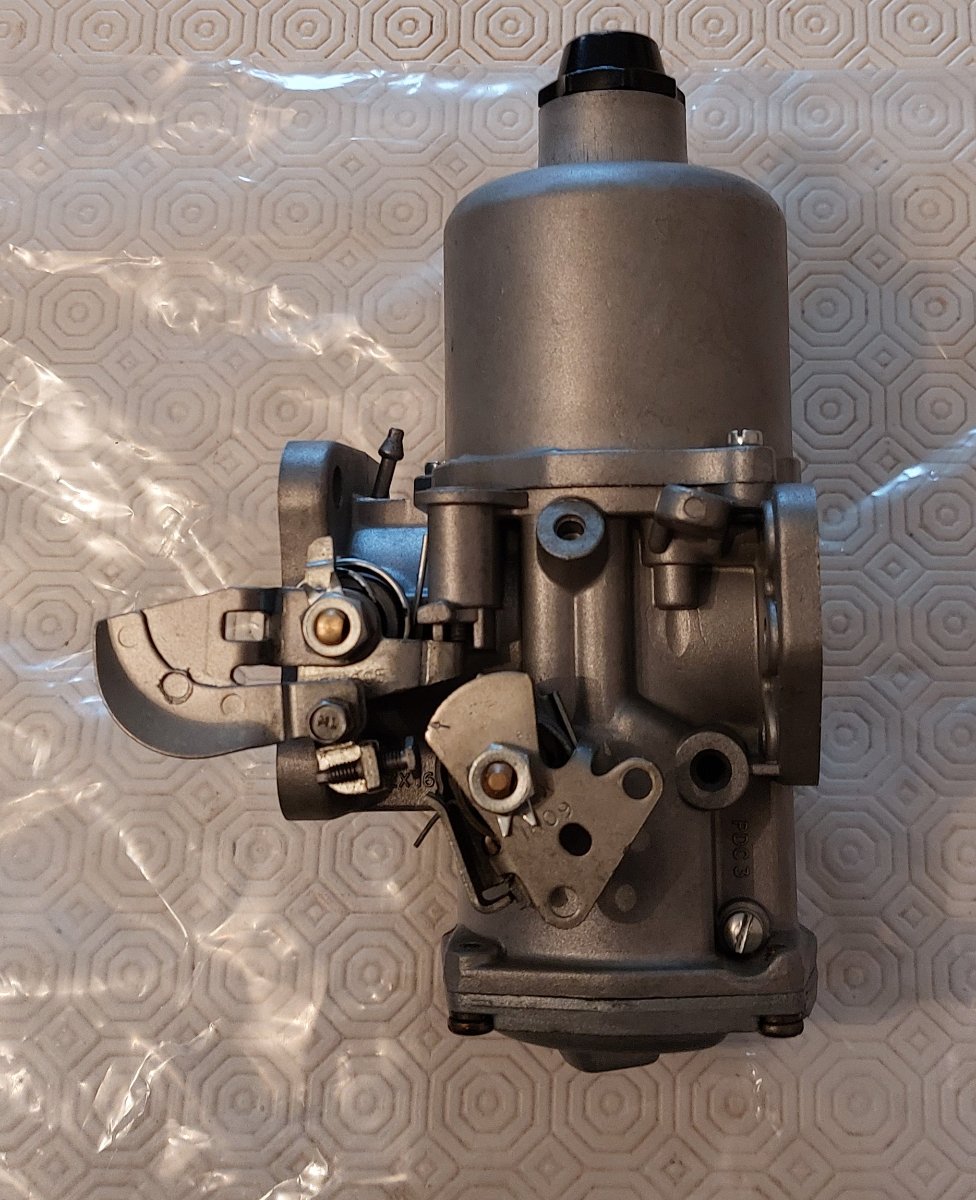

Post by tomcat » Tue Mar 12, 2024 10:29 am
The SU HIF44 I have had rebuilt. Now sorting out and ordering all ths parts I need to fit it.

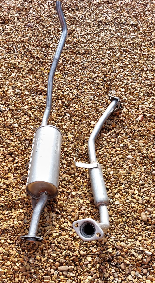

Post by tomcat » Tue Mar 12, 2024 2:59 pm
Exhaust system unpacked ready for installation.

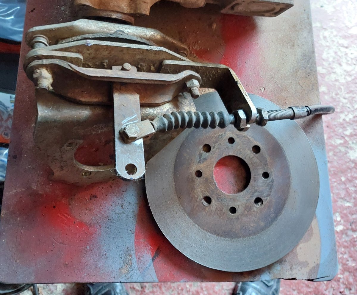

Attached picture shows secondhand X-Eng transfer box handbrake I purchased.

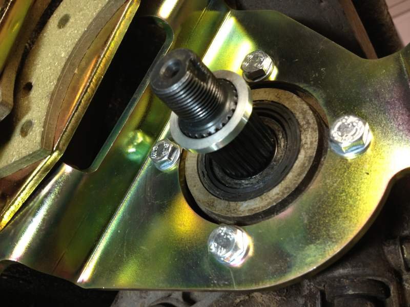

Have got new pads and a cable but am lacking a spacer ring. Picture attached showing how it fits.
Have tried to source without success. Anyone on here have any ideas at all?

Post by tomcat » Thu Mar 14, 2024 12:09 pm
Someone with a spacer contacted so problem solved.
Onto the next challenge!!
