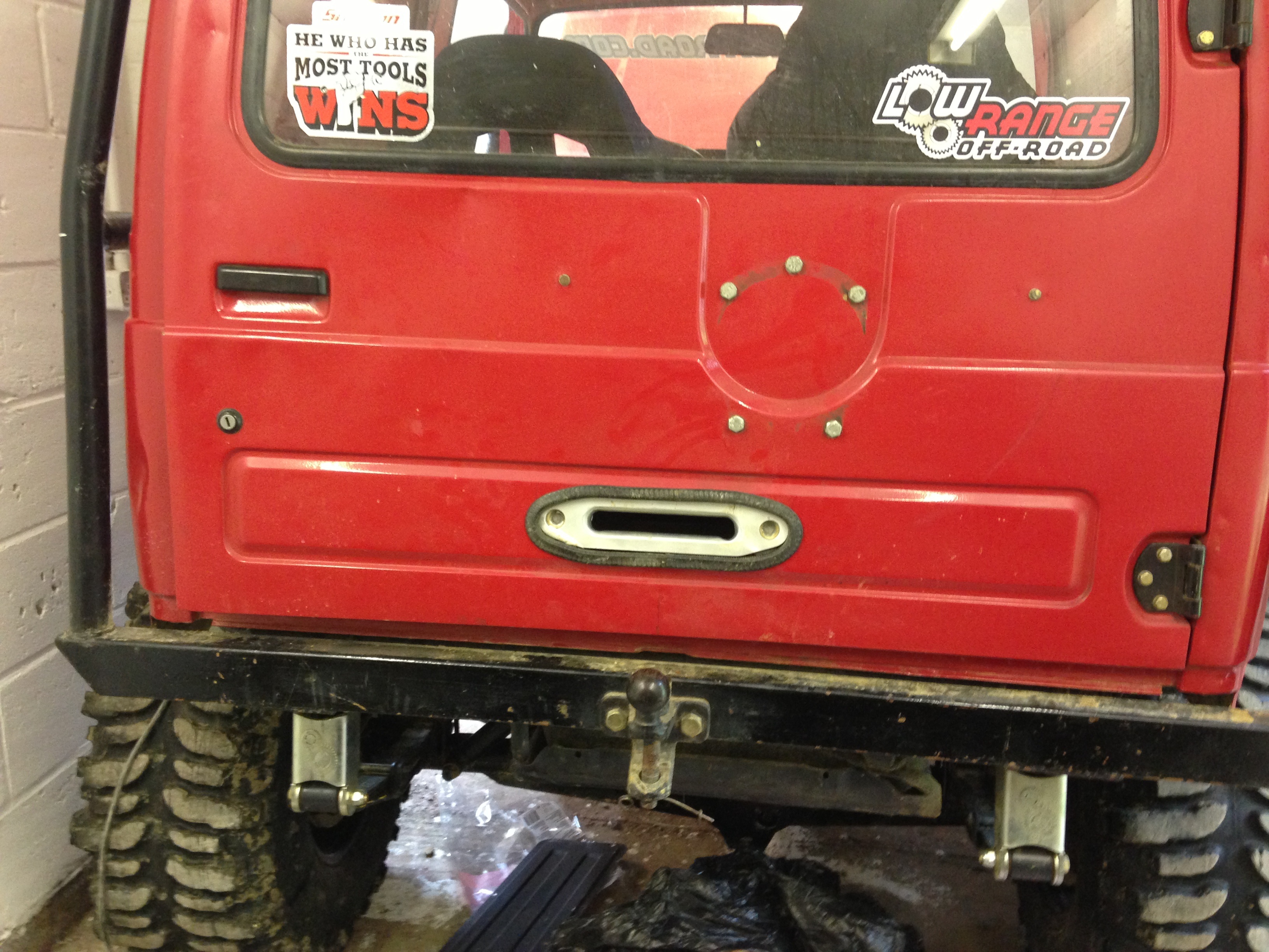

This rear winch should be relatively light weight, the way I am mounting it is simple :) think you may like this boys !! .....

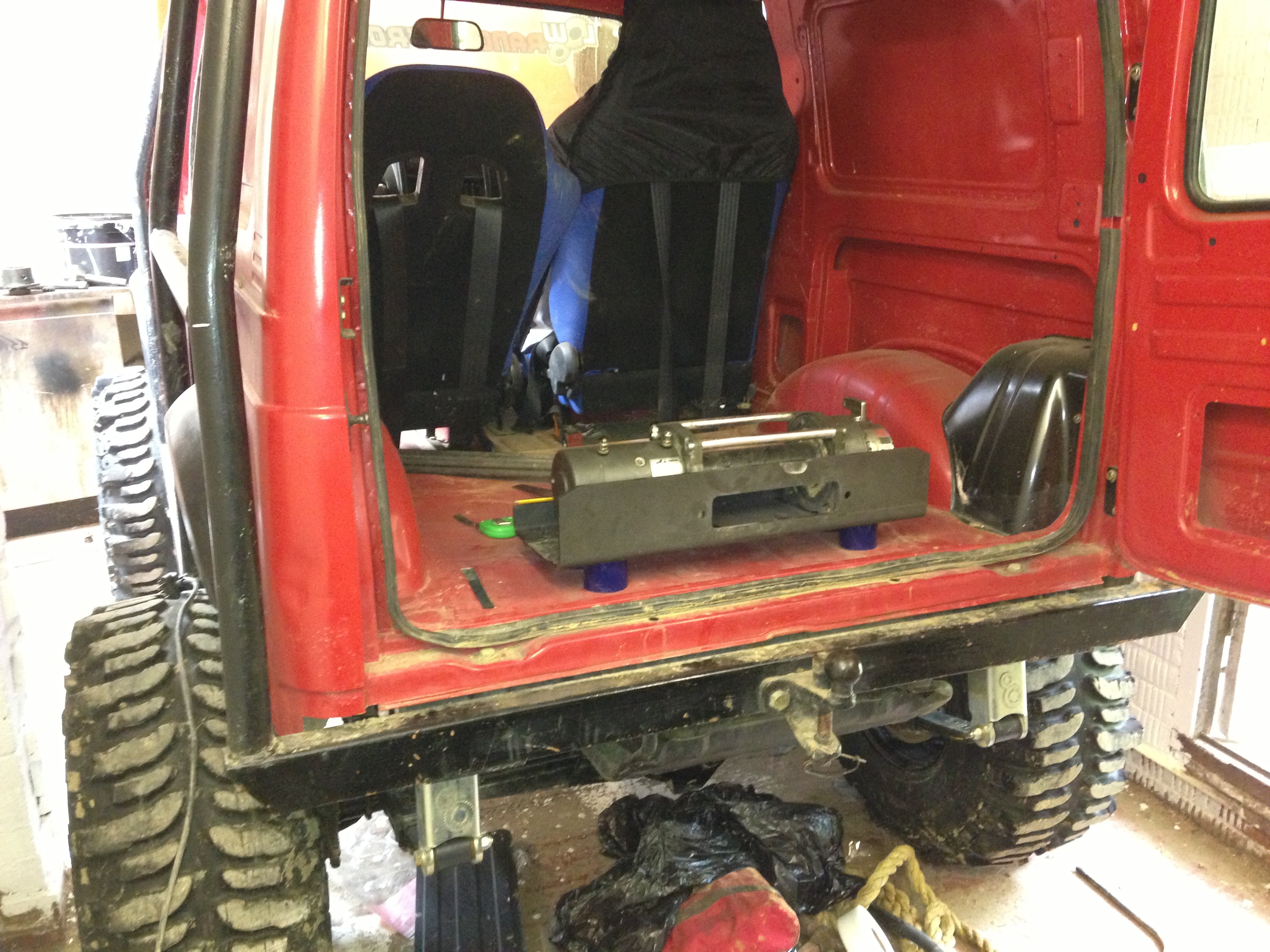

Right here's the rear winch idea...

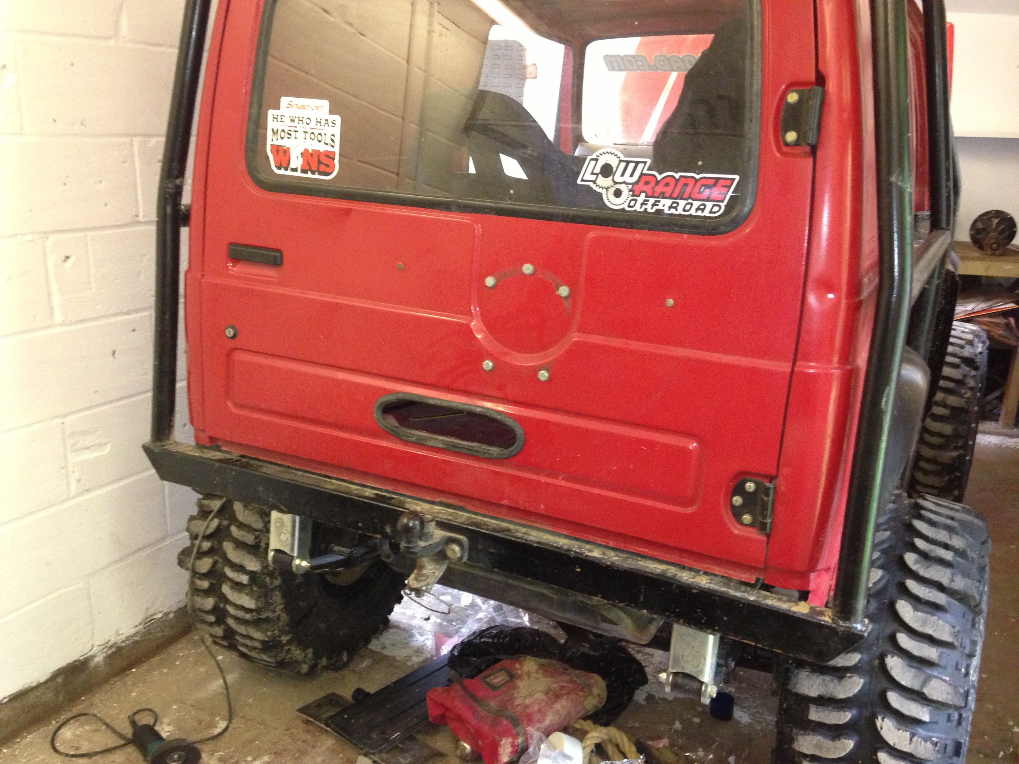

Few more

Nice, I presume you're adding a couple of cross braces across the chassis above the tank to bolt it all to?
Post by mike harris » Sun Aug 25, 2013 12:35 pm

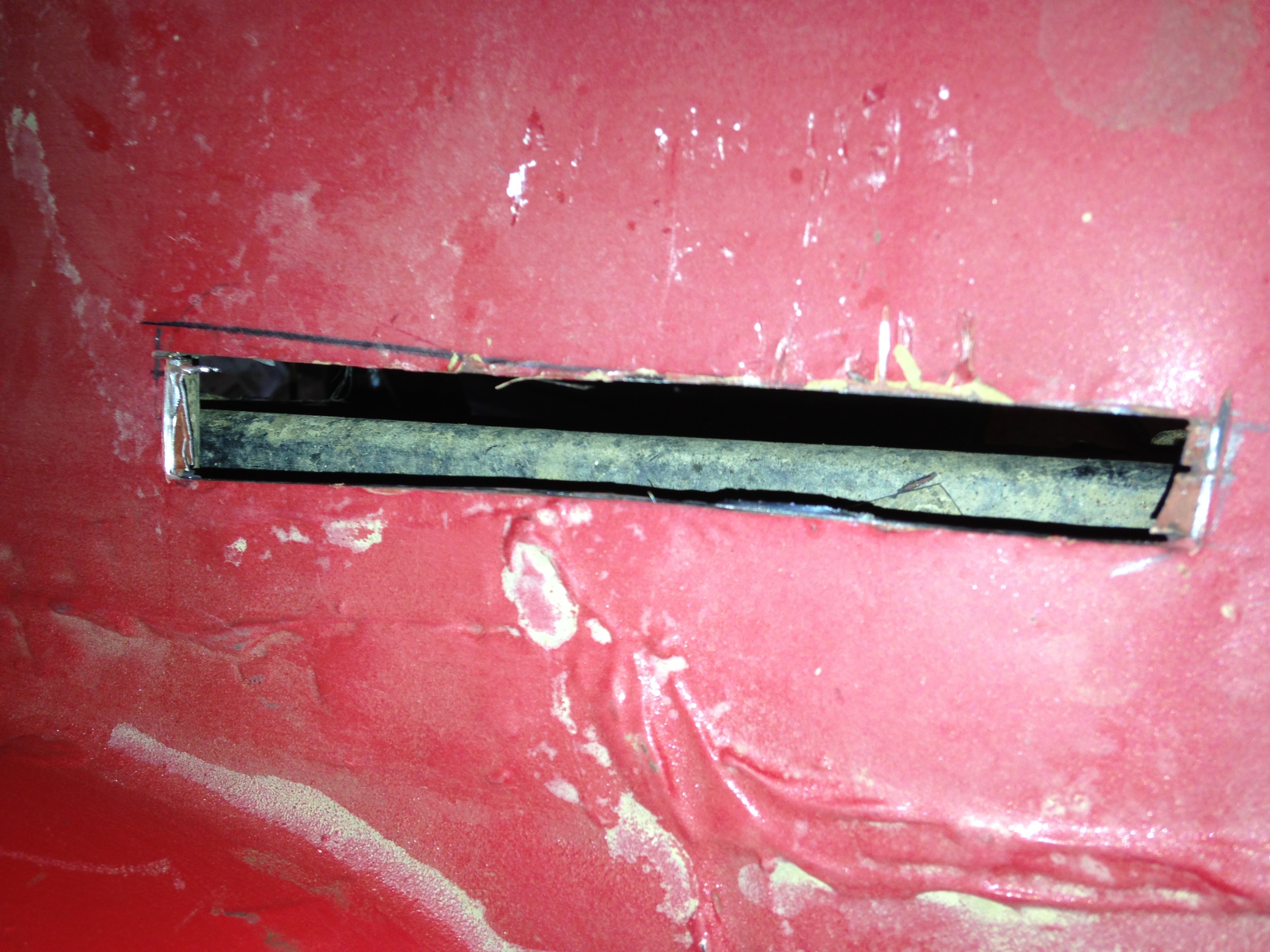

Right here's my plan. I refuse to move the fuel tank, so I am running 6mm plate 8 inches tall and 200mm wide up the chassis through the floor. Then box section connecting either side together 40mm x 40mm 4mm sidewall. Then drill holes in the box and weld in captive m12 / m14 nuts to bolt the winch tray to, thus allowing acces to unbolt the winch.
The only part I am struggling to try to work out how to make look good is the bracing side to side, where the tank is near as makes no sufferance hard up under the body, I have to run the bracing inside over the floor.
The winch tray is set back from the door buy about 3 inches, this is because of all the rear crossmember a and where the rear part of the shell is strengthened. So where the winch haze is bolted on, I am going to elongate outward, the bottom face will be angled so when the winch drum is full it can't fowl.
It will all become clearer as I go on.

Post by mike harris » Sun Aug 25, 2013 1:35 pm
Next step will be to take the motion lotion tank out, and start to clean the chassis and make the upright plates, then I can work out how high to mount the cross bars to make the hawse of the Geoff in the right place. That going to be tricky, then it's the modding the Troff to make it 3 inches longer !!
