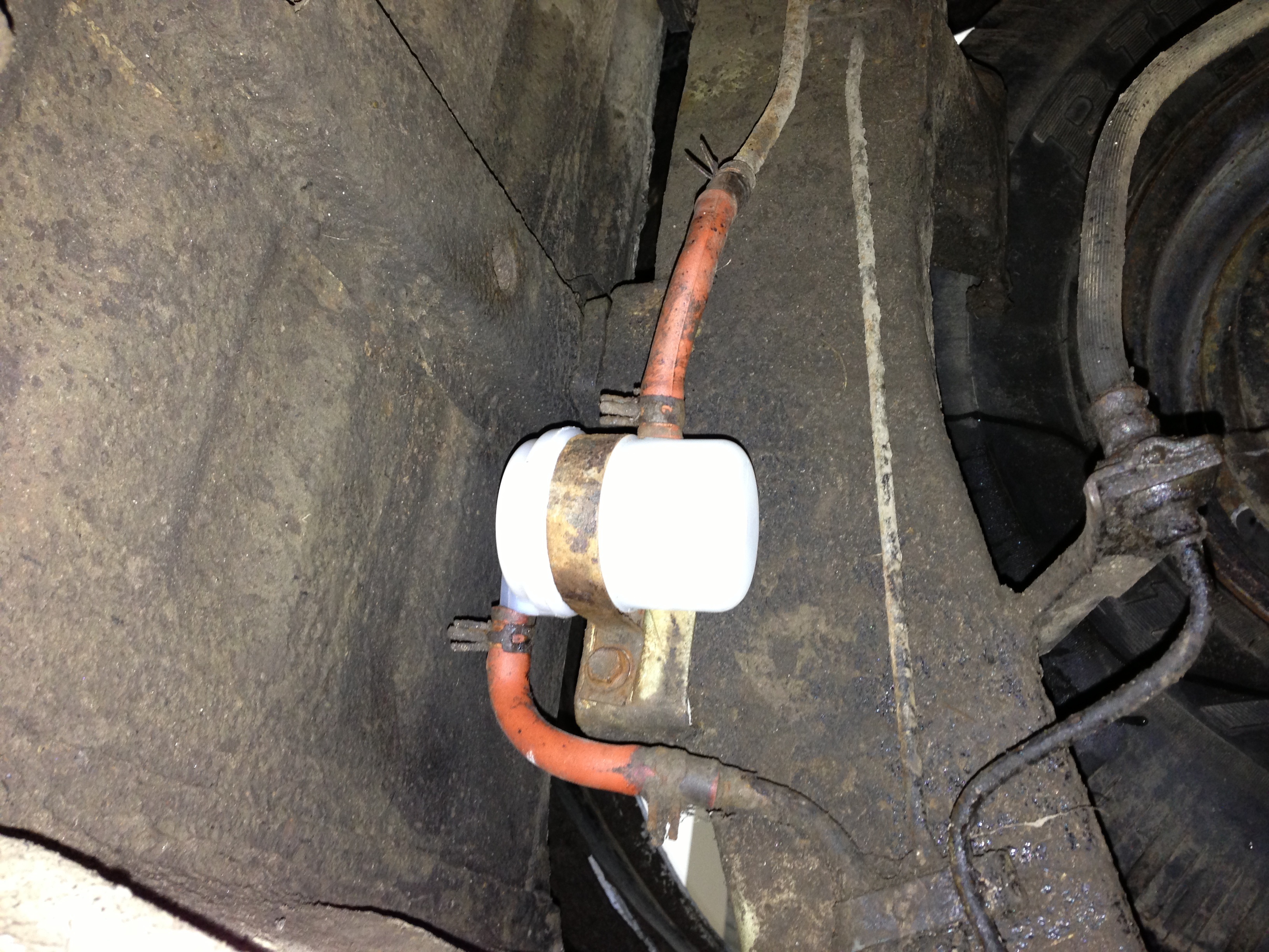

Fitted a new fuel filter
- image.jpg (2.16 MiB) Viewed 9824 times
