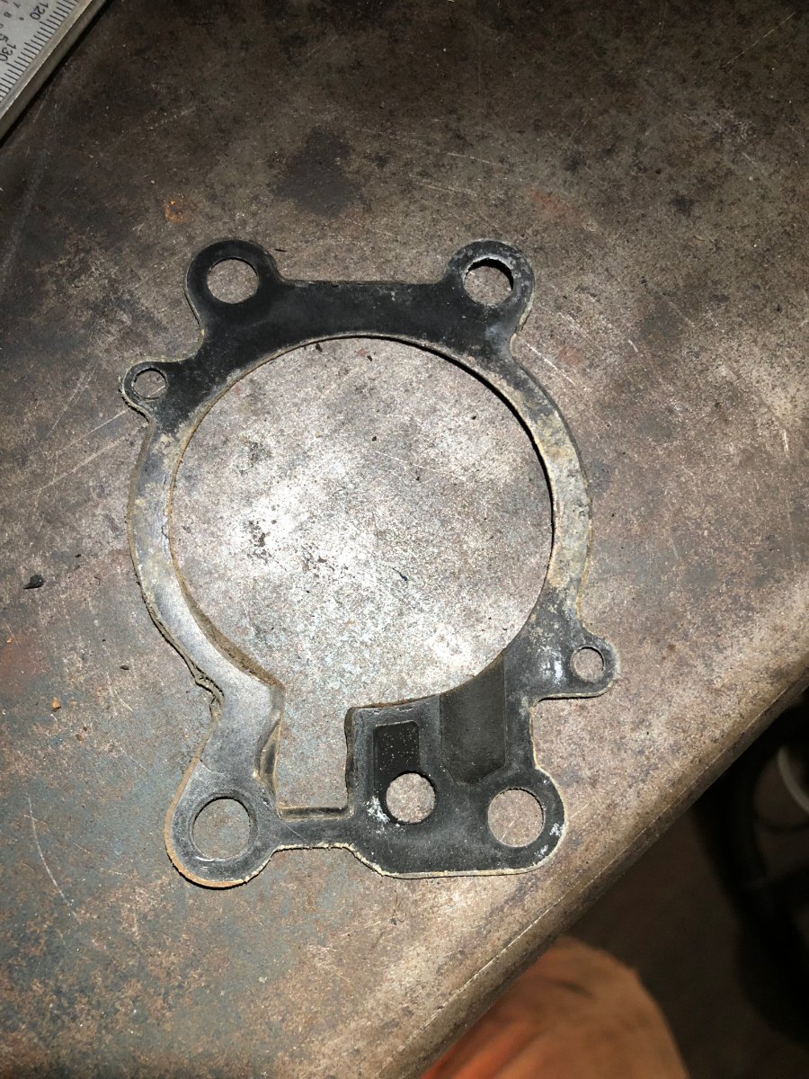

A bit of online sleuthing led me to some US sites selling the proper base gasket that goes between the manifold and the throttle body:
In the description it states those are rubberised metal. I've only got Flexoid gasket paper but I can't imagine it's under a huge amount of stress so we'll see.
The base gasket on the spare injection setup that Scott sold me was also a bit worse for wear, but in better nick than the one off the car. Someone went to the time and expense to put some RTV silicone on this one!

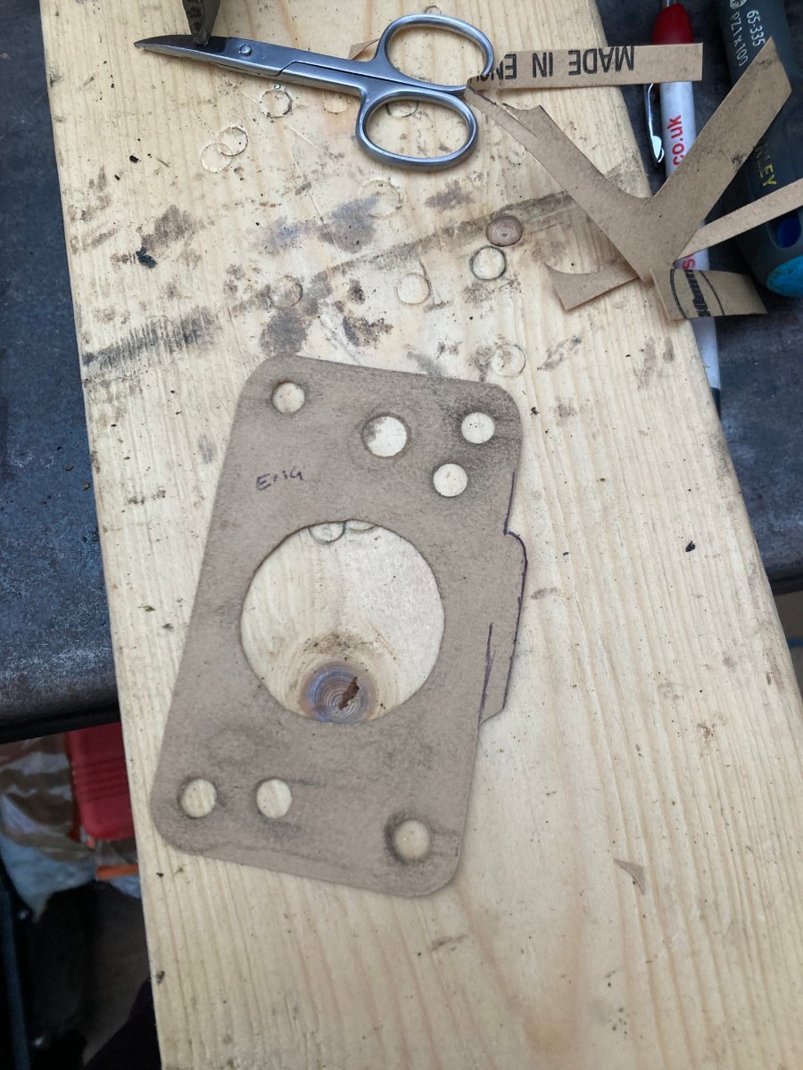

The mid gasket that goes between the injection block and the throttle body mercifully was in one piece in Scott's assembly so I was able to copy it in Flexoid.
Here's the base gasket all cut out. I left extra material between the sticky-out bits (technical term) on both in the hope of reducing the risk of a blowout.
That one got a thin coating of RTV on both sides before it went in the car.

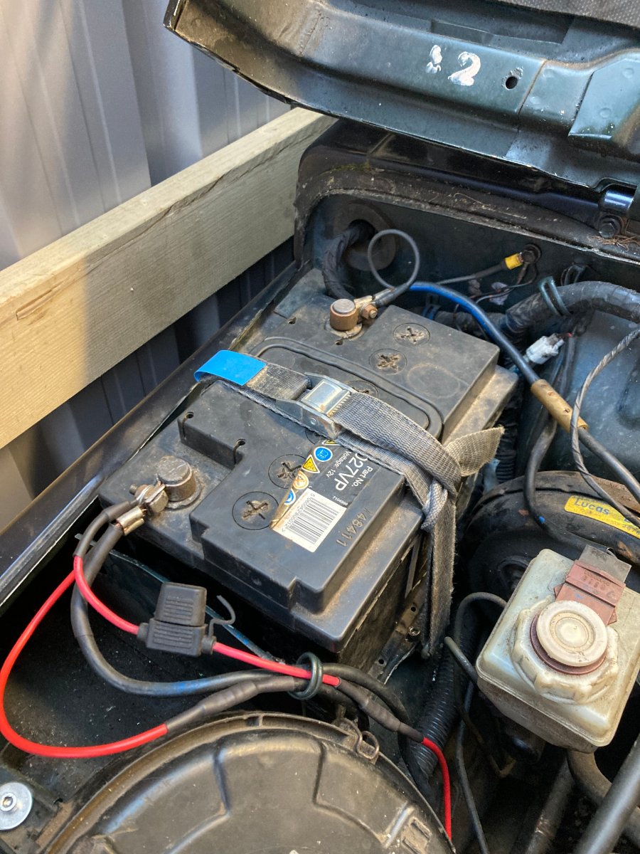

I also found a bit of time to repurpose a couple of hoops I found in the back into battery tie-down points, which should stop it jumping about and starting a fire.

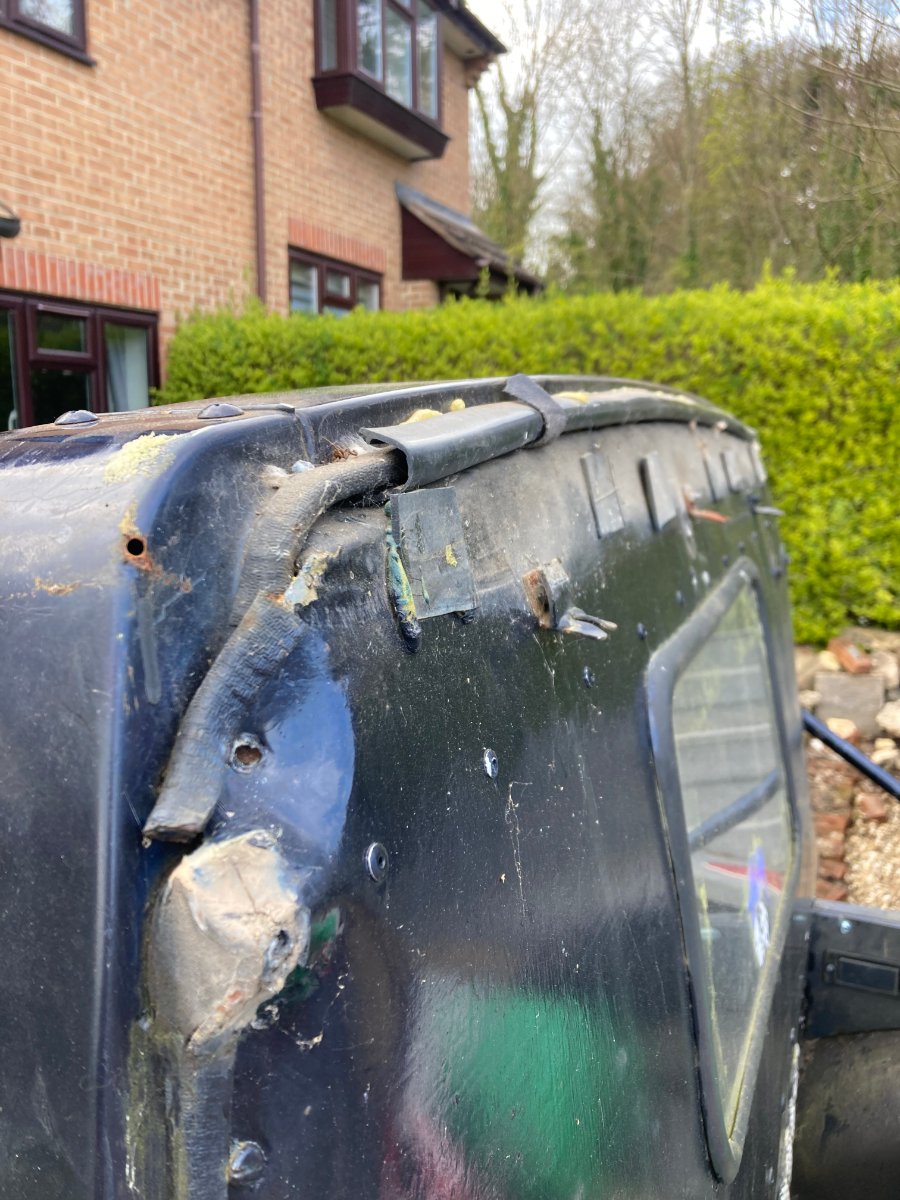

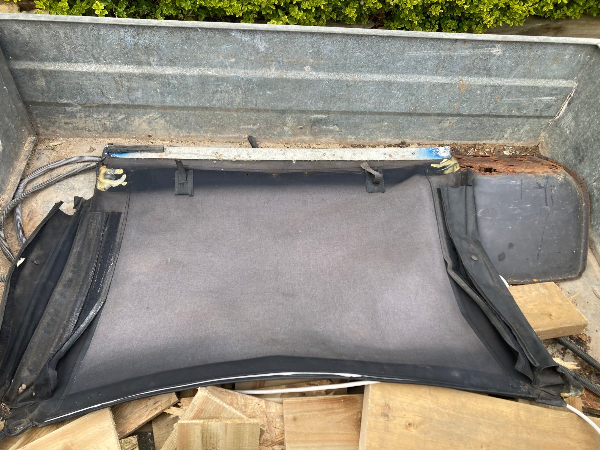

As I've now got somewhere dry to store the old girl I thought I'd spend today pulling the roof and that sorry excuse for a bulkhead off.
The roof was mostly held in with rusty self tappers and expanding foam, that hit the trailer bound for the tip pretty quickly.

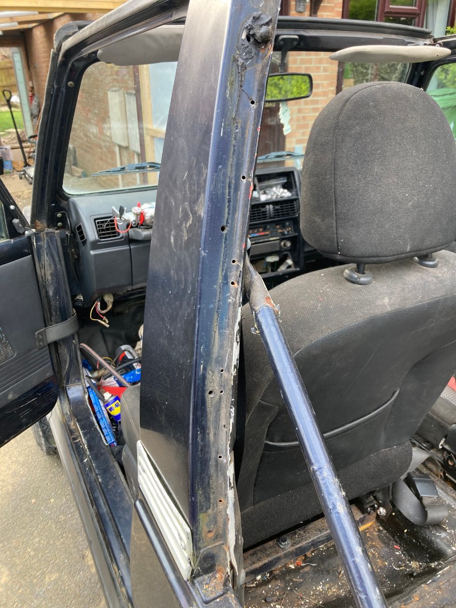

The bulkhead, if you can call it that, was held in with one million fasteners including, but not limited to, philips and slotted head screws, tek screws, bolts, pop rivets, bathroom sealant, clout nails and roofing flashband. Let's have a look at this beautiful creation.
Plus some structural wood at the bottom there, that's important for letting the rain in.
That came out with some cursing and judicious use of the impact gun, it was bolted through the floor with some huge bolts.
I've got to hand it to Ol' mate Dave, he knew how to prioritize quantity over quality when it comes to fasteners. I've got more holes to fill than the duty manager at a whorehouse by a dockyard :brows:

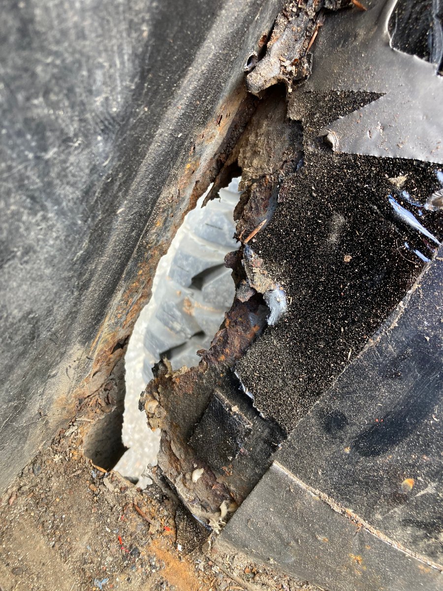

I decided to pull out the remains of the rear interior panels and vinyl carpet, to see what was lurking underneath. I kind of wish I hadn't started, Dave's been a busy boy.

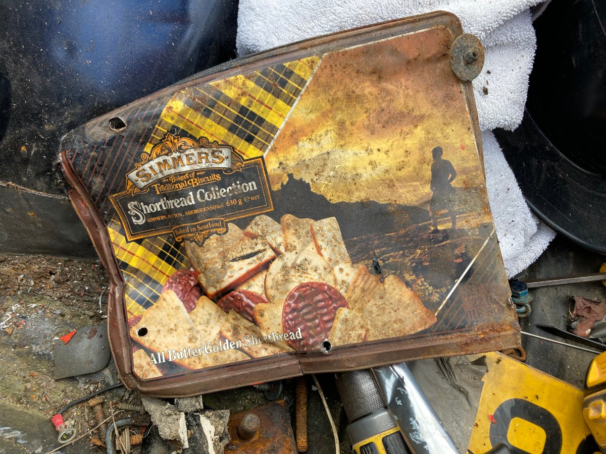

Like my dear mother always says, 'If you can't weld it, rivet a biscuit tin lid over the top of it and cover it in silicone" :roll:
And wouldn't you know it, there was a wheel lurking underneath!

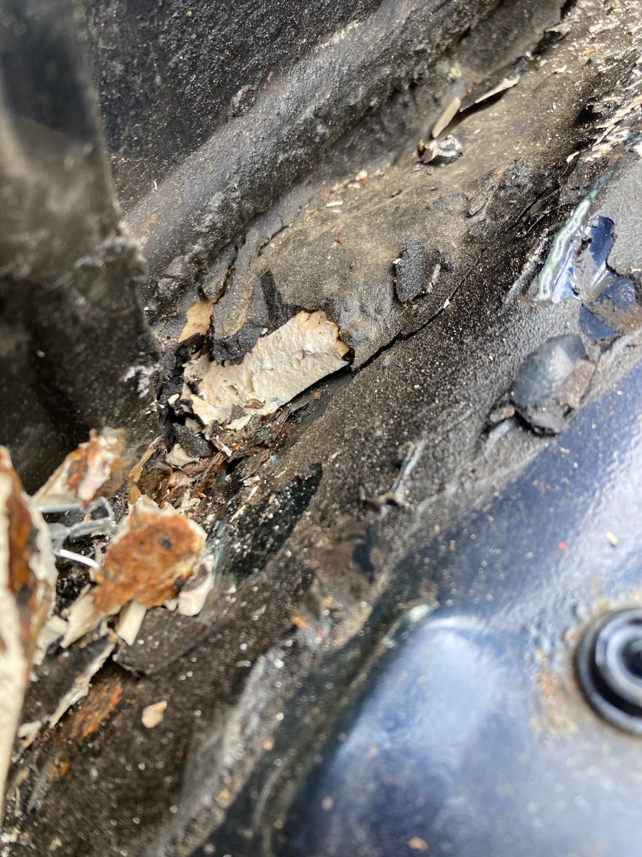

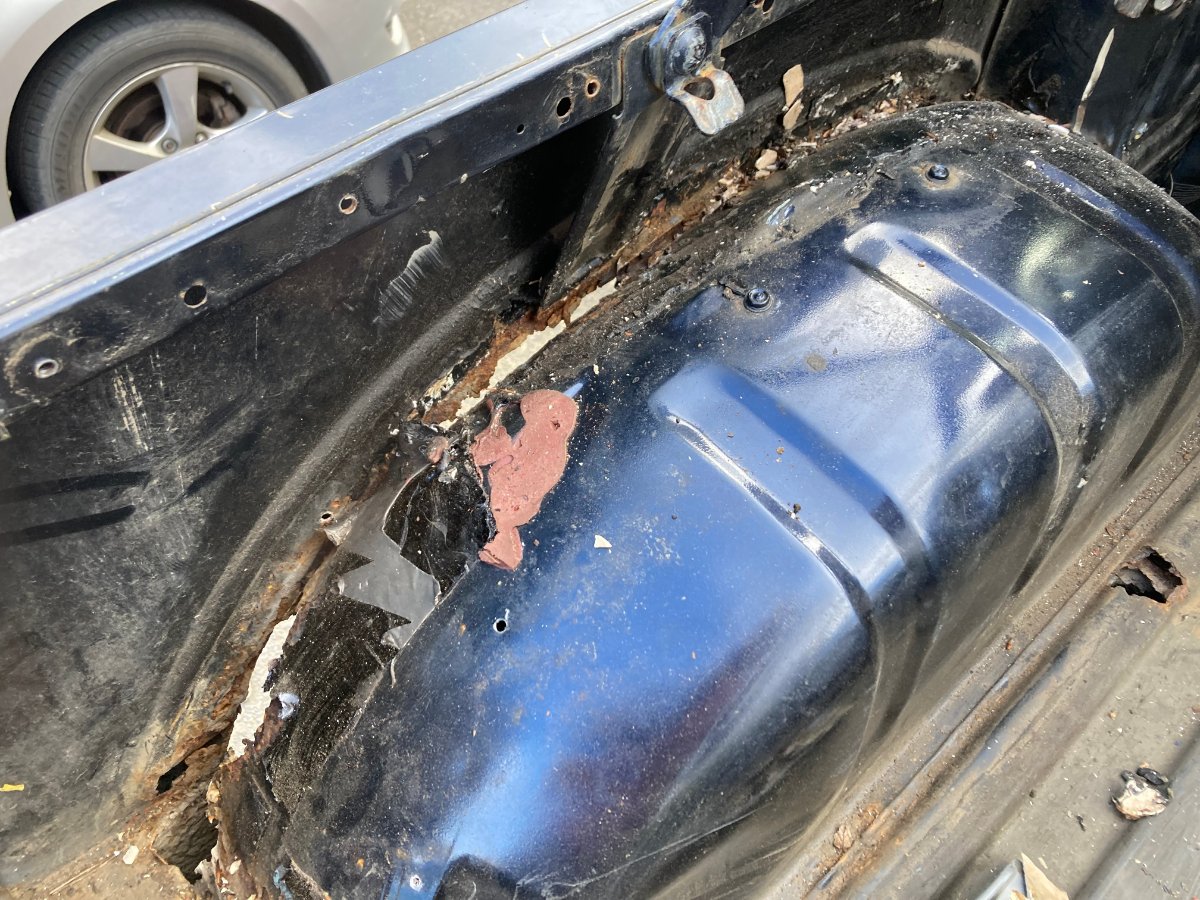

Both sides look more than a bit suspicious in the areas above the arches, I wonder what's under the black silicone?

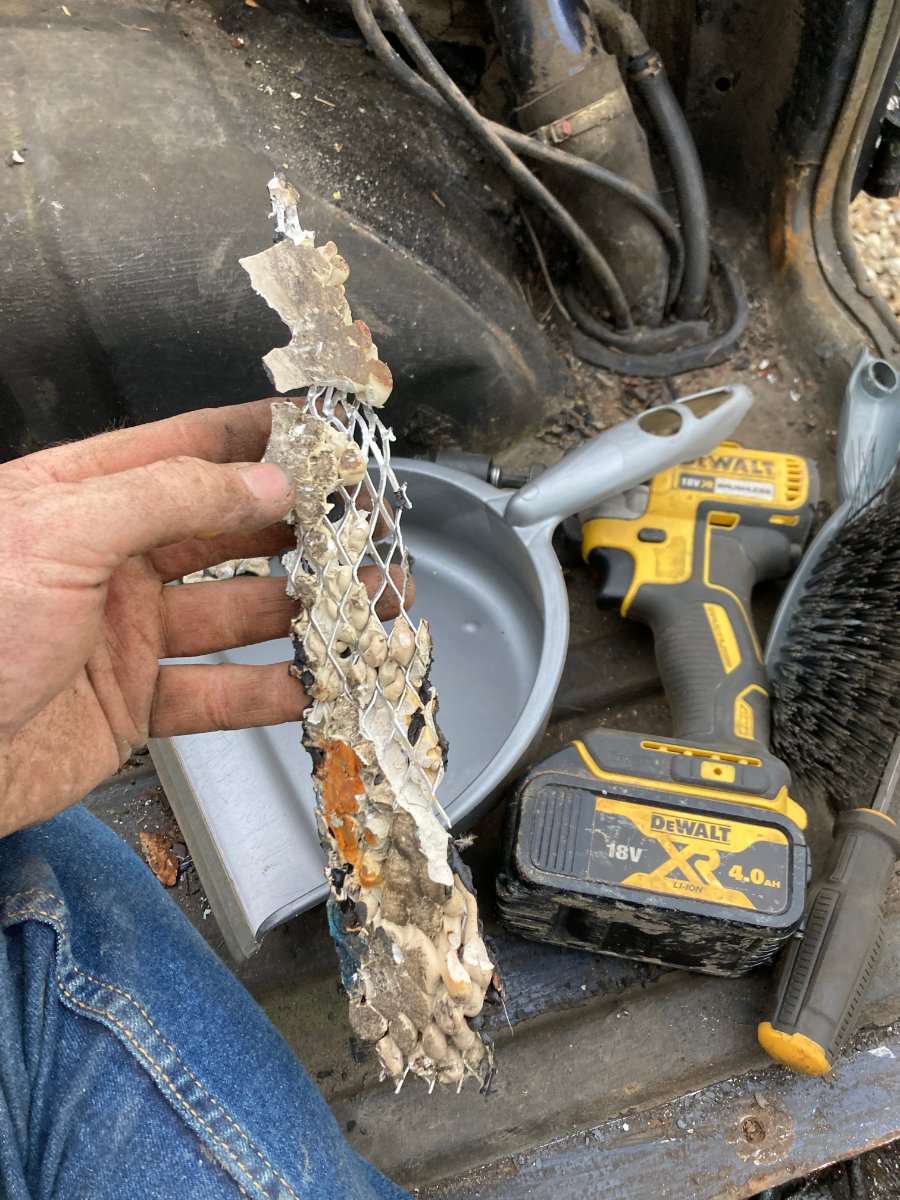

Body filler. The answer is body filler. And wire mesh, the sign of a true craftsman.
Lots of body filler. on both sides.
:tosser:

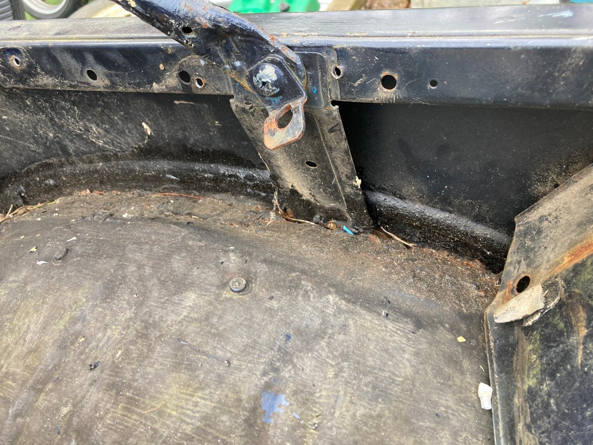

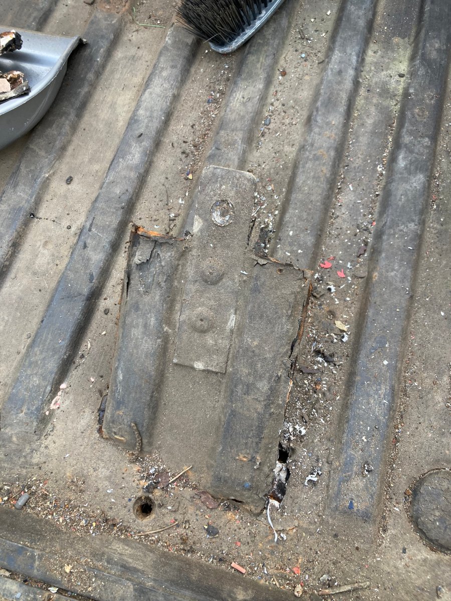

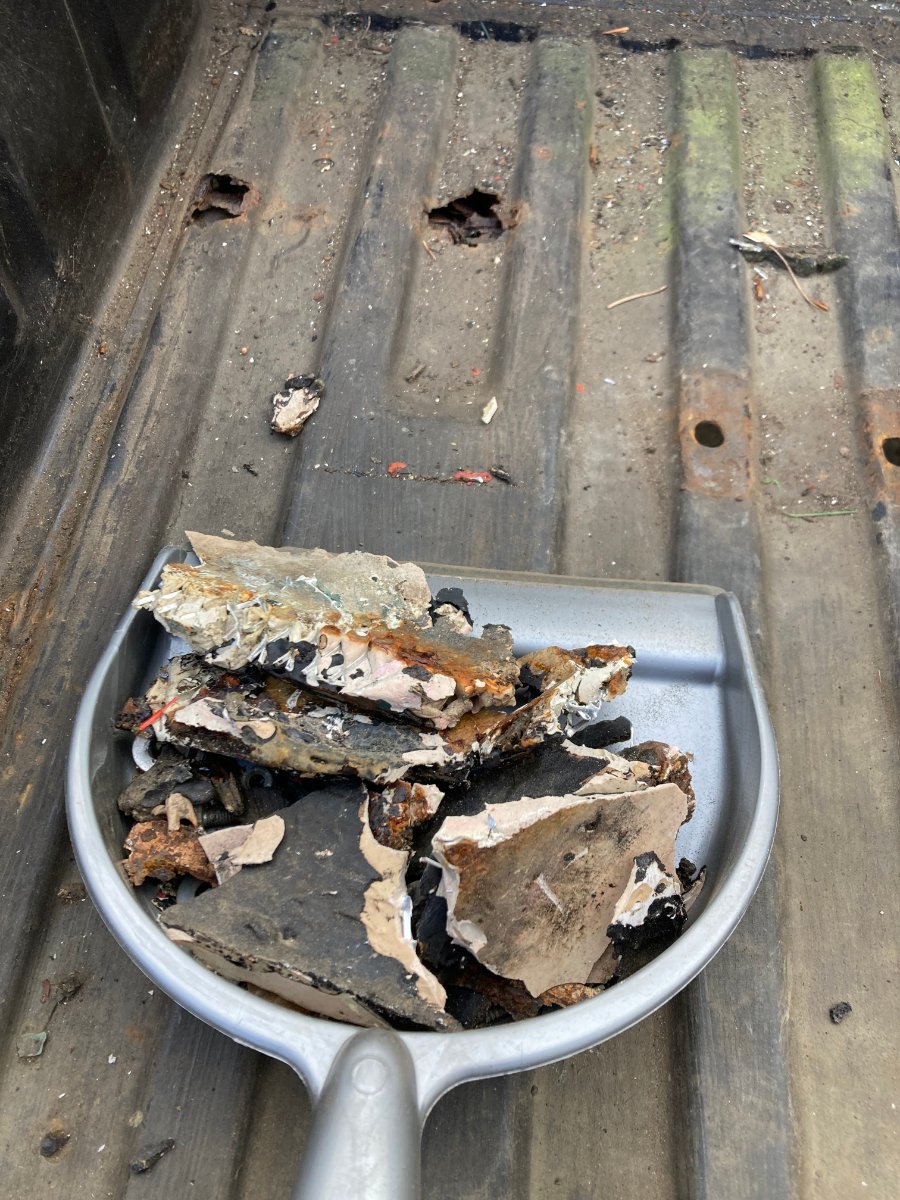

And plenty of soft spots that turn out to be holes in the load bed and the bit behind the seats.
There'll be plenty of welding to do, then :roll:
I shan't bore you further with pictures of rust, but the other side also had about two kilos of filler and wire mesh in it.

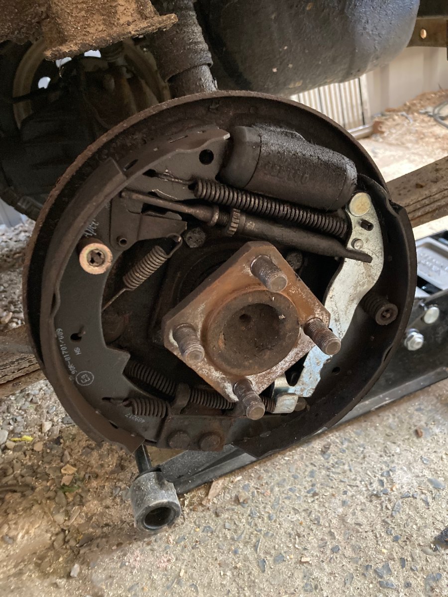

Decided to take a break from holes in the sheet metal and pulled the NSR wheel off to have a look at the brakes. I found that under the stupid plastic cap, the 4 bolts that hold the drum (and by extension the wheel) onto the halfshaft and wheel bearing were finger tight. The poor lass that was driving this thing daily wasn't too far from losing at least one wheel :S
On the bright side, not too bad, looks like new shoes. Plenty of brake dust and grime but I don't -think- the wheel cylinder is leaking.
On the other hand, the drum must have been dropped as part of the outer lip is missing. Worth replacing?
