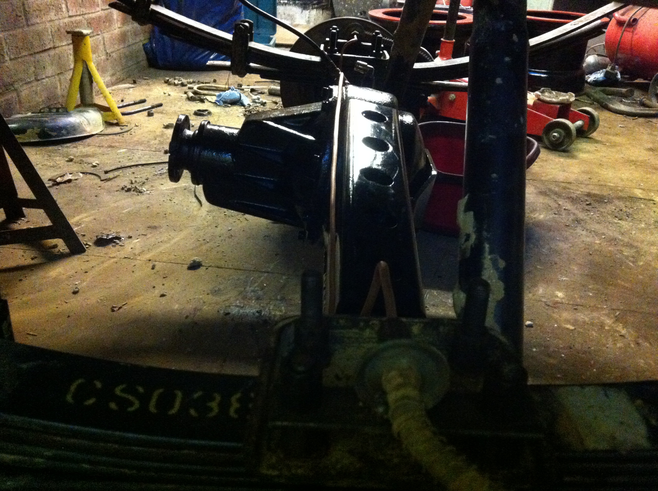

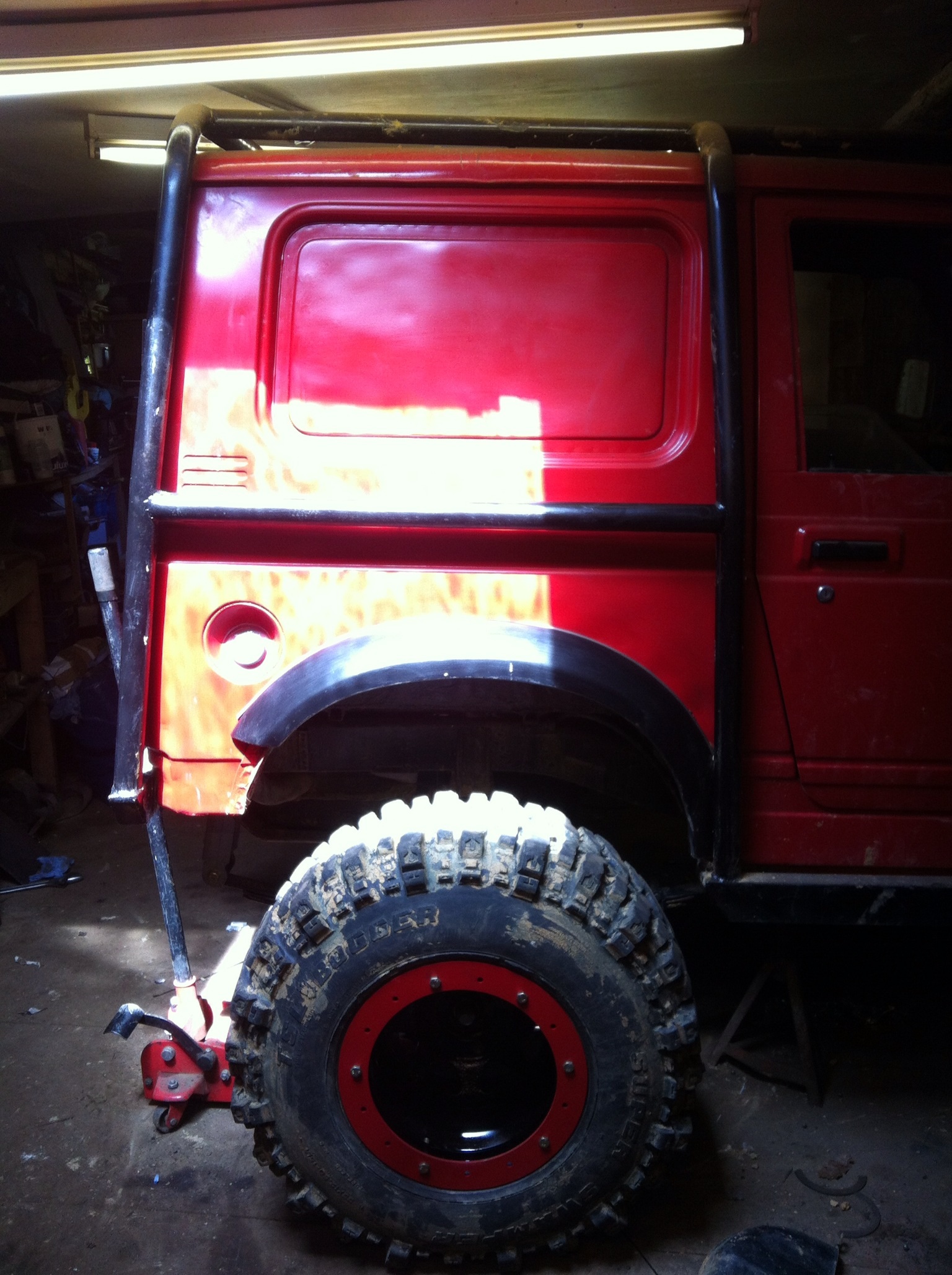

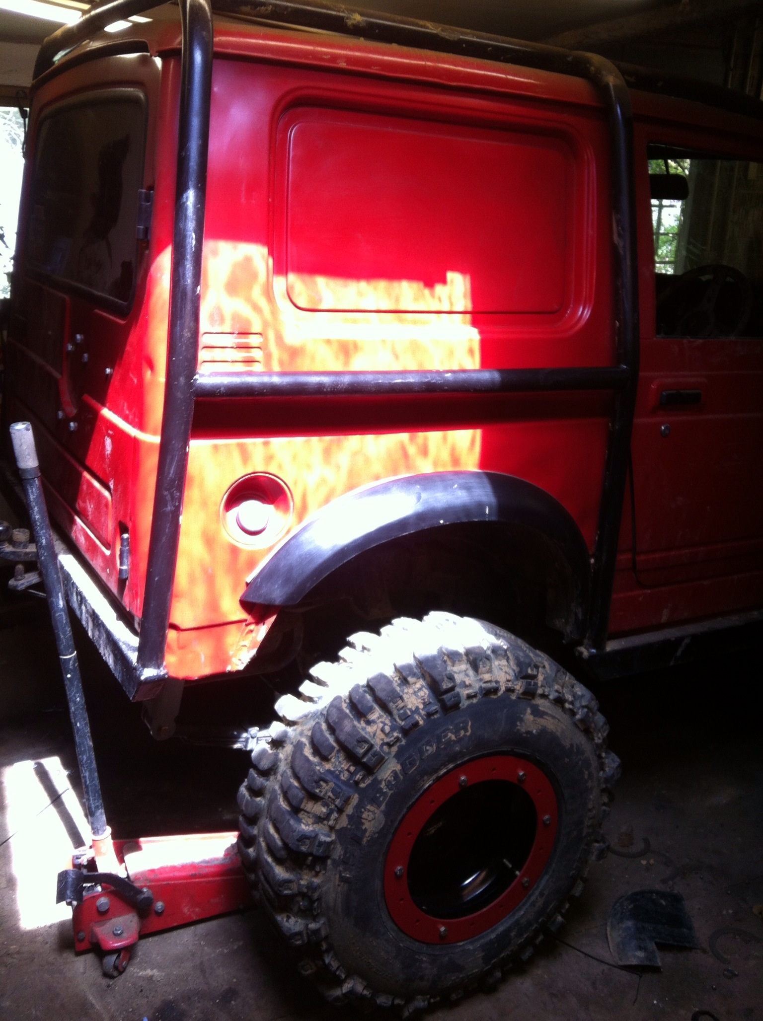

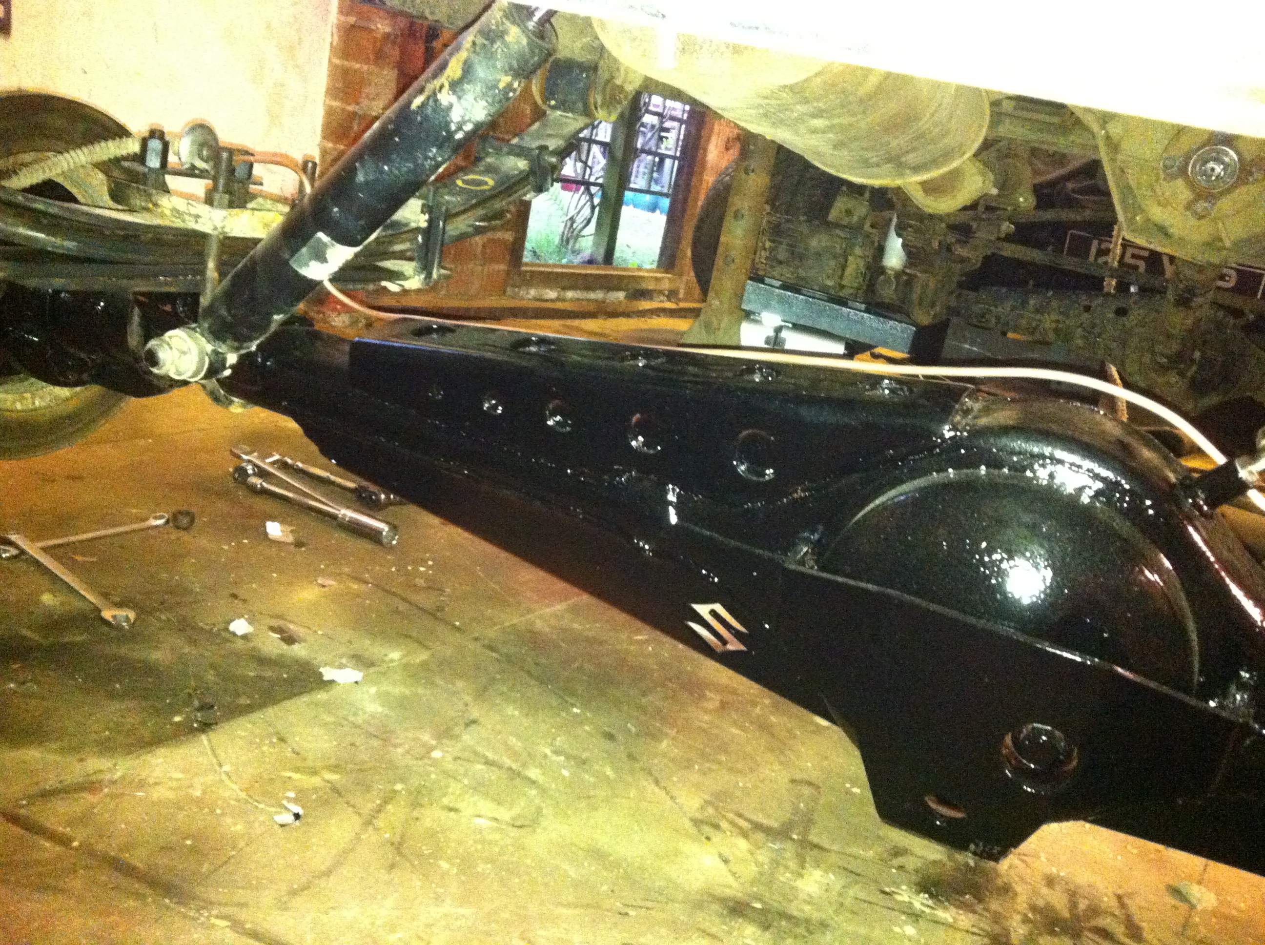

Axles in tried a wheel on to see what they look like
- image.jpg (731.97 KiB) Viewed 5523 times
- image.jpg (740.88 KiB) Viewed 5523 times
- image.jpg (711.02 KiB) Viewed 5523 times

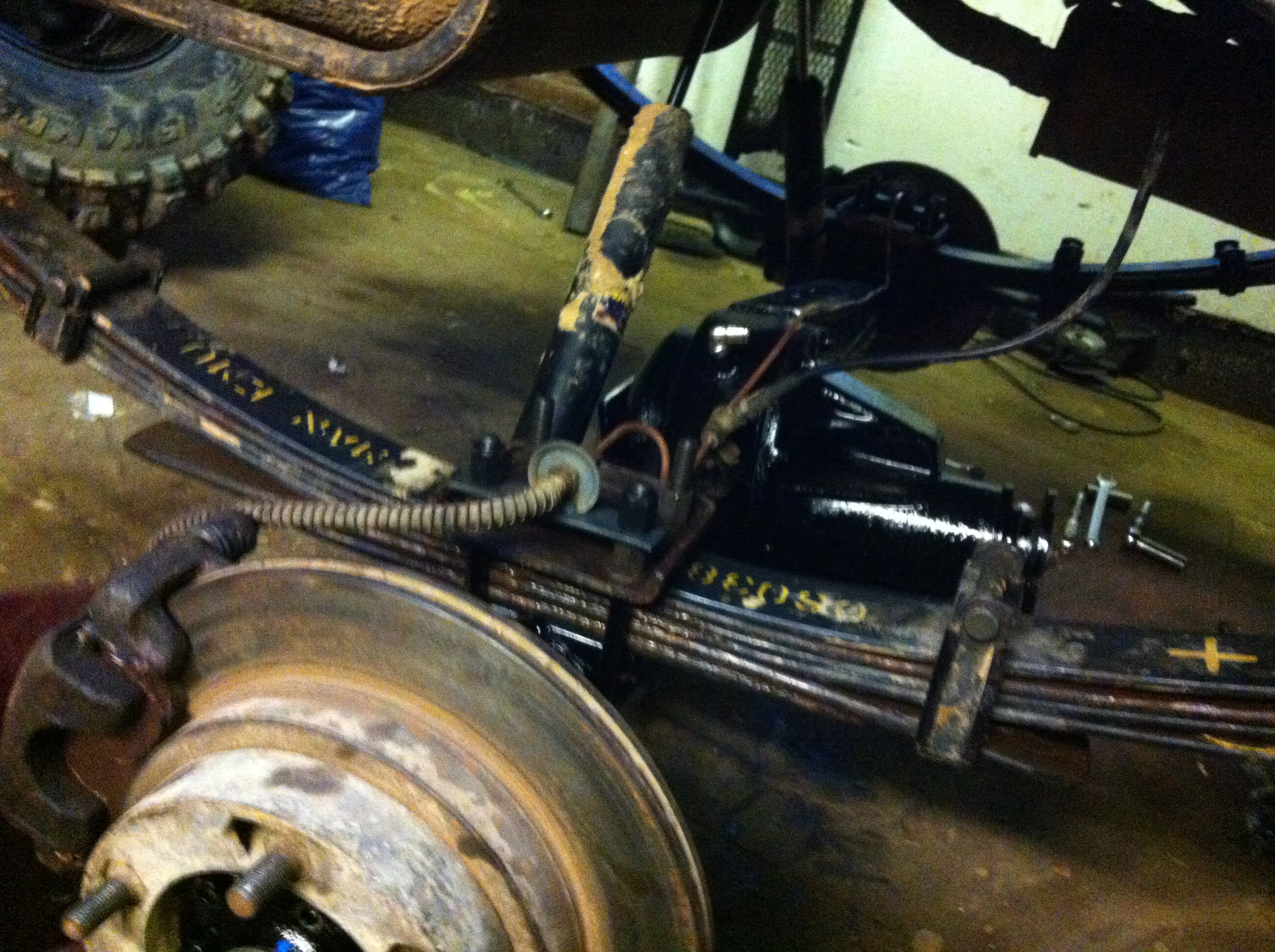

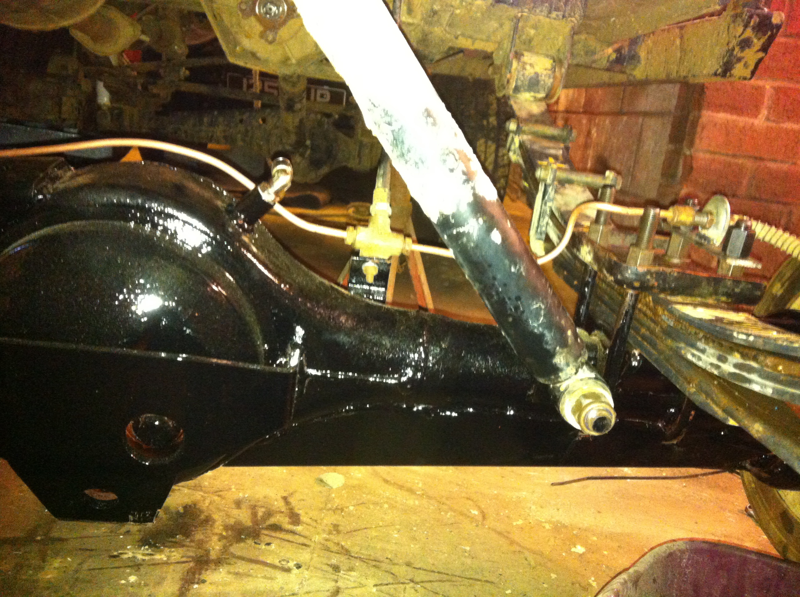

Axles all in, brake pipes mad, brakes bleed.
Prop will be done next week.
Now just to service it, oils, rebuild front axle ECT.
Then go play in it, then 8274 on the front, twin batteries, more cage work.
Then a comp
Then a comp

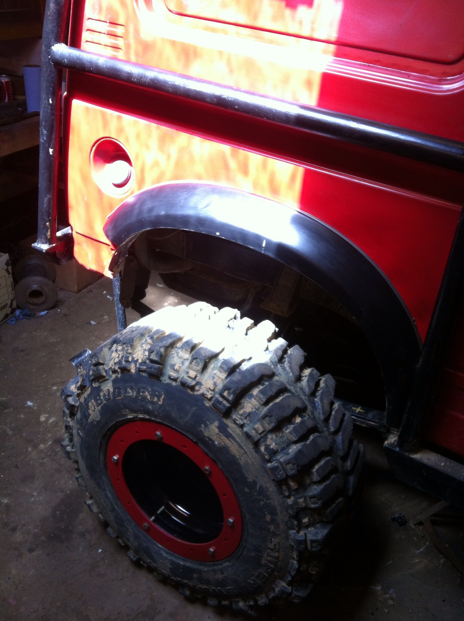

- dazerede
- Posts: 2141
Wow is it really that wide
That looks nuts mate
4” calmini lift kit
4” calmini lift kit
- mike harris
- SCUK is my life
- Posts: 1828
- Location: hascombe Surrey
They are wider from before, as the beadlock moves where the tyre sits. There about an inch wider, they used to bow in, now there bulging out !! Love them

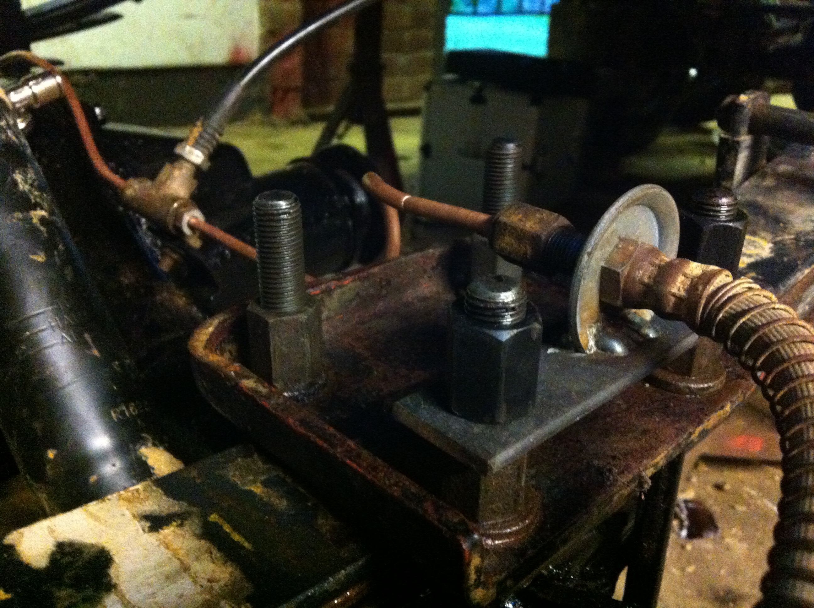

Just waiting for my phone to get some battery and il post up some more pics.
Forgot to put mounts for the brake lines on the axle casing, so had to improvise !!
