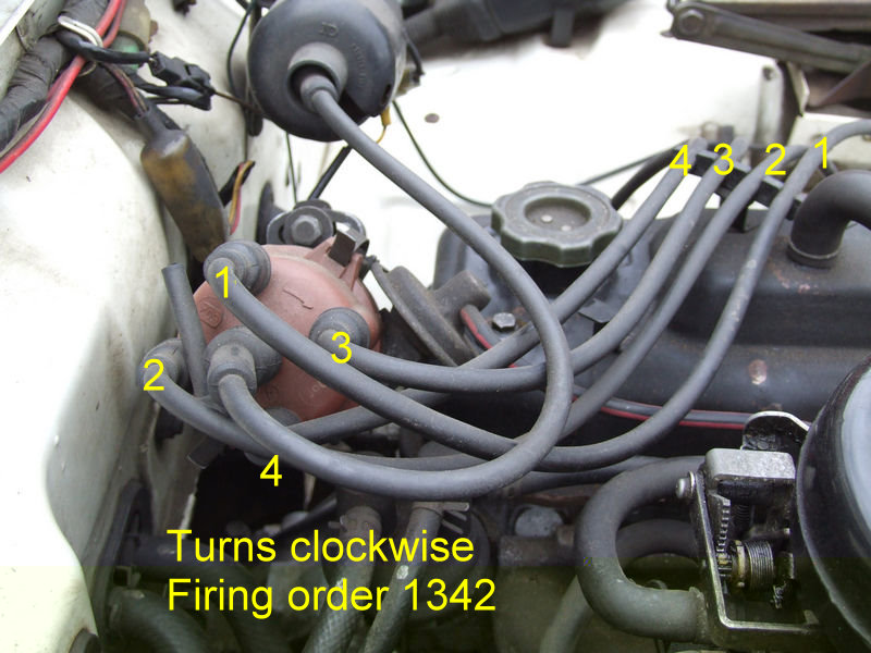

Ok and will i have to adjust the timing ?
Re: Problem is it diff or prop shaft
Post by Darrell » Sat Mar 24, 2012 8:22 pm
Not if you have not moved the distributor.
