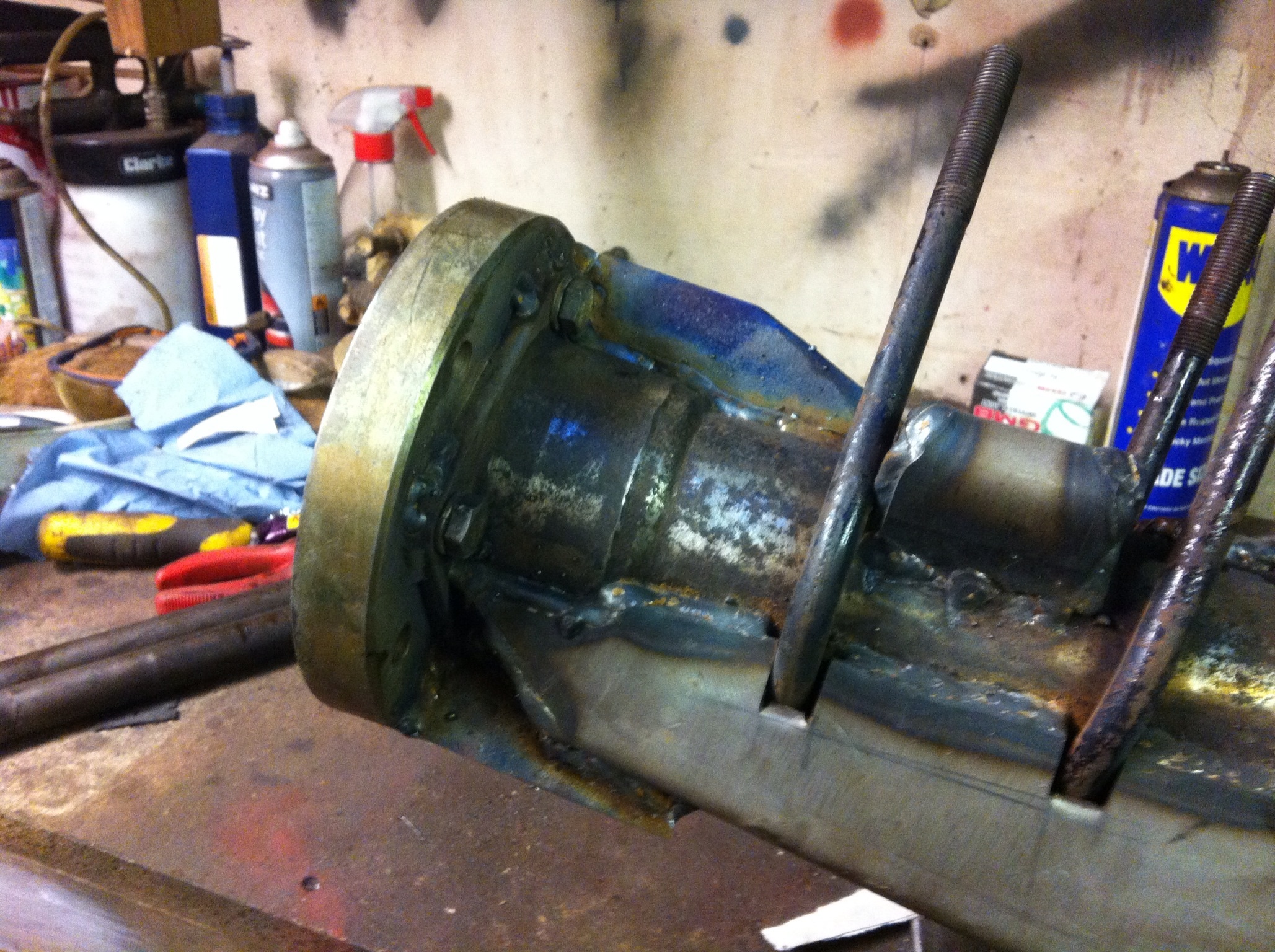

Bit more
- image.jpg (1.06 MiB) Viewed 4967 times

Where on route to getting somewhere now !!
Honestly if this axle bends il cry like a little girl !!
Just need to clean up some of the welds, paint the axle, bolt it all together.
Then prop, then winch, then service.
Bosh. Use it
Bosh. Use it

I'd like to do something similar to my rear axle, but I want to truss it top, front and back, and weld a pumpkin cap of some kind over the pumpkin (similar to yours, actually).
My plan is to tack weld the pieces in place, then weld between the tacks one by one - giving the thing time to cool down before going on to the next weld, so hopefully I won't bend the axle housing.
I have a 413 axle that I'm hoping to convert to full floater (so it's close to the width of my sammy front axle). Fingers crossed I can A) Find the money for the full floater kit (oooh, new shiny phone - blam, there goes the budget...)
And B) I don't bork the axle. Wouldn't be the end of the world if I did, the Sammy axle under the SJ would simply have to do - but you don't want to spend and do work only to find you've made a really big paperweight...
Anyhow, all the best mate - hope it doesn't go bananas like the last time!

This one has moved as I welded it, but I welded the opersite side to pull it back, you have to be so careful. Two inches max, quench then swop sides or ends. Stop every few mins as well.
