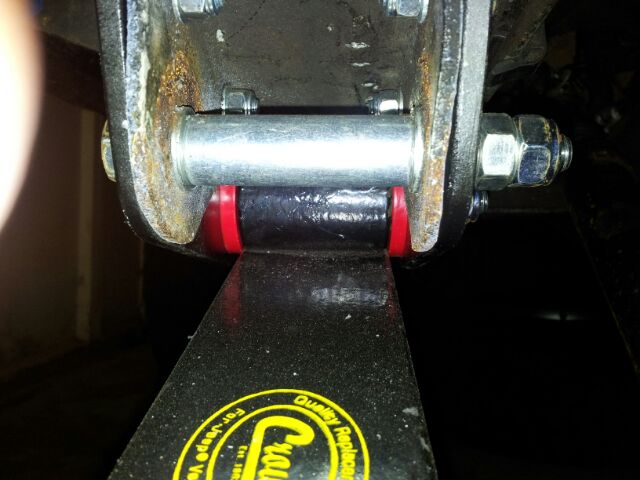

Nice work :thumbup: how much lower is the YJ mount than the SJ spring mount, its hard to tell from the picture but looks like the spring might catch the original spring mount during compression. My front relocation plates put the mount 20mm lower and 100mm back from the original and the spring slightly catches it at full bump sometimes.
Birdman this is one of the benefits, you don't need whacky shackles for good flex ;)
Re: 1991 Suzuki Samurai build
Posted: Mon Aug 05, 2013 10:58 am
by gp7186
ScottieJ wrote:Nice work :thumbup: how much lower is the YJ mount than the SJ spring mount, its hard to tell from the picture but looks like the spring might catch the original spring mount during compression. My front relocation plates put the mount 20mm lower and 100mm back from the original and the spring slightly catches it at full bump sometimes.

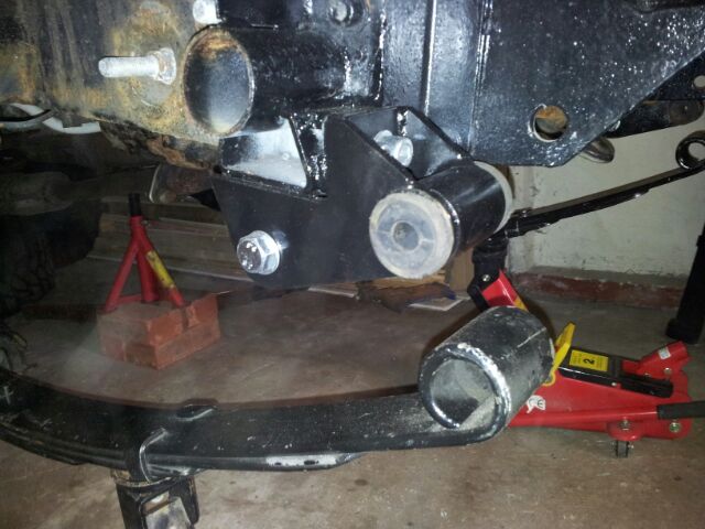

Thanks for the replies scottie I am 90mm pin centres but only 10mm lower but the springs are only 62mm wide and the original spring mount has a gap of 65mm so im hoping it will clear if not il trim off the bottom of the original mount a bit heres a pic from inside the mount to show the current clearance
Heres a pic with the front mounts painted and fitted with bushes

Looks a lot better from that angle :thumbup: Are yours original YJ springs? Mine are 64mm wide so that extra 2mm should help. Mine hasn't caused an issue as they hardly catch at all really just thought I'd mention it so you can look out for it when you flex it up for the first time :thumbup:

ScottieJ wrote:Looks a lot better from that angle :thumbup: Are yours original YJ springs? Mine are 64mm wide so that extra 2mm should help. Mine hasn't caused an issue as they hardly catch at all really just thought I'd mention it so you can look out for it when you flex it up for the first time :thumbup:
Thanks for the heads up il check It out. The springs are an aftermarket spring from crown automotive USA I got a friend import them for me

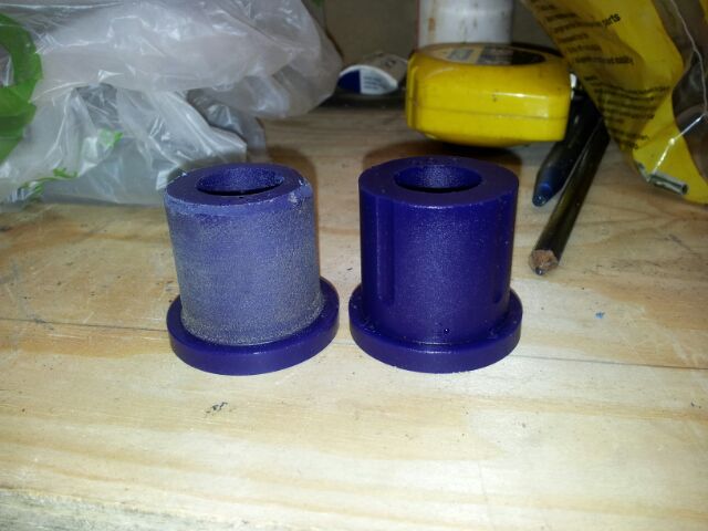

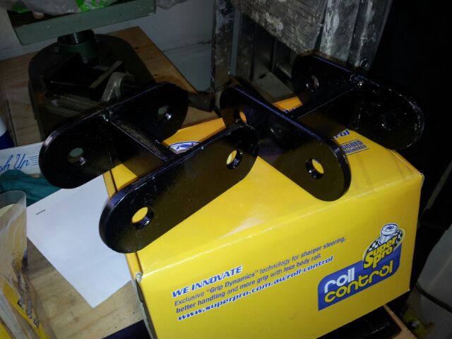

Bit more progress this week got my mate get me some super pro bushes, I have ended up with the full yj kit but the chassis bushes were to big on both ID anx OD so I had to machine them(which aint easy as they are so soft) and make sleeves for the bores

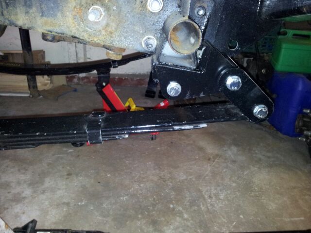

I them made a pair of shackles with 75mm pin centres

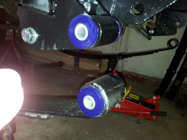

I then pressed in the bushes and sleeves

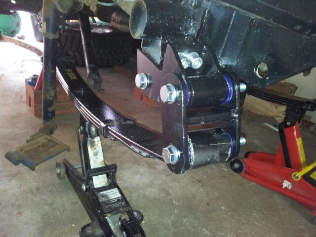

Then fitted the shackles
A quick test for flex with the jack and springs flattened out, they have so much flex very pleased at the moment
