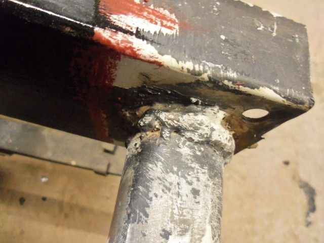

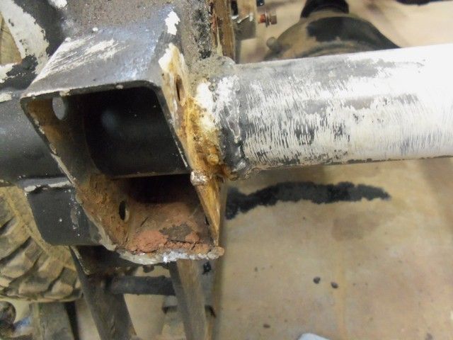

with the body off i tackled the front cross member/ tube. what had happend to the old one i have no idea. i thought of various ways to sort it. then a nice chap called Mr mike harris of this here website, who id visited a week or two before , was breaking a sami. so i bagged the bits i needed and a donor section of chasis.
the old tube has been cut and re welded in for some reason in the past or replaced. the arb mounts where missing and the tow eye was bent to fudgery.
towing eye had seen better days
ahhh haaa thats what i need.

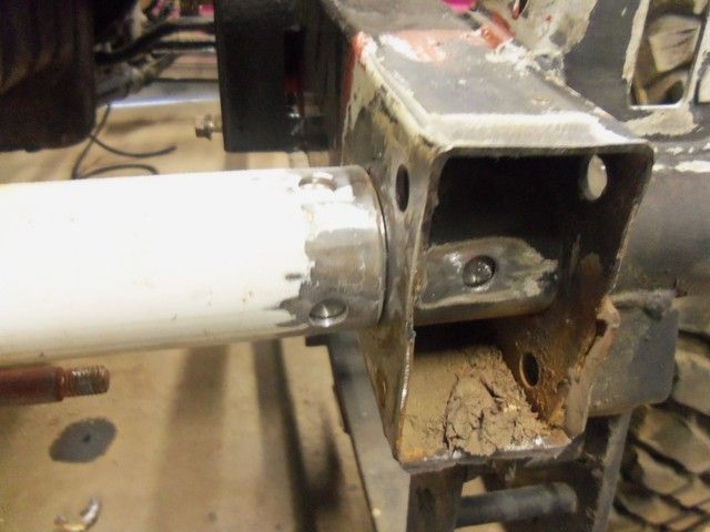

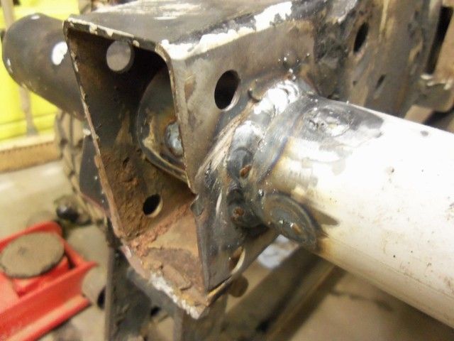

i tacked in some box sections to keep the legs in line but i had a feeling they wouldnt be in the right place anyway. they were in by approx 11-12 mm. the old tube was then cut out and after some measureing , tweeking and lining up the new tube was placed in.
^^^ in the picture you can see some holes i drilled to plug weld onto the slug inside the tube.the slugs where made from the old tube after i cleaned it up, sliced down the tube and removed a slither from it. reformed and welded it back together into a smaller tube with a nice snug fit OD to tap into the cross member. this was to help line everything up and give a little extra strength.the slugs also helped to line the bumper mounts that went on as ill be running a stock front bumper.
welded
bumper mounts where next to be lopped off the doner section, these needed a bit of straightening and then they where buzzed on too. finished off with a lick of red oxide. all in all im please with the results.
