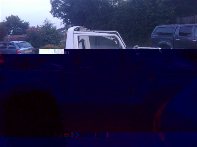

For the time being she is sitting on the drive way, stripped the insides out so I can give it a good wash and a lick of paint

Believe it or not, these pictures of a car with an MOT lol. Painting the inside tomorrow

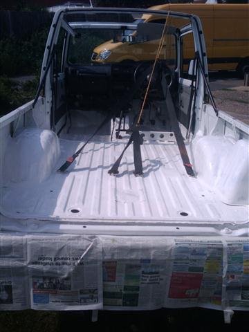

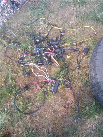

Spent today painting the inside with white hammerite. Now working on the wiring.
The amount of stuff I have taken out is amazing. Everything still works, apart from the hazard warning light but do you need that as an MOT requirement?
Amazed at how a previous owner has bodged so much!
