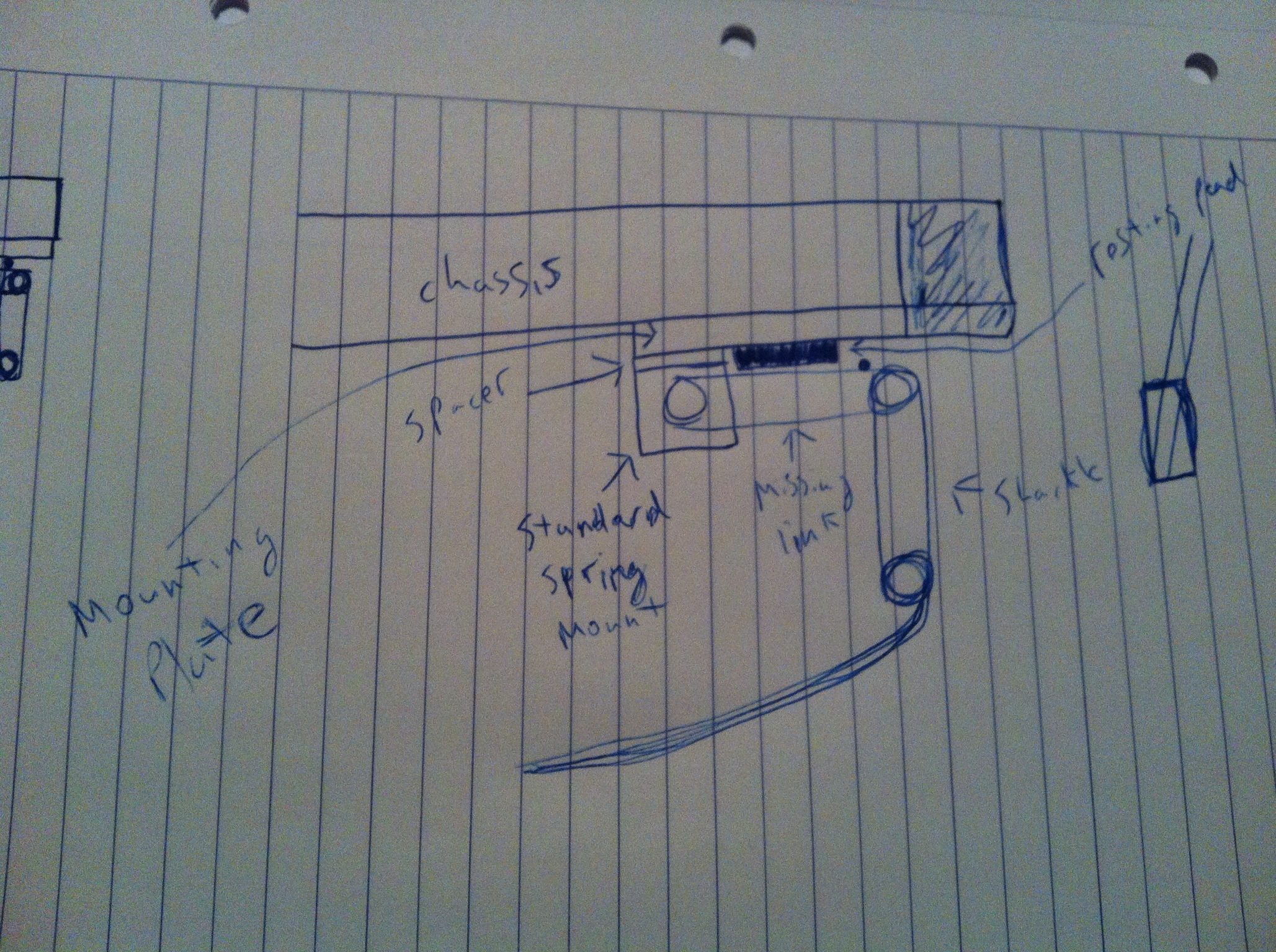

New old man emu springs turned up today, fed il of waiting for the missing link kit to turn up, so I am going to buy the links separate and just make it.
I have bought some 6mm thick steel to make the mounting plate from so I should be able to make it strong enough.
Just need to find some way of fitting massively long shocks to the rear. May need to cut the rear floor which I am not keen on :(

Here are my very rough plans.
Something like this
Something like this
- image.jpg (1.27 MiB) Viewed 5371 times
