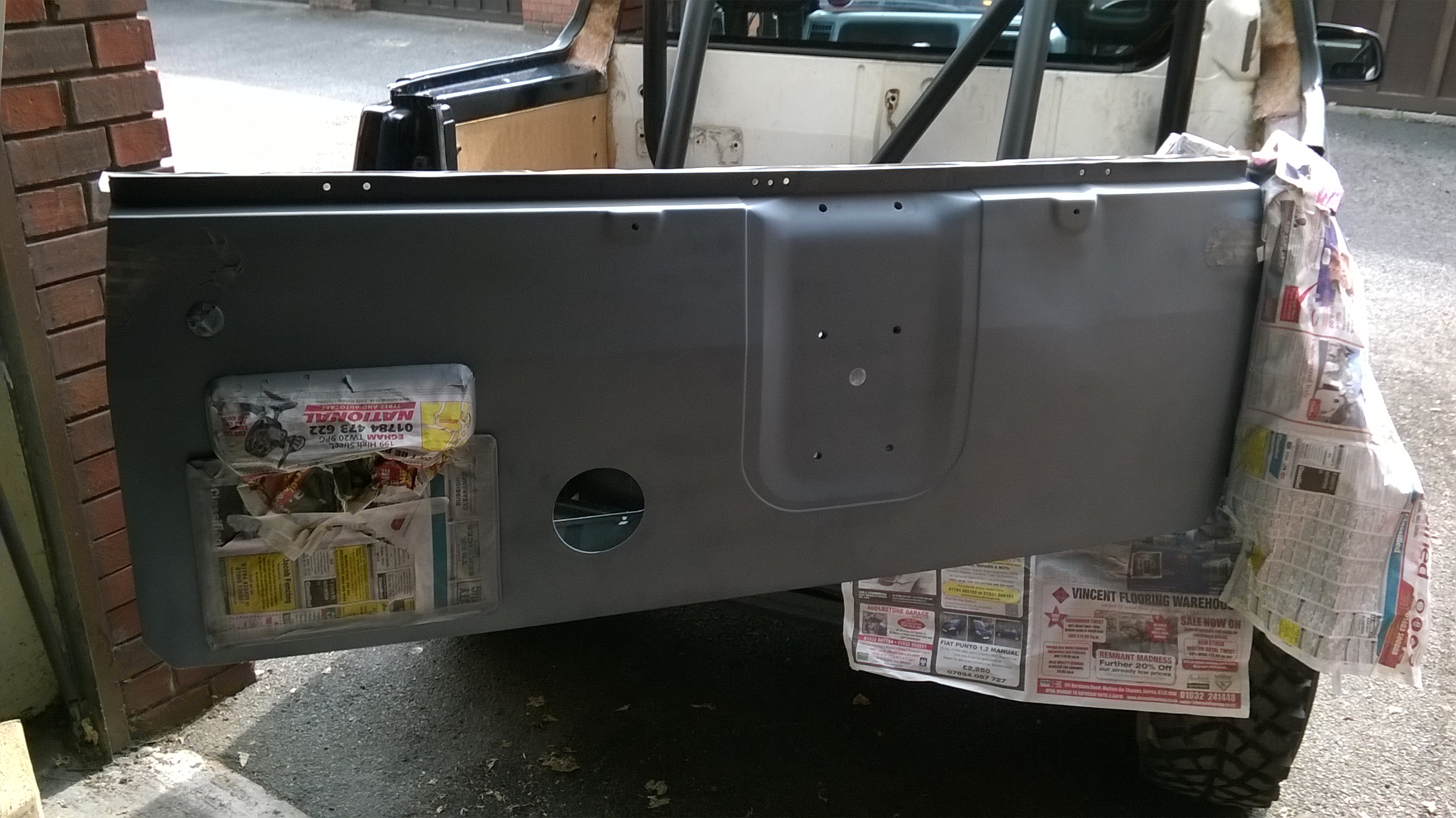

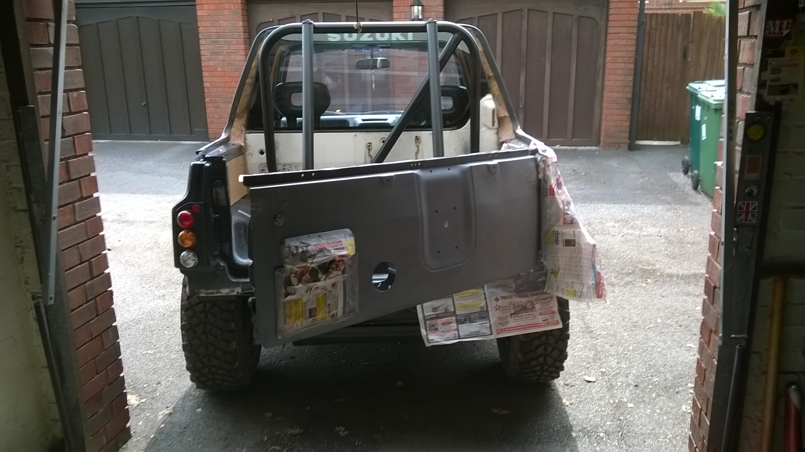

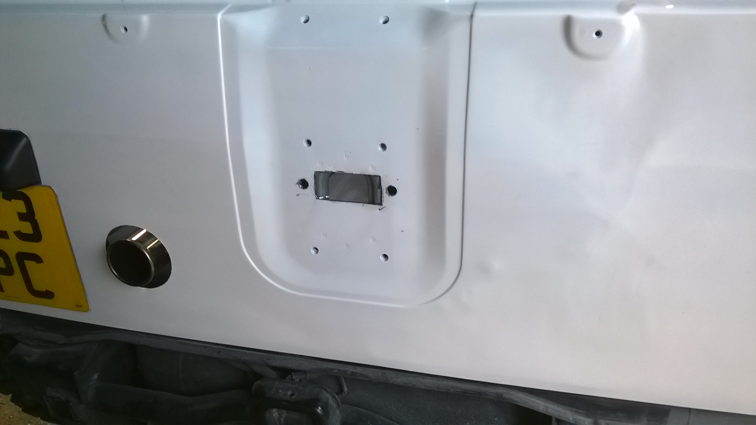

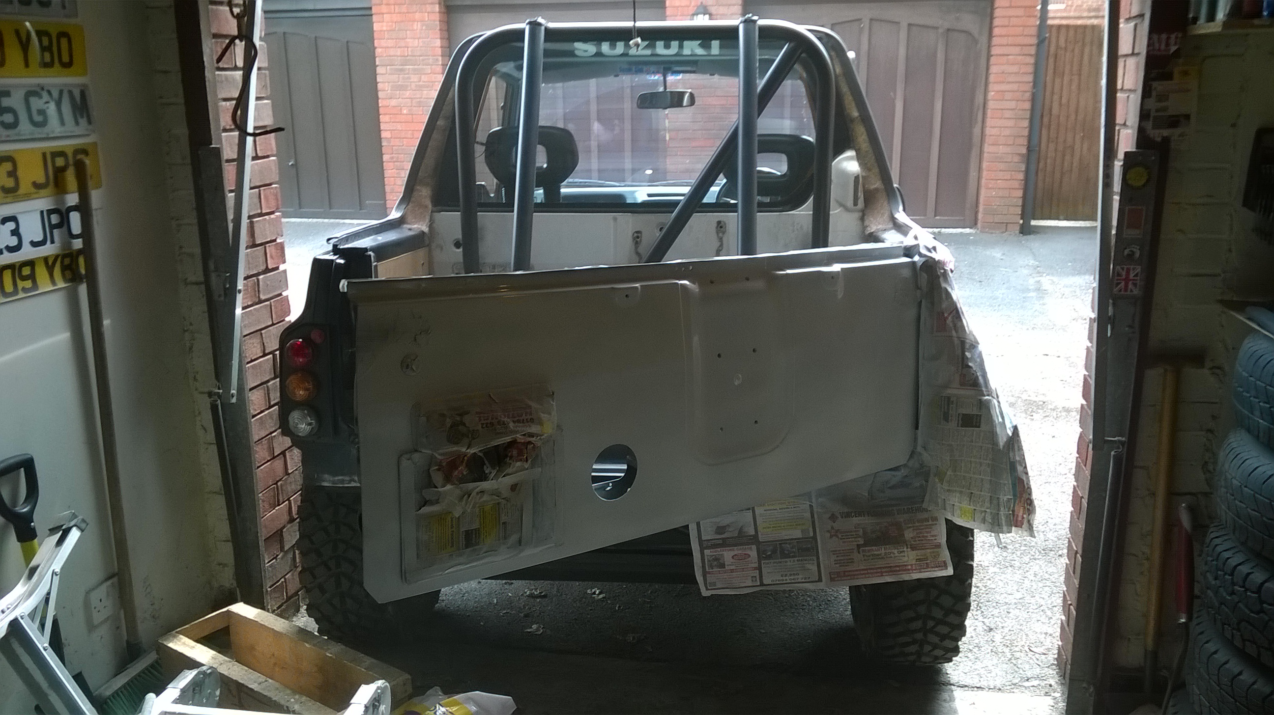

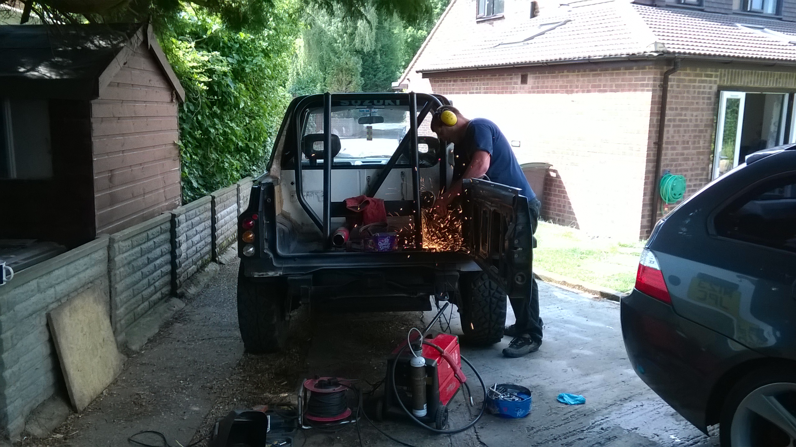

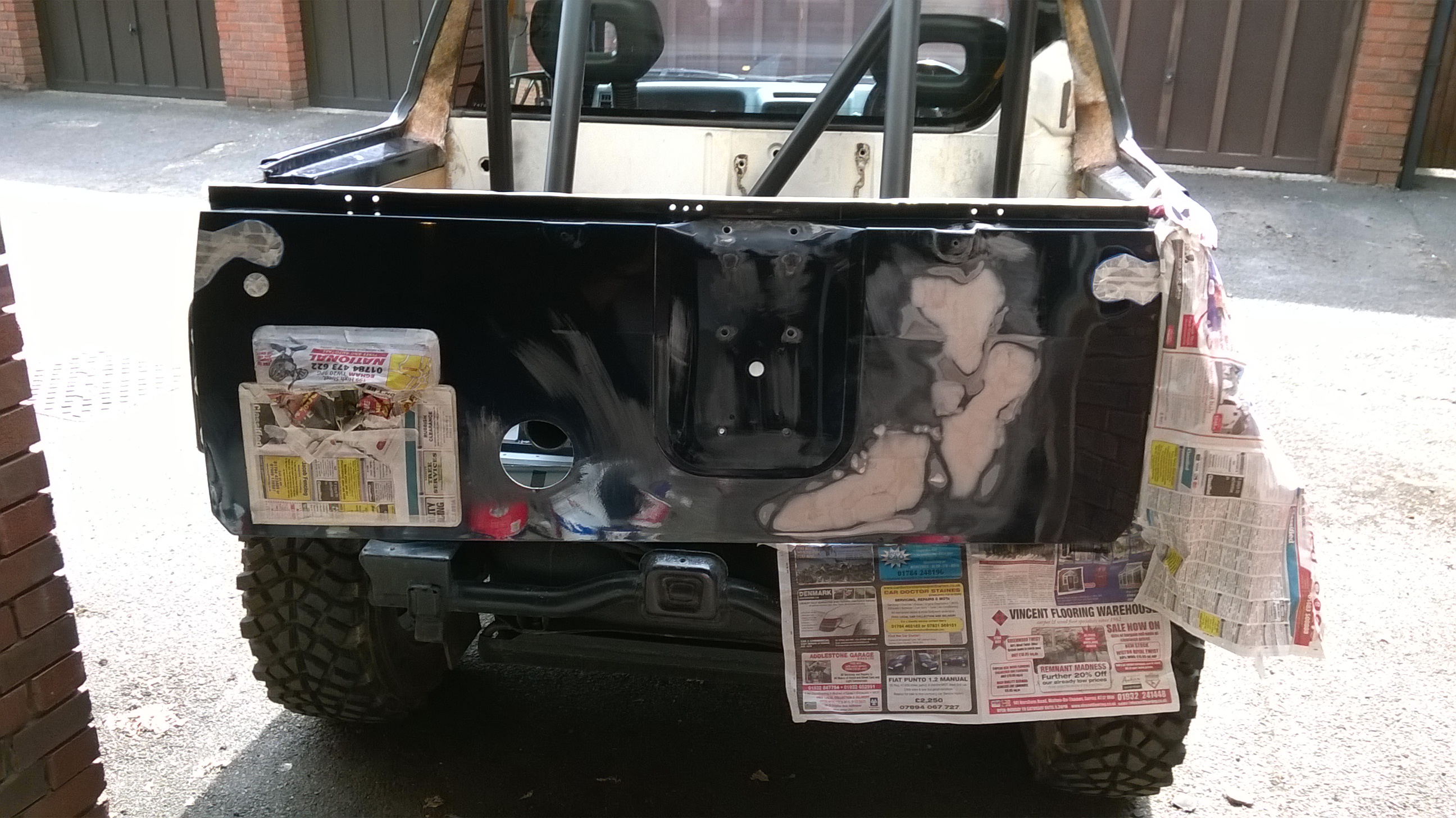

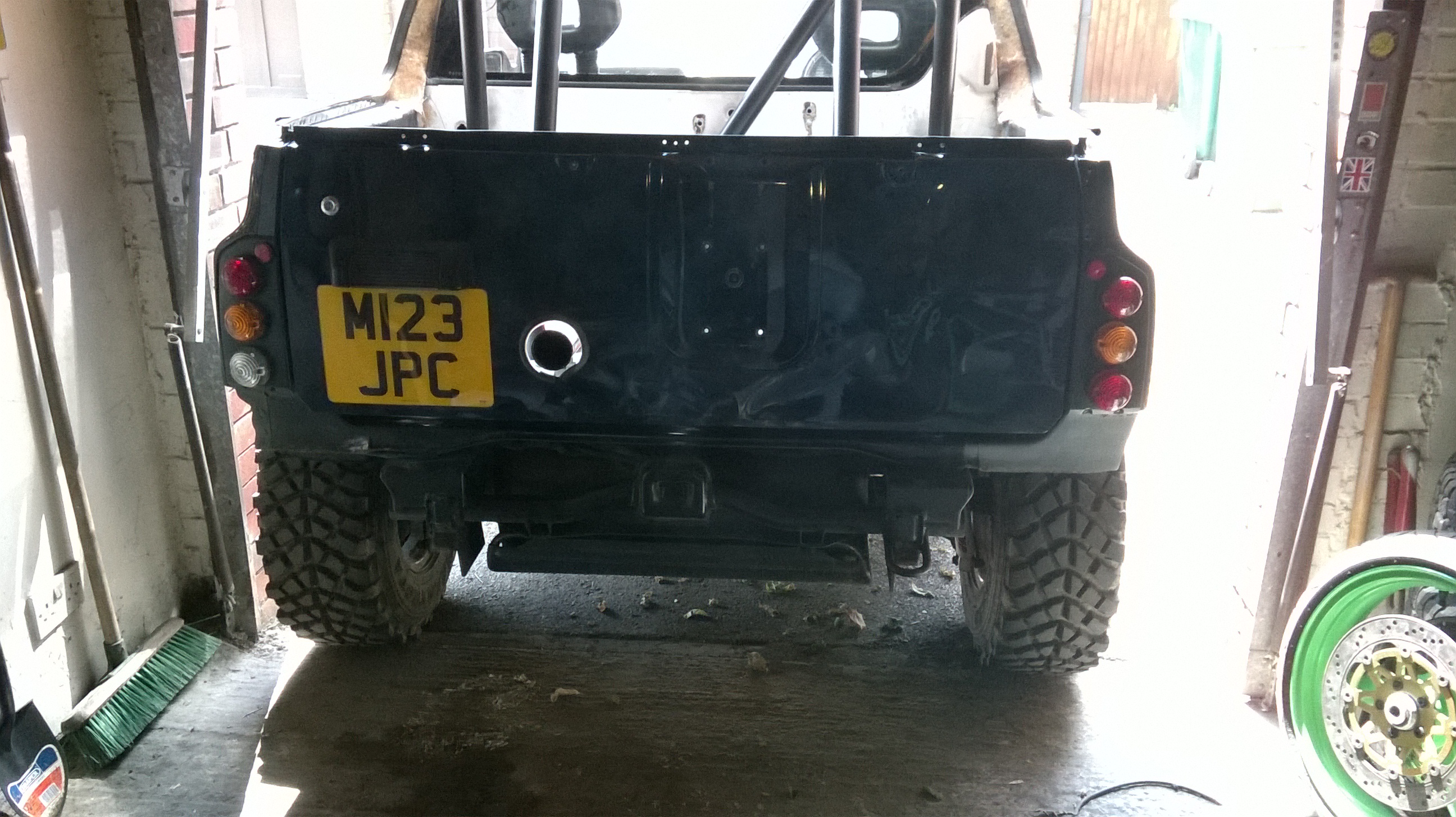

Made a start on the paintwork...it IS going to be camo, but with a couple of twists to it. And instead of purple I will use the existing dark blue colour instead.
Had a rash of dents on the tailgate but I'm quite pleased with the results...

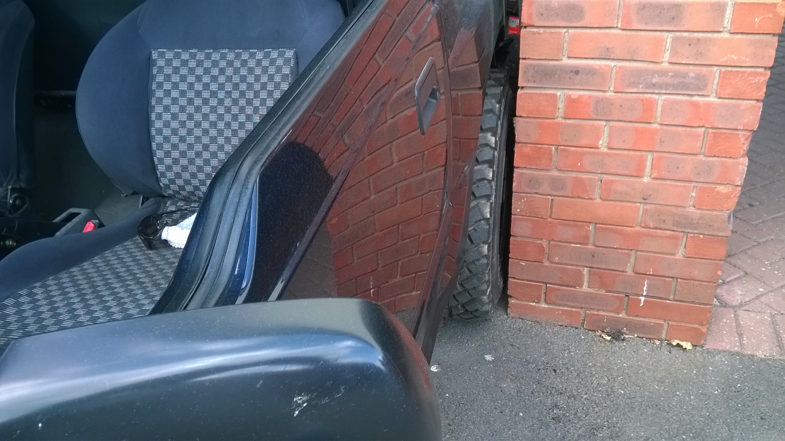

Did have a narrow squeak when I backed her in the garage...with the fatter tyres!

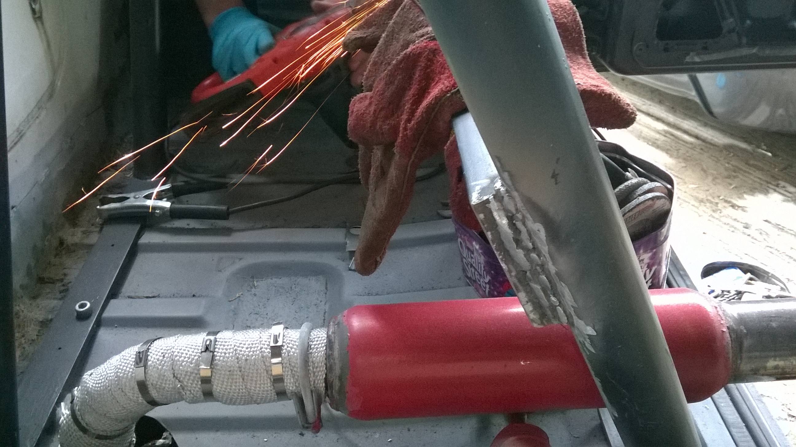

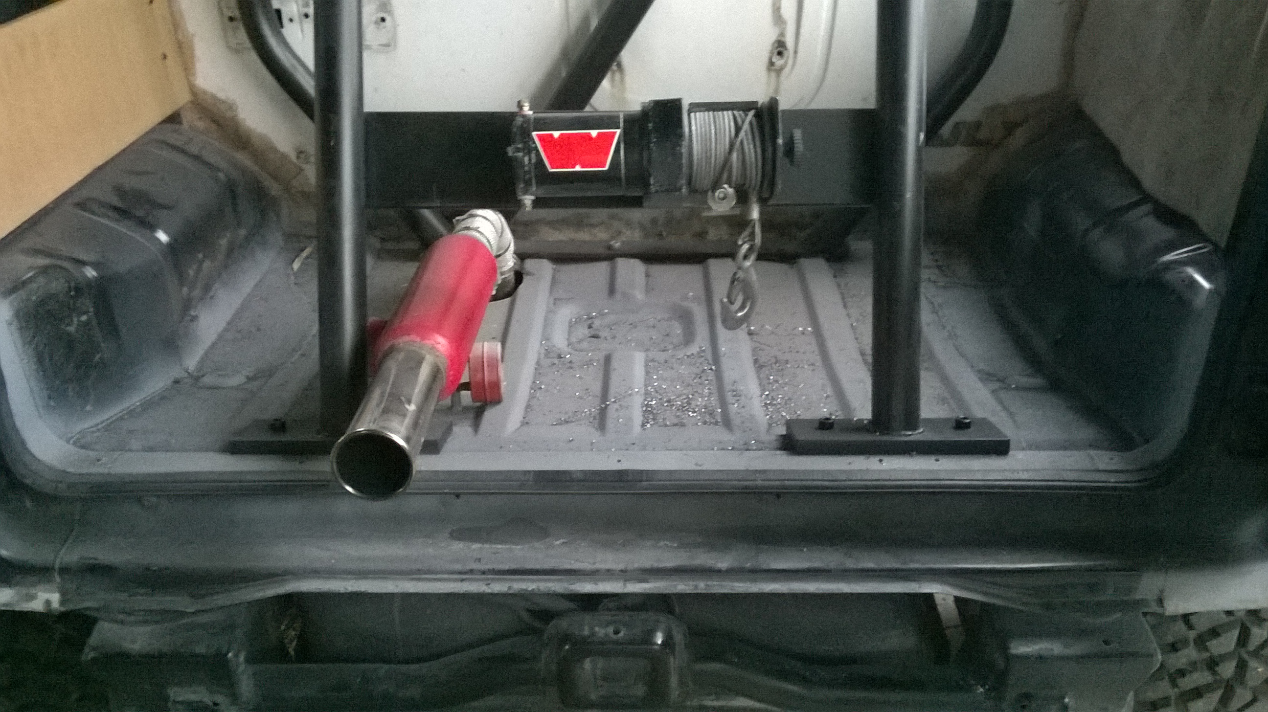

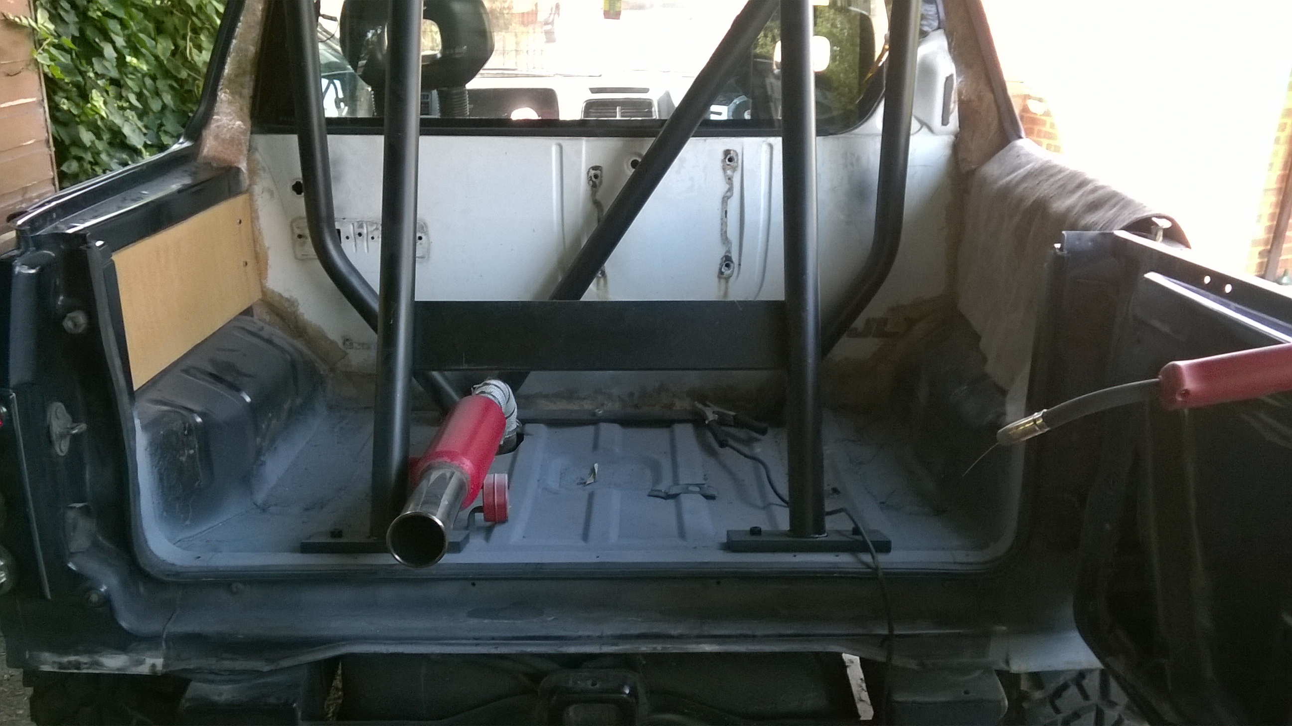

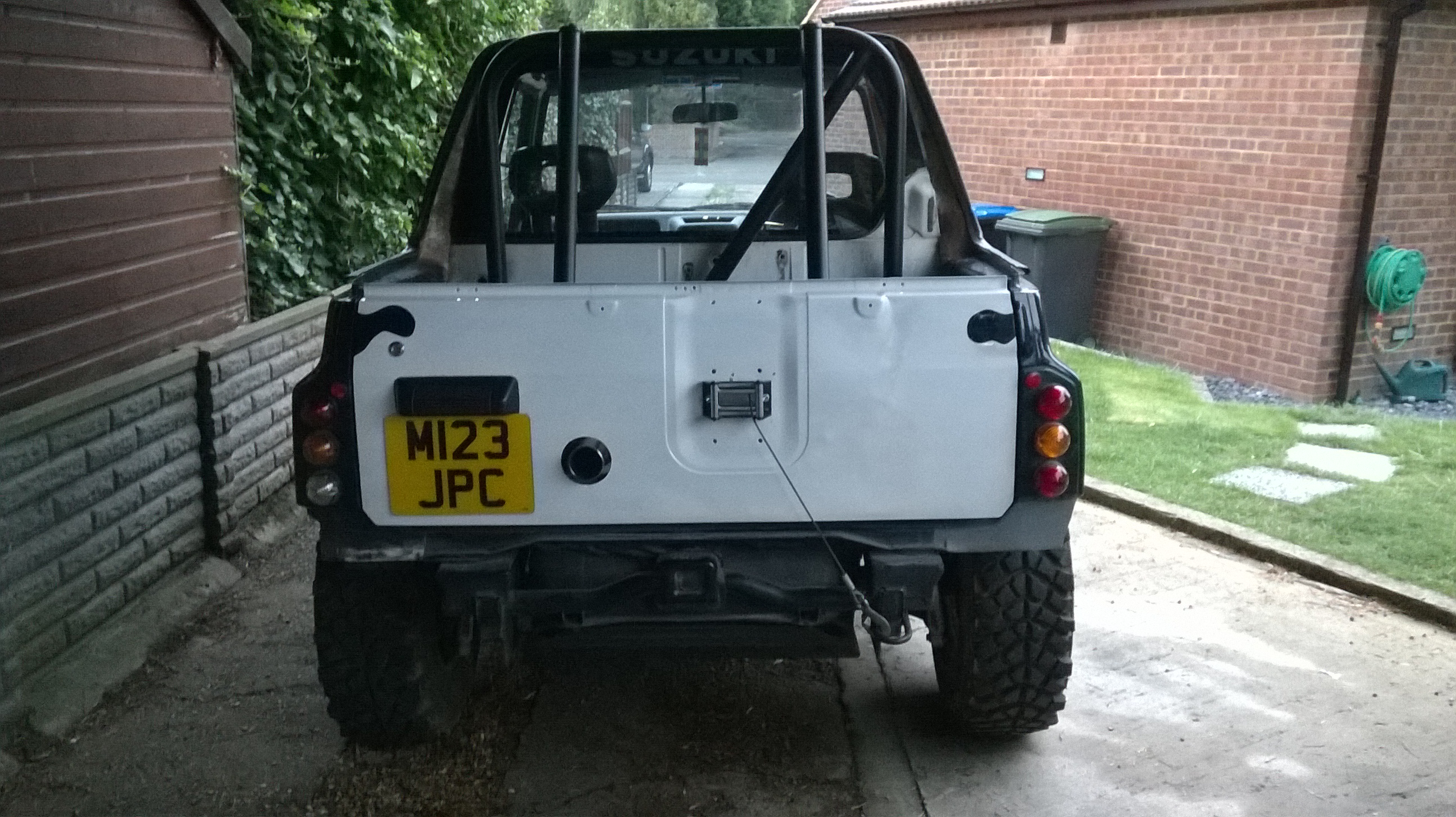

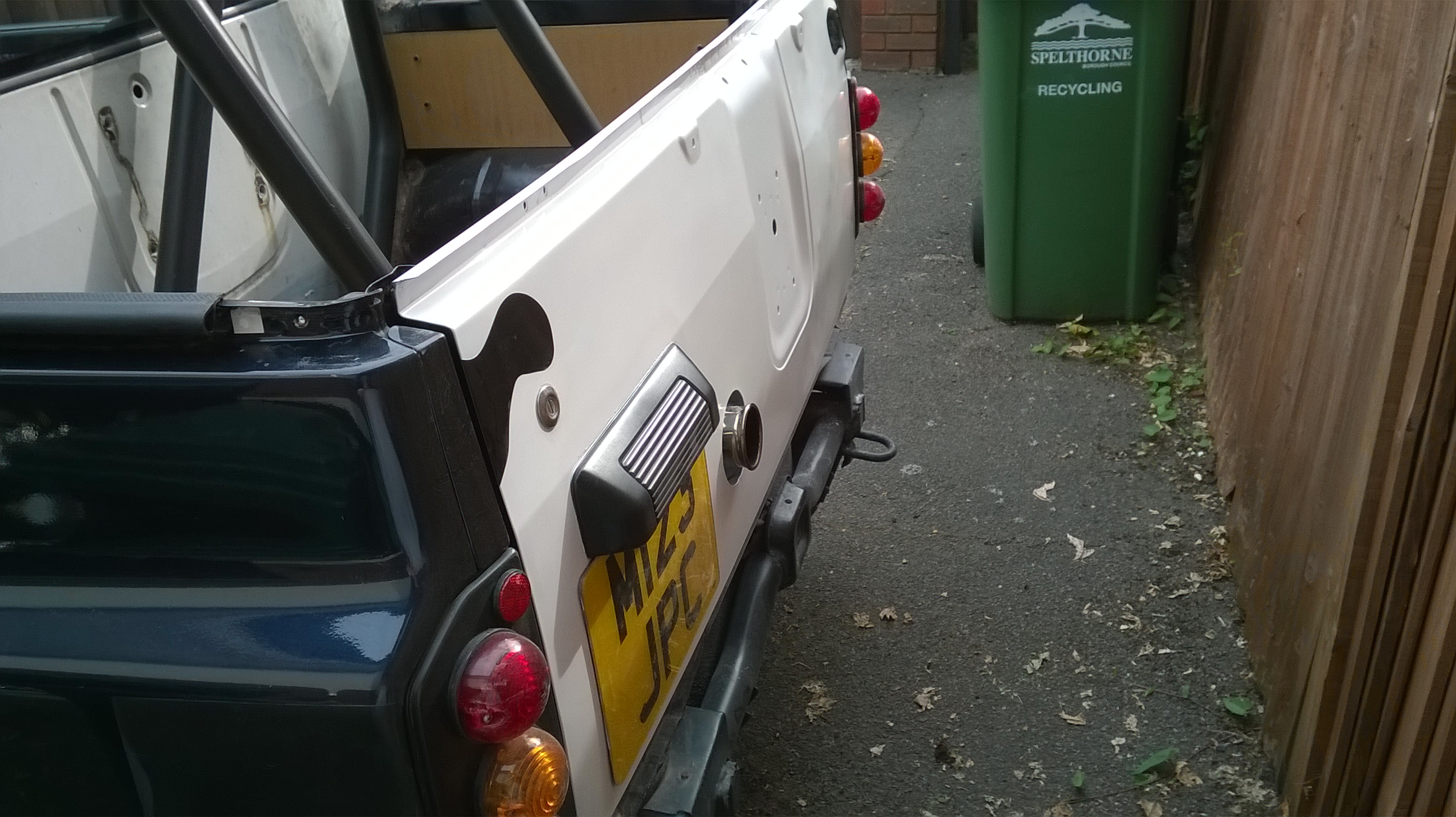

Got the wee winch on. Now on the search for a 9000lb one for the front. With the added weight in the back the handling has vastly improved!

Are you intending on adding any braces to the rear door? I Can imagine some crumpled sheet metal after an angled pull
Re: the no dosh Vitara revamp
Post by donkeychomp » Tue Jul 29, 2014 10:10 pm
Yes Scottie, that's on the list of things to do, and that seems to be endless at the moment! The bike is on it's own two feet now, so I will do the respray maybe this weekend. The arches need more trimming, spacers need to go on as do some wider wheel arches, pick up bed needs lining, and so on!

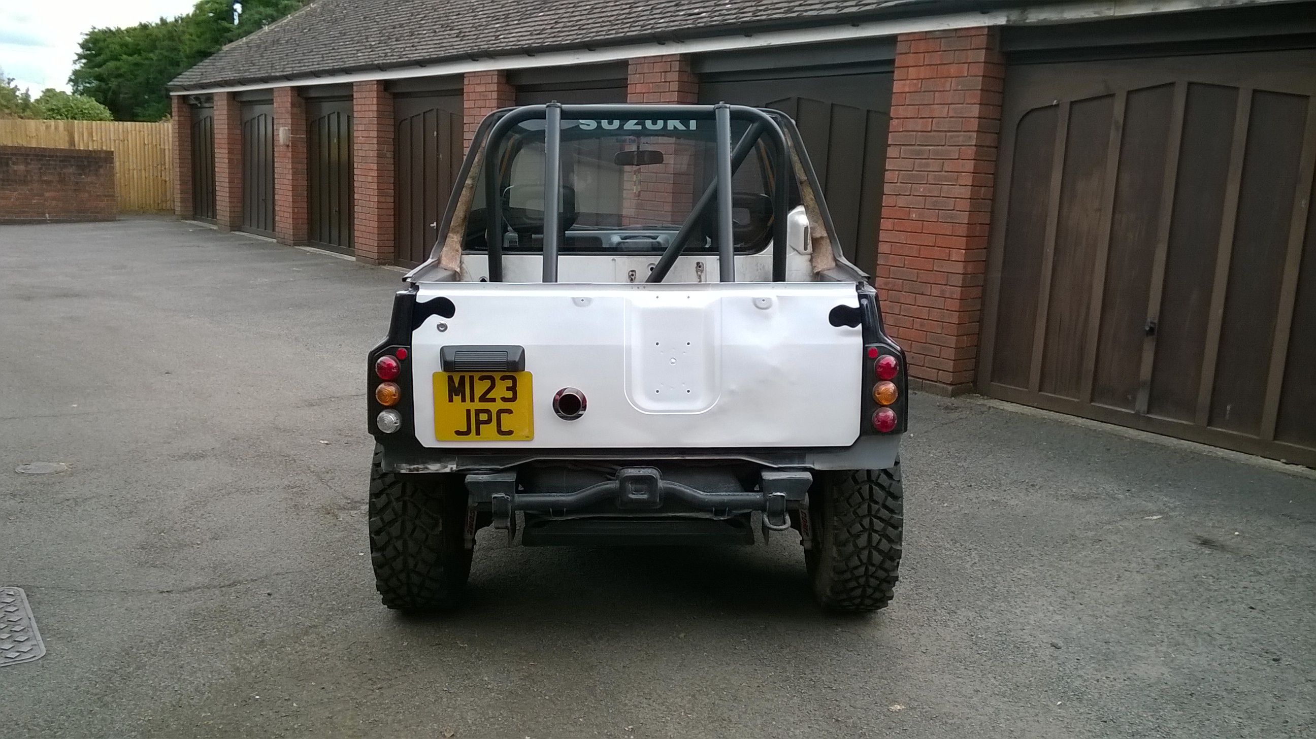

Andy popped over to pick up my old/his new tyres in the summer Citroen. Can't believe 4 tyres and wheels, 1 spare wheel and various other bits all went into the back!

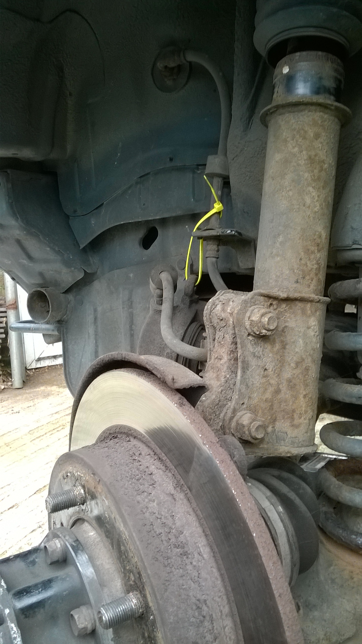

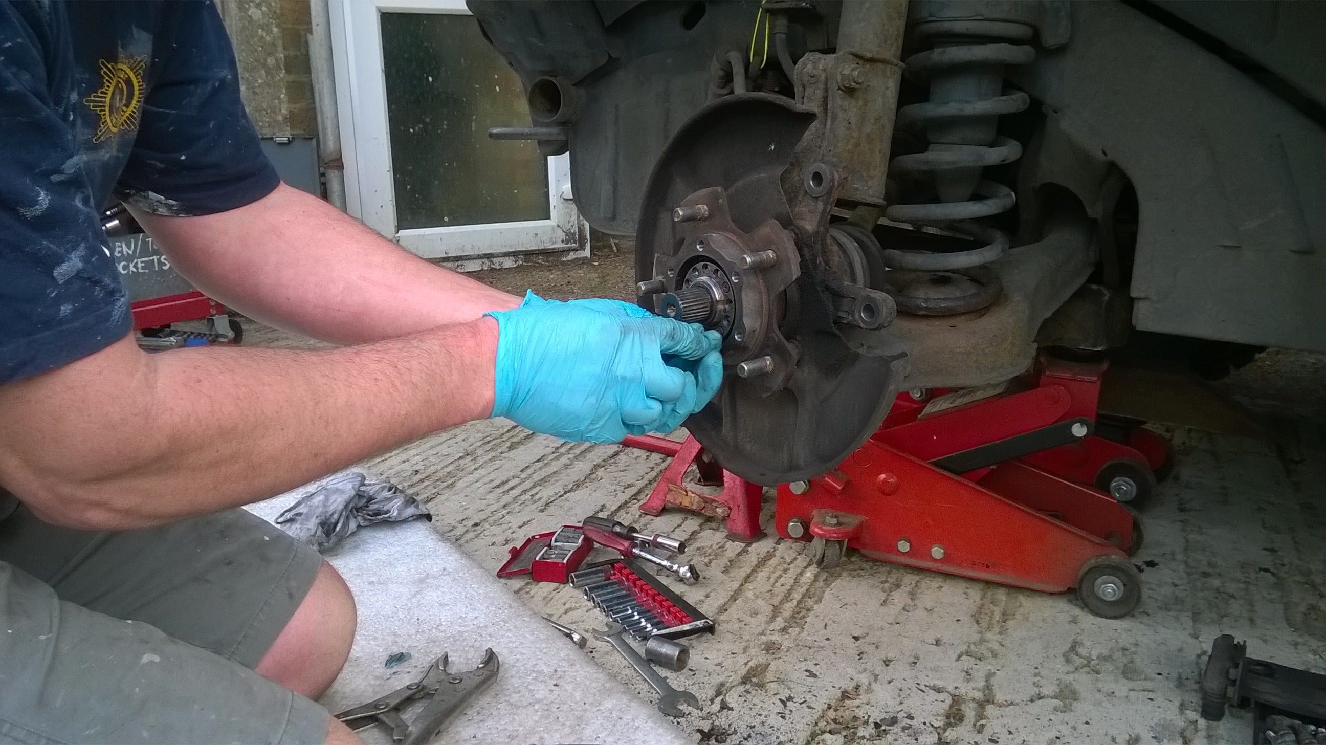

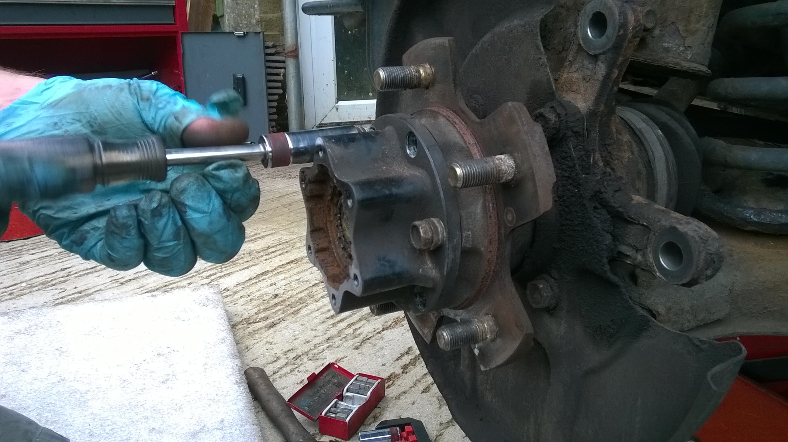

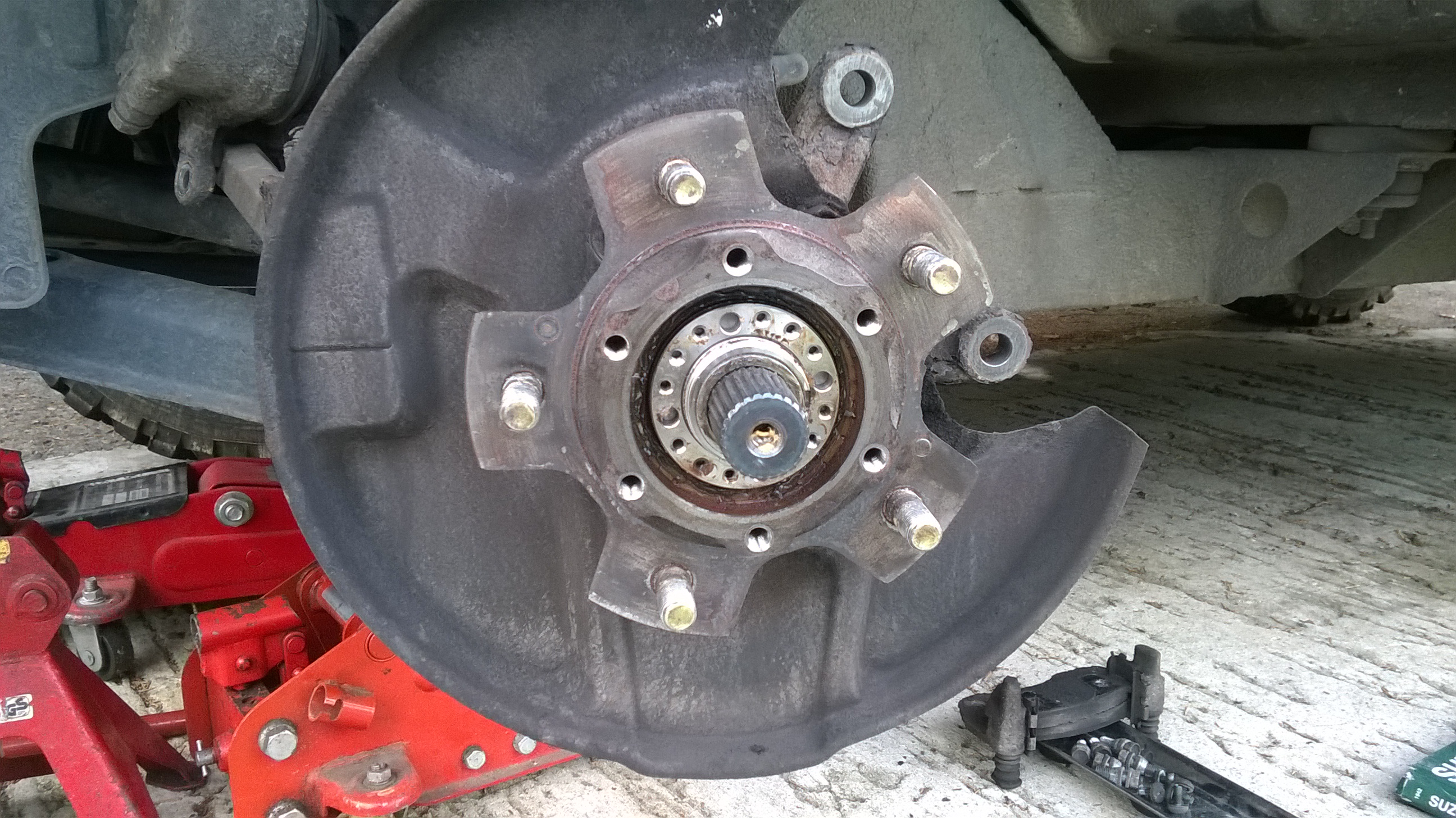

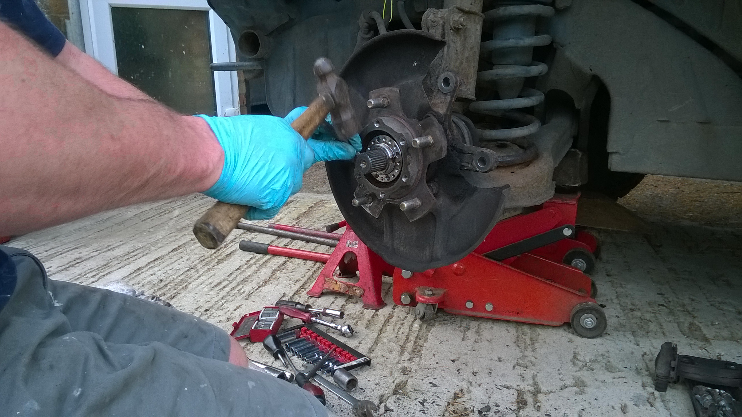

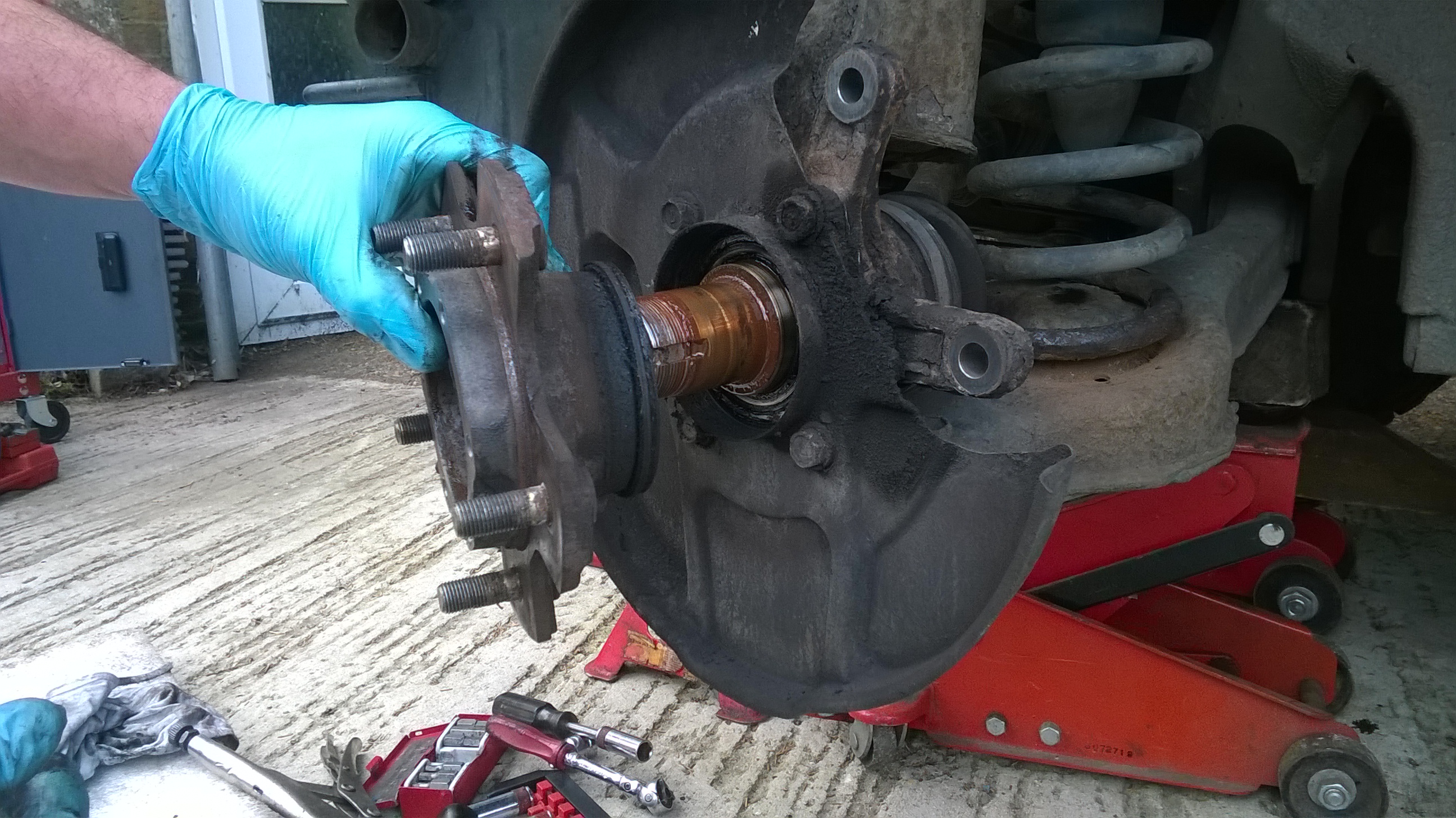

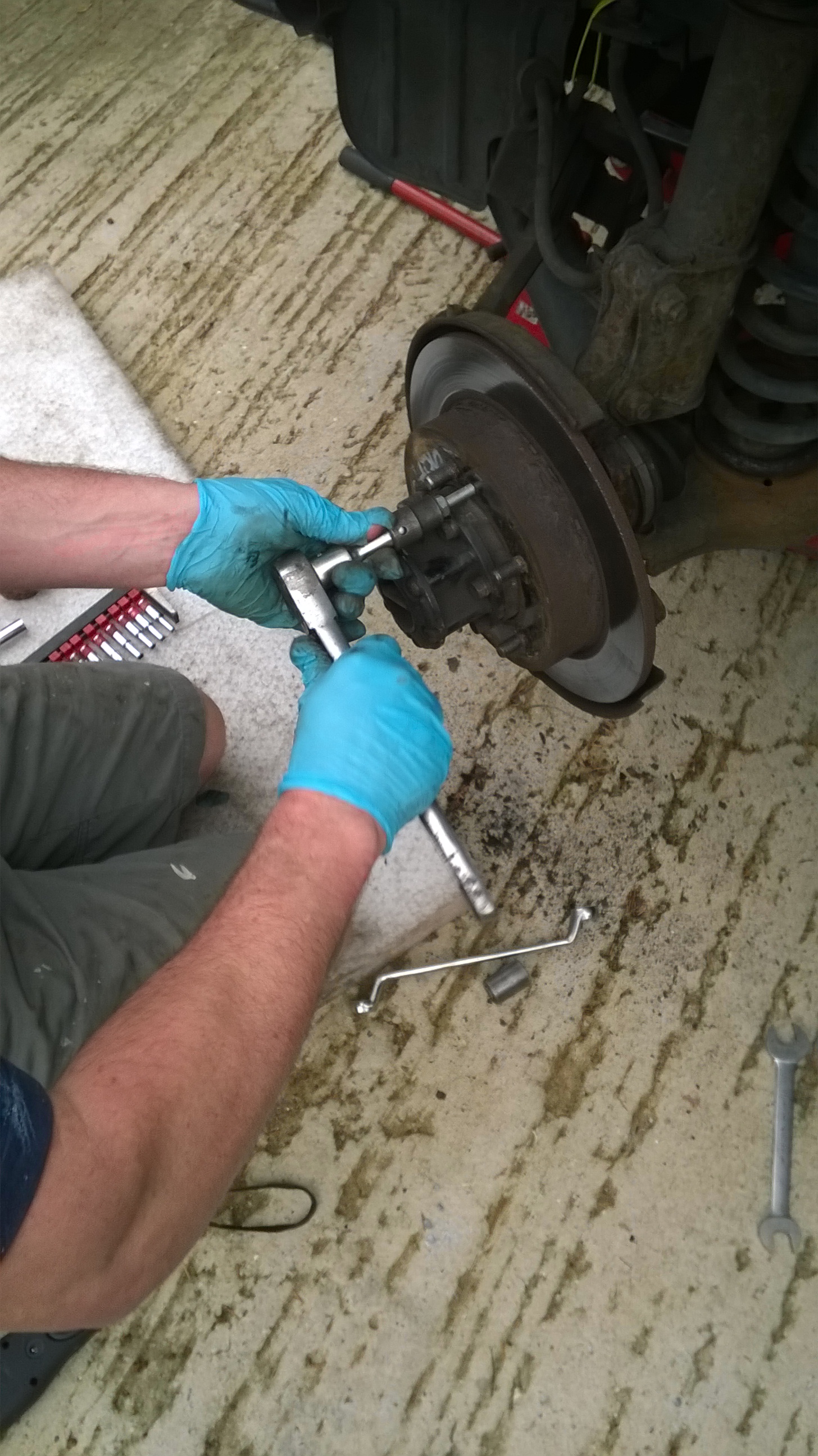

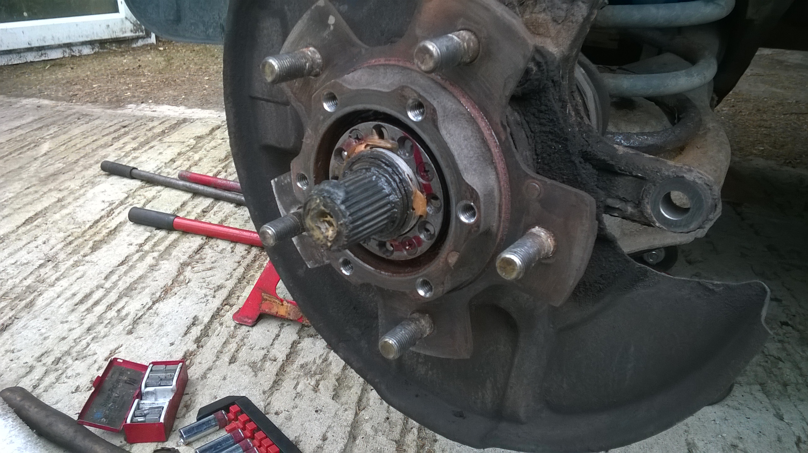

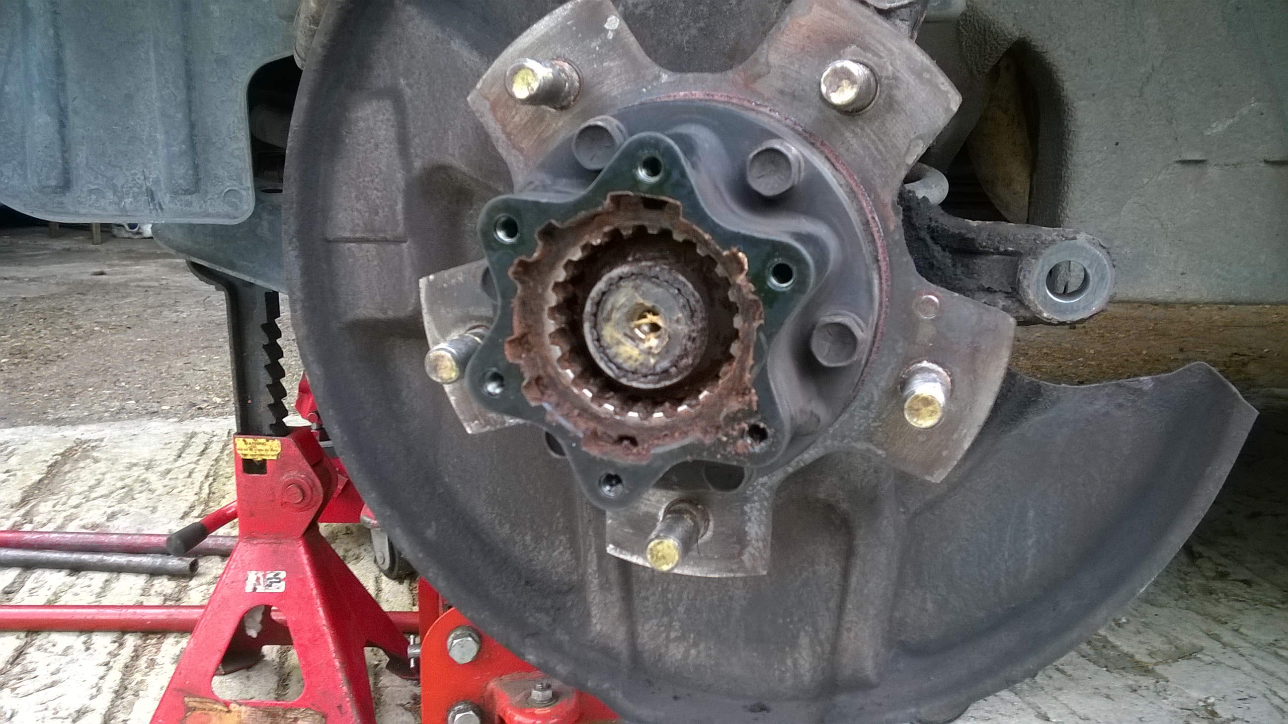

How to (sort of) fit a Vitara wheel bearing part one.

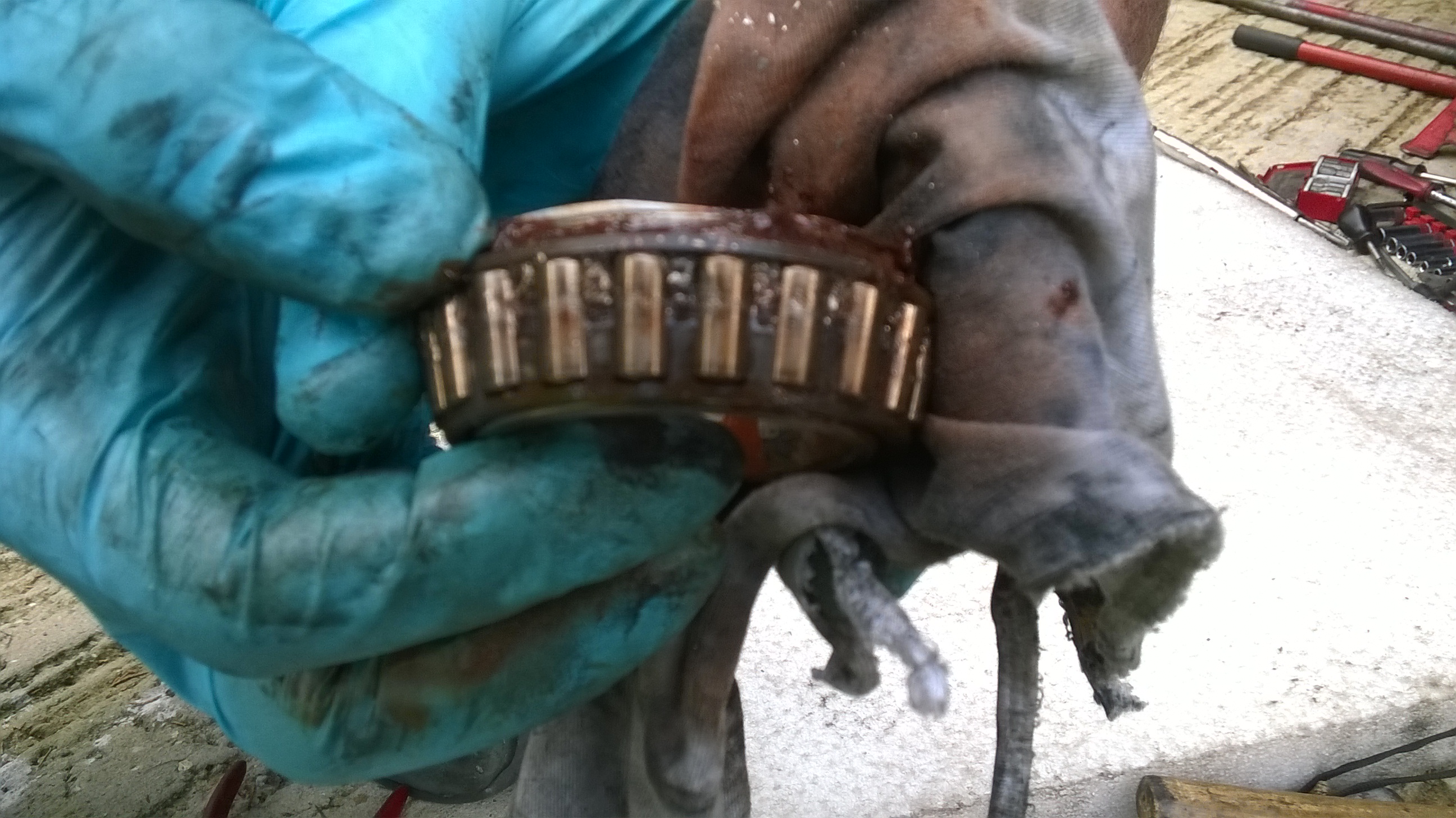

The part arrived this morning and I was immediately on the dog asking why have you sent a Grand Vitara bearing and the wrong year as well. They said they are all the same. Hmm, let's see.

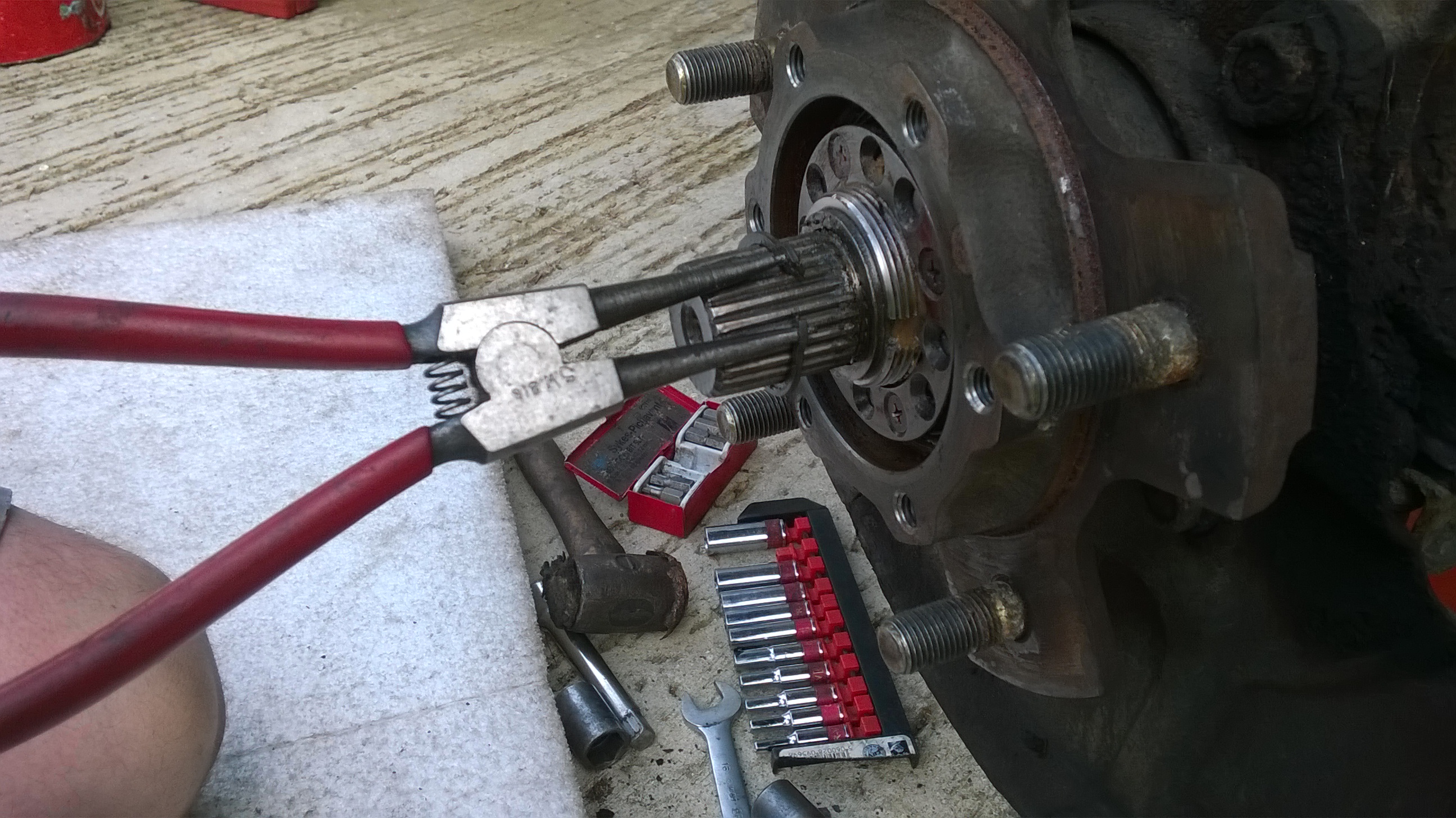

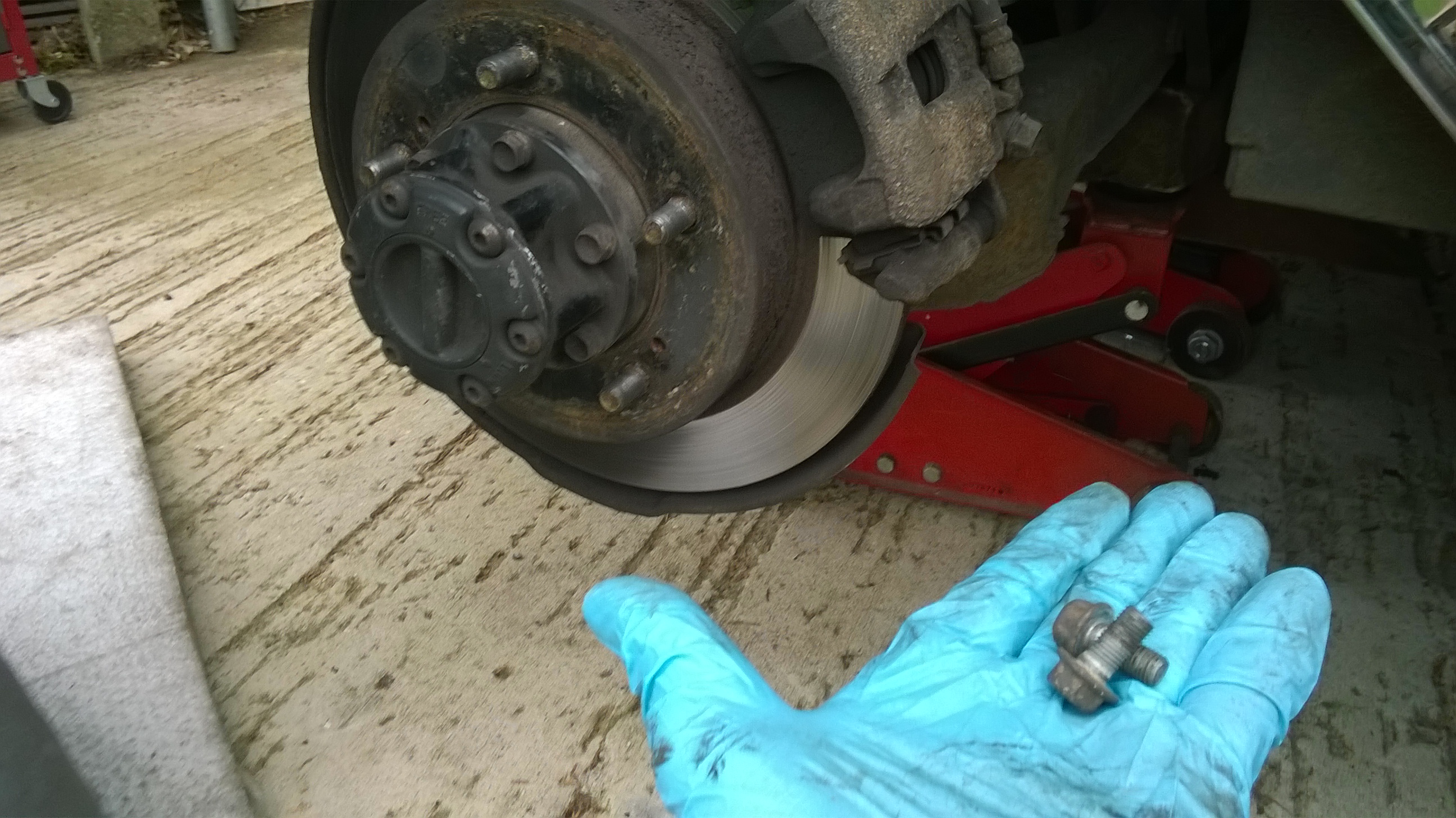

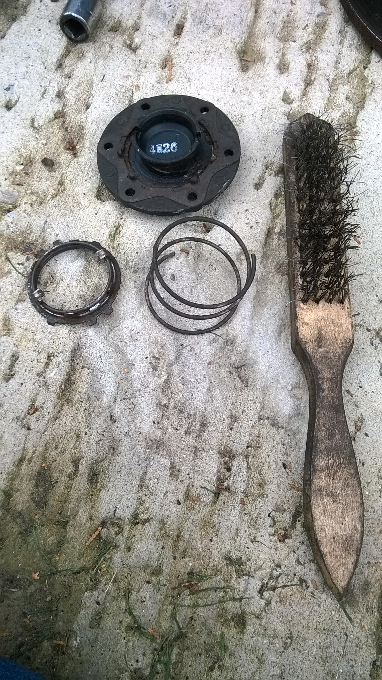

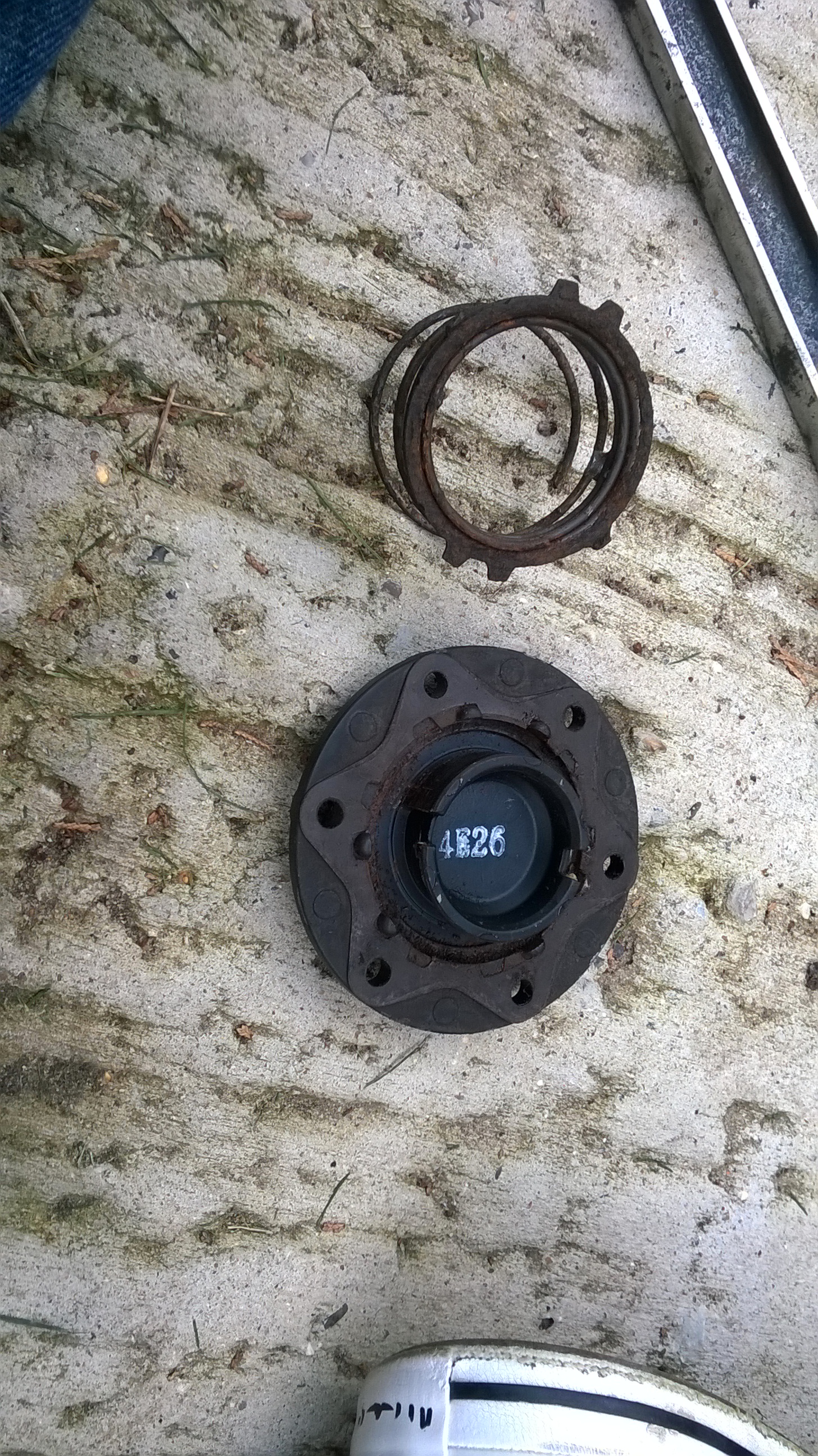

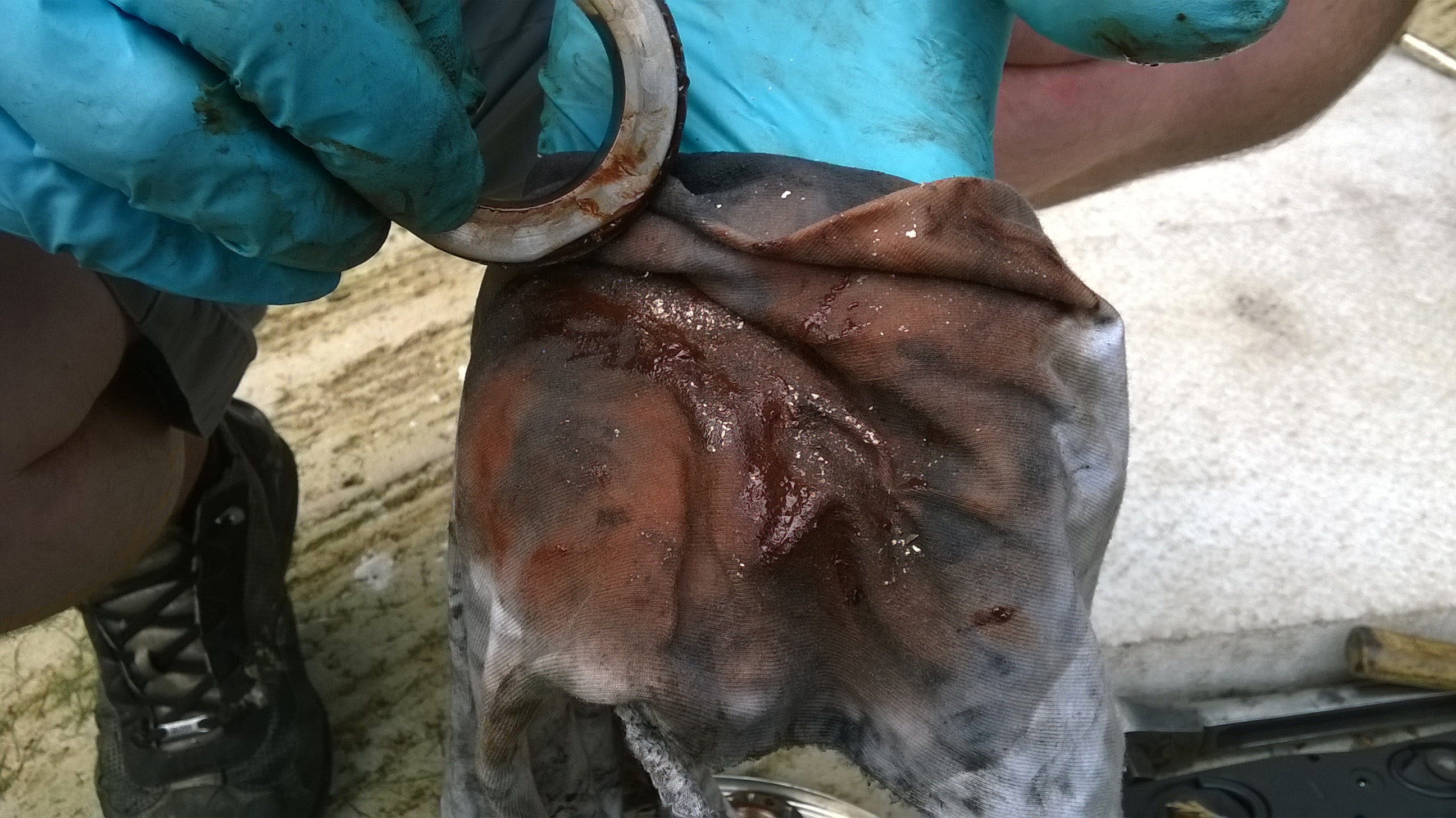

Was all fairly easy really, jack up, wheel off, caliper off and cable tied out of the way, free wheeling hub put up a fight and as there was no gasket behind it this is probably why the bearing failed (big time). Disc didn't respond to hammer time so the old bolt metoid was used. Then lookie lookie. It's a sodding SJ hub!! My jaw hit the ground...why on earth fit that when a Vit one would be way easier to find and put on. Maybe the previous owner had some lying around...
So an SJ one is on it's way for tomorrow, packed the knackered bearing in a ton of grease and limped back home. Part two tomorrow....I hope.
Post by Darrell » Wed Sep 03, 2014 9:32 pm
Well at least it meant the lockring was easy to undo :S
