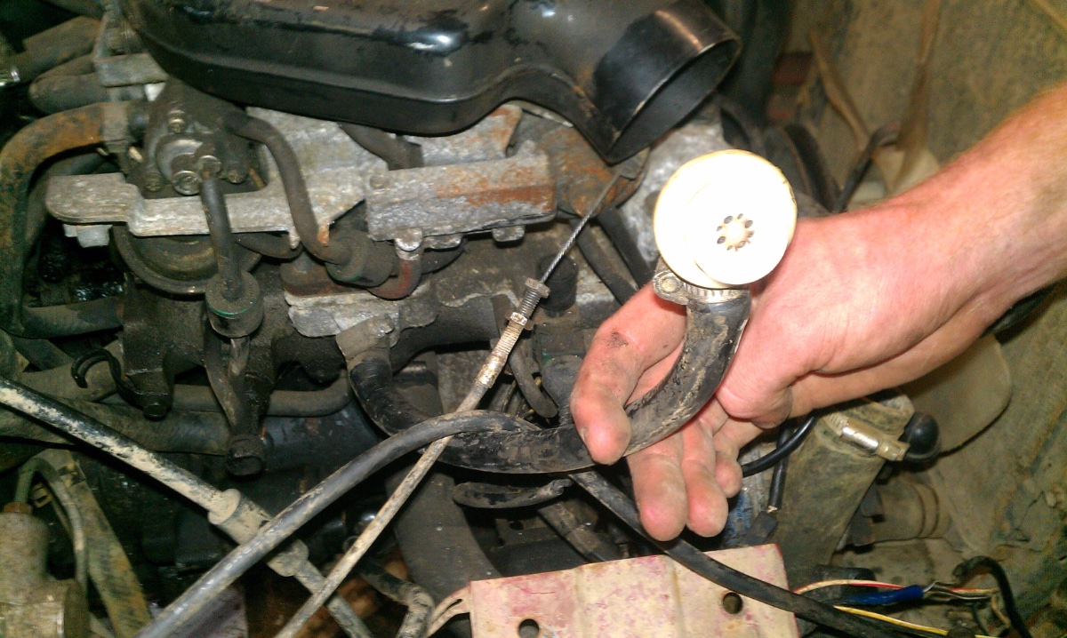

That's grand thanks, mine is about the same so ill just cut out the hole in the floor and try to heat up and bend the gear lever a bit straighter. Next issue, anyone know where this goes, didn't have one on the 410?
Posts: 11724
Re: Tims 410 Build/Project/Repairs/Breakdowns
Post by ScottieJ » Sun Jun 30, 2013 2:20 pm
That's the vacuum pipe for the brake servo so just block it off.
