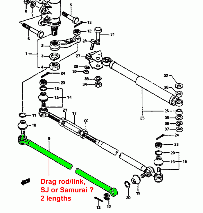

I don't think you can actually change those ball joints!!! Those steering bars can be a pain!
Front axle seals are easy :)
I think you can do it with like 2 or 3 spanners (12, 13, 15mm?), a wheel brace and a jack
(axle stand for safety) ;)

i have a new one thought they unscrewed?? do you have to buy the hole arm then as the ball join on the steering box is dead :(
is there a how to some were on the sills?
Re: Propper country build (turf the sj)
Post by dan_2k_uk » Thu May 16, 2013 9:52 pm
One end it is fixed the other end screws off. cant remember which way round it is so you might get lucky.
Are the seals on the front axle actually leaking or just a bit greasy. They normally look a bit messy but if there isn't oil coming out I wouldn't worry.
If there is oil coming out its not the felts and seal on the hub as they are just to keep the crap out of the cv. It will be the oil seal in the end of the axle tube.
Remove the wheel and caliper then remove tie rod. Now remove the 8 little bolts holding the big seal onto the swivel knuckle and remove the felts and seal from behind. Now take out both kingpins and you should be able to pull the whole thing with shaft from the axle and replace the seal you will see in the end of the axle tube.
Dan
Post by twiss » Thu May 16, 2013 10:10 pm
The tie rod end that connects to the wheel hub comes off, but the others don't.
You can split the bar in 2 bits though, so you may only need to find the top bar (drag link i think)

Balls looks like i brought the wrong part then i'll get the bar off and get a picture but i'm sure i got the green one in the pic :(
got a friendly parts place i'll take it to any were els you guys know to buy them from?
