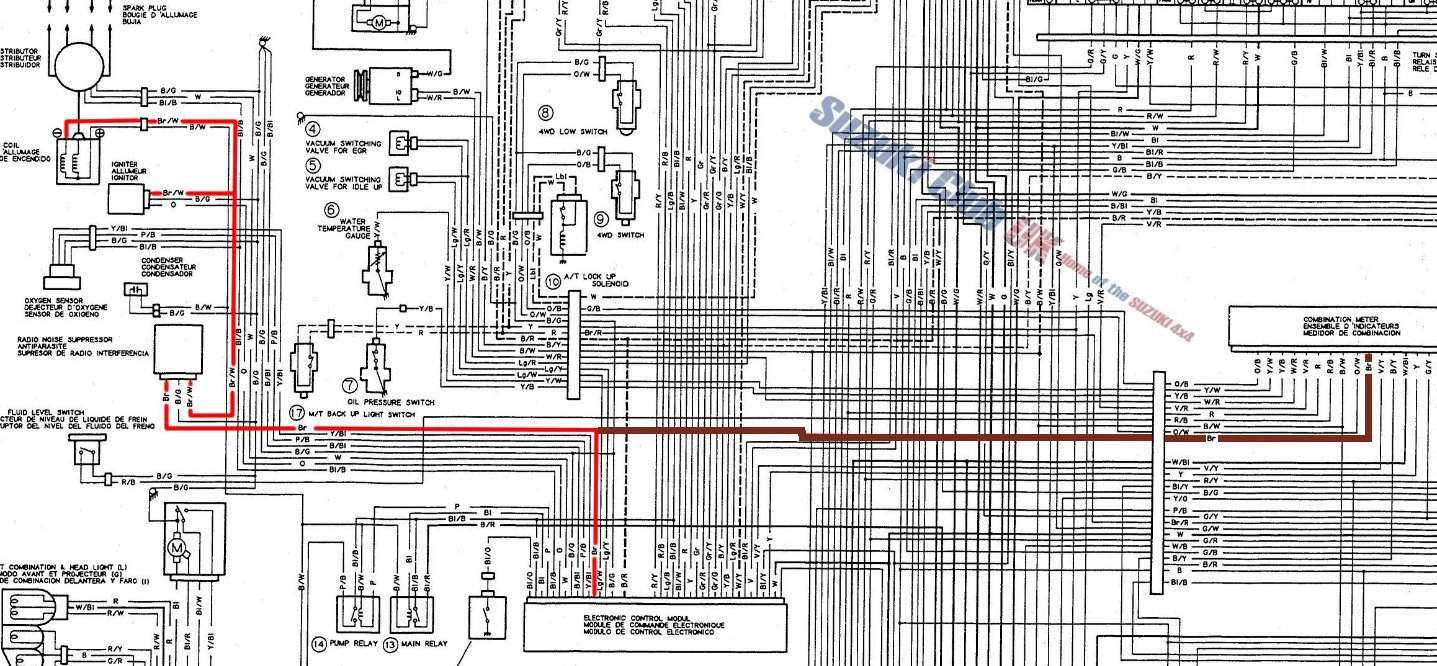

The wiring in red must already be there as it's running. You just need to run the brown wire to the rev counter.
vit rev.jpg (326.48 KiB) Viewed 4070 times

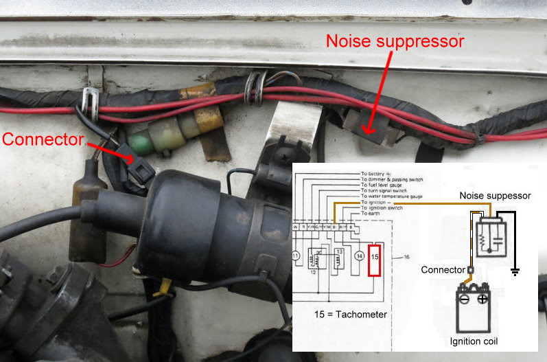

The noise suppressor on an SJ looks like this......
Not sure if it's the same on the 1600
Rev counter wiring diagram.jpg (95.51 KiB) Viewed 4068 times
