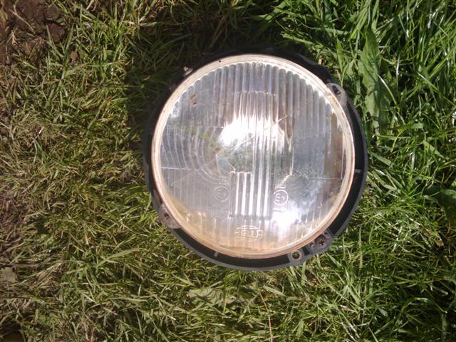

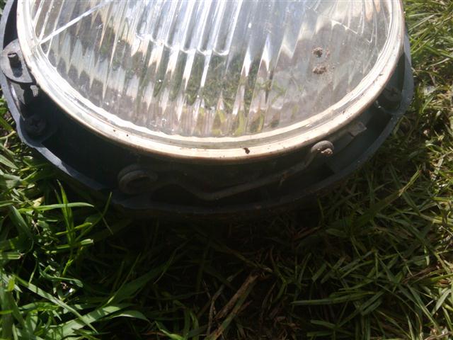

Photographs as promised. I have found out they are hella headlights. Found some that sold on ebay a day ago... GRRRR :argh:. It's also raining now so putting a hold on finishing the welding :argh: :argh:.
If anyone knows where I can get hold of some new ones that would be great.
I am thinking of putting the new headlight in the oven to separate the glass from the headlight and join it back together with some silicone stuff. Seen a guide on how to do this on the internet, so might give that a try.

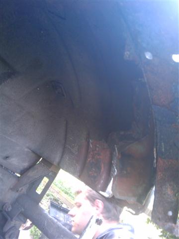

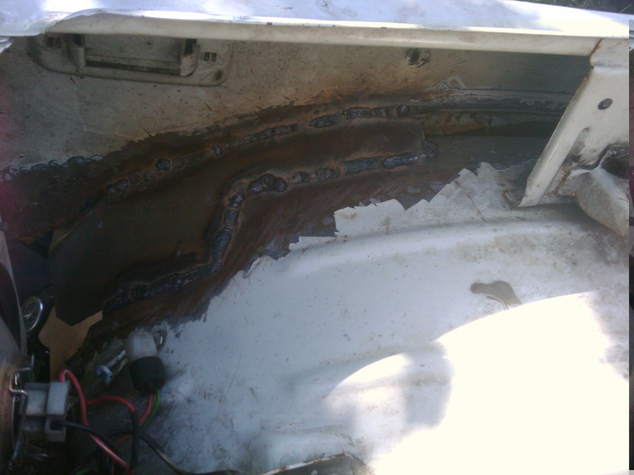

Pictures from todays work - Productive day but waiting for the :thefinger: rain to stop.

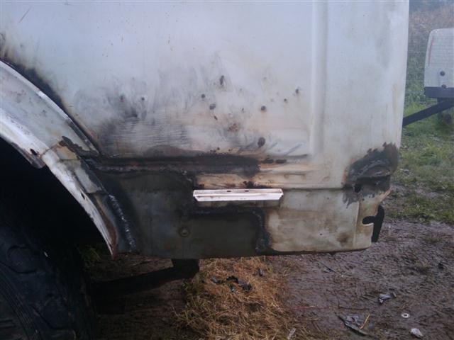

Friend of mine has some how has the patience to weld the front wing back together!

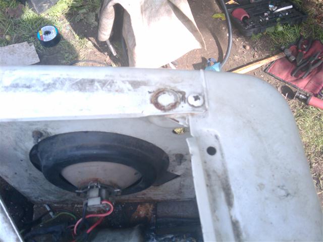

Front Wing Arch (2).jpg (344.19 KiB) Viewed 9281 times

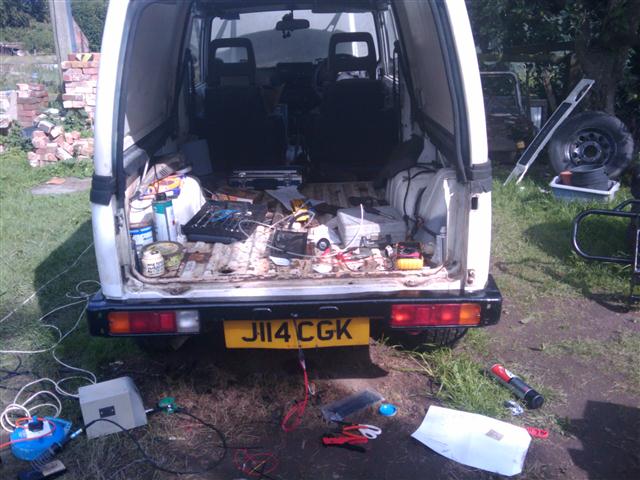

Rear New Lights (Small).jpg (58.56 KiB) Viewed 9281 times

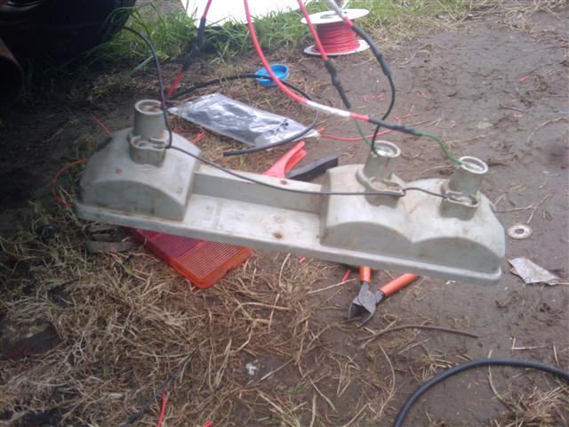

Wiring Rear lights (Small).jpg (119.41 KiB) Viewed 9281 times
Rear Passanger Welded (Small).jpg (77.27 KiB) Viewed 9281 times

looking good you dont need anymore silicane just pop it back in the oven for 5 and the glue will bond itself back as it cools matey

bigben wrote:looking good you dont need anymore silicane just pop it back in the oven for 5 and the glue will bond itself back as it cools matey
Perfect Thanks, will make use of this information

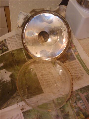

One successfully separated piece of glass from the headlight. Stick it in the oven on high for 20 mins comes off a treat :)
Headlight (Glass Seperated).jpg (67 KiB) Viewed 9251 times

They were really picky on one weld. patch was about half a meter so did not fully weld the end of it as it was more than 30cm away from the seat belt mount. So need to finish that weld (5 min job) and all is sorted.
