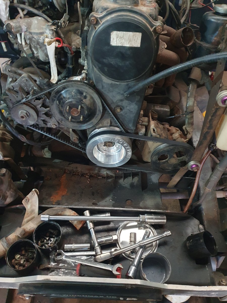

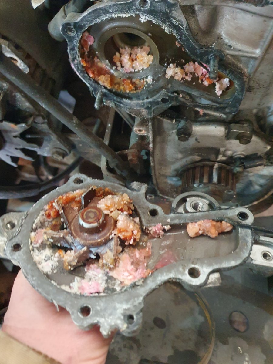

Finally got the power steering finished and the timing belt and water pump changed over. Old belt didn't look to bad but better safe than sorry. As im keeping the 1.3 i had to get a aftermarket pulley to suit the 4 bolt pattern.
Radiator and hoses all connected up now, most of the engine wiring connected up, still some wires to figure out tho. Ran the looms back along under car to where they where previously cut. One of the looms is for a old rear wiper and demister so can probably remove it as don't think I'm going to be able to find a rear window to suit the hardtop.

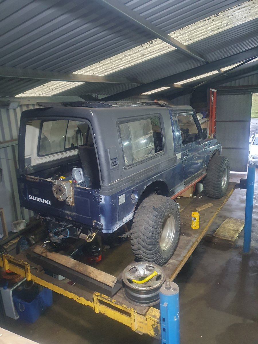

Got the car running for the first time today, didn't have any petrol so just with some brake cleaner, but was good to hear it fire up for the first time.
Brakes are all plumbed up and bled to, routed the battery wires over to the passenger side and I'm going to use the battery tray from my old primera once I get the front end welded and back on.

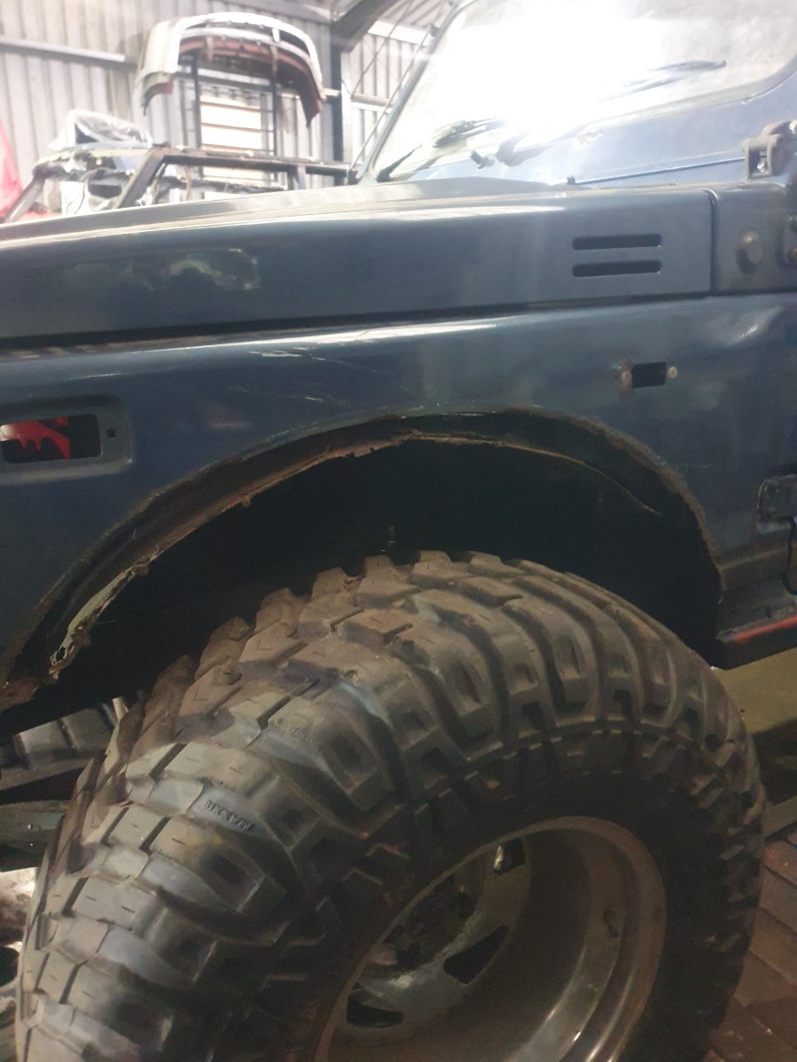

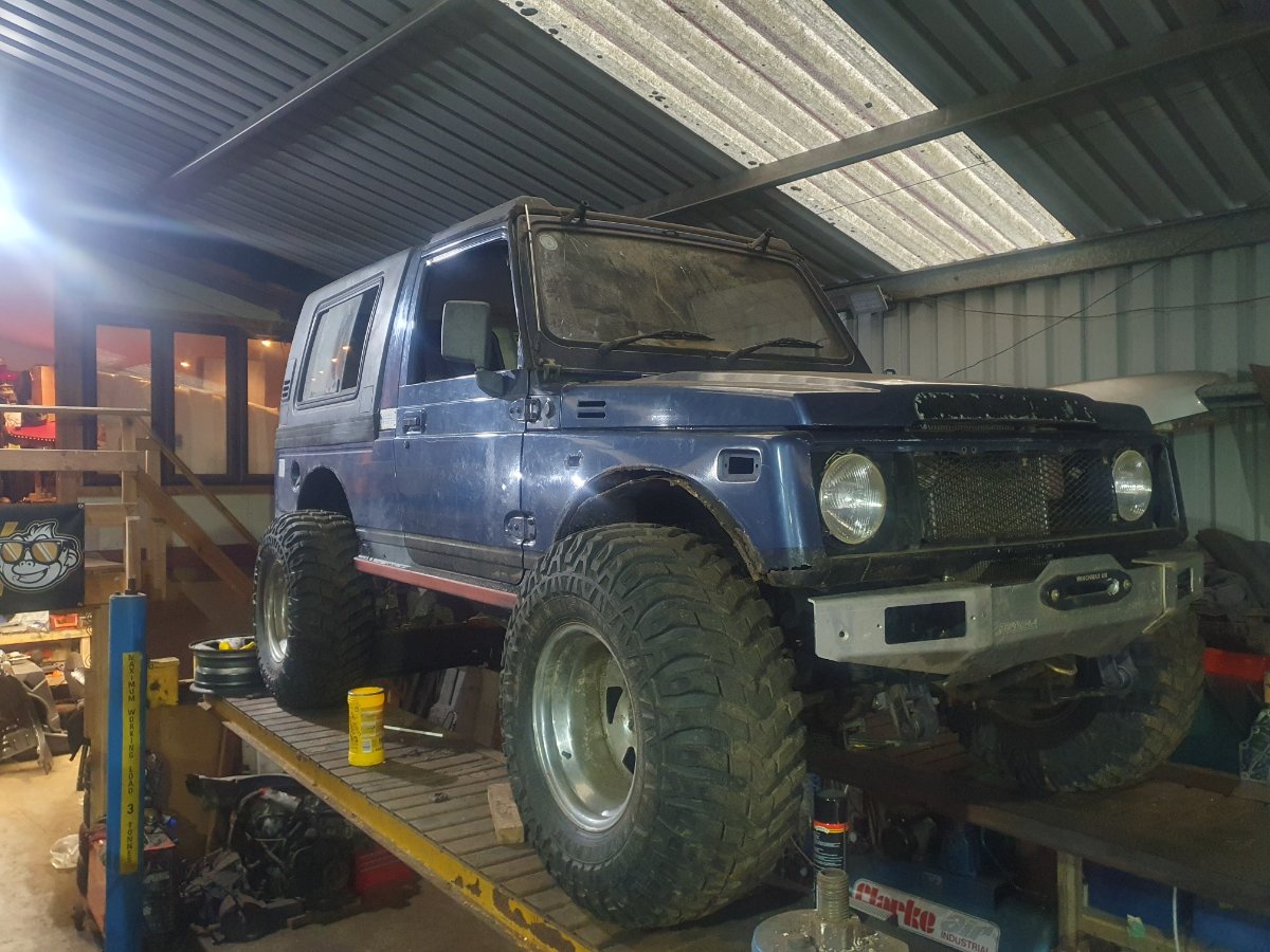

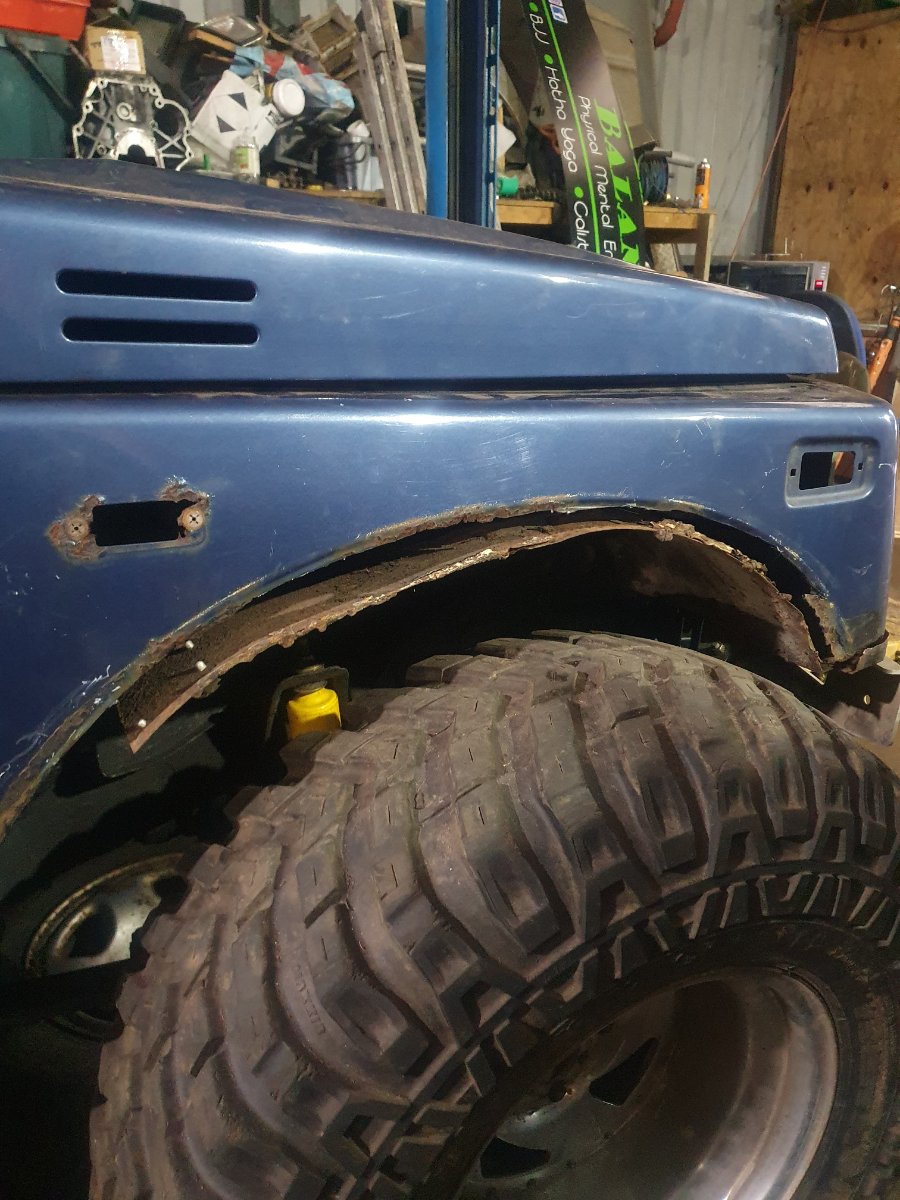

Another couple hours up the garage today. Got the front body mount repaired, the clip back on and cut what metal was left to the new height for the virtual lift.
