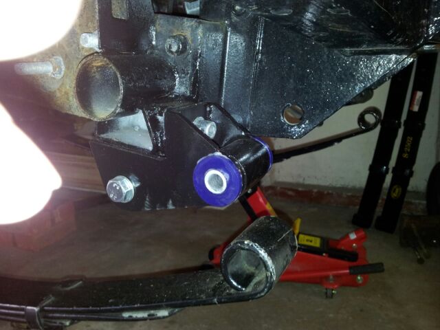

Time for a few more pics. Got the yj's in. I tried to be clever and get my front clip painted while I was away at Xmas but hadn't started the springs. I found I hadnt cut enough out of the front wings when axle flexes just below the headlight so I've had to hit them with the welder again :S I've also discovered the the textured blue hammerite paint is a bloody good match to Worcester blue Suzuki paint! Well at least close enough for wheel arches and under body. Few little things to finish on the yj brackets then all off to paint. The axle housings might get a tidy up while I'm there too, keep finding jobs that aren't on my list and taking extra time!
Also cut the old shock towers off and welded some extra length and strength then welded back on to the chassis.

One thing I've found and not sure if others out there with yj's have the same but there is huge movement in the spring hanger bushes, they are new bushes and bolts are only just nipped up but I was surprised how much movement was in the bushes. Is there a better brand bush to use? I've made the mounts to take Suzuki bushes. Maybe that's the problem?
gp7186
Posts: 112
Re: Brads Lwb
Post by gp7186 » Wed Apr 08, 2015 6:53 pm
ermmm!!! They look very familiar to my design if im not mistaken. Nicely done

Post by Kiwibrad » Wed Apr 08, 2015 7:13 pm
gp7186 wrote:ermmm!!! They look very familiar to my design if im not mistaken. Nicely done
Yes. Guilty! I looked at a few different conversions and really liked your design on the front and particularly like how it can all unbolt.
