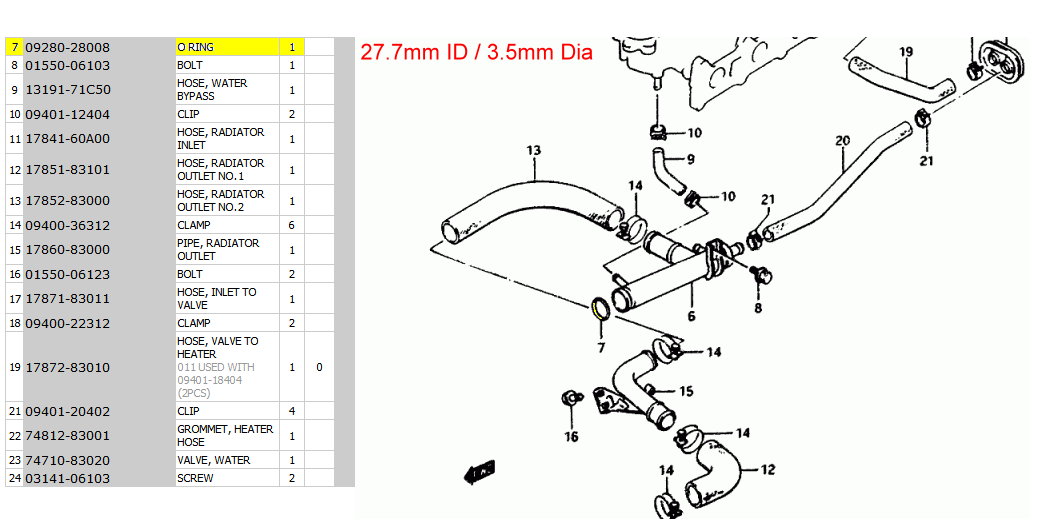

Fitted a bigger alternator to the truck. Had to stretch the bottom rad hose a bit to reach around it. Now it's sprung a leak.
Removed bottom rad hose, it's not got any holes in it (Pressurized it up etc). But I have a feeling it's leaking from the solid tube which pushes into the block behind the water pump.
Any idea how I can stop this leaking? Is the O-ring replaceable?

Post by Darrell » Wed Sep 24, 2014 8:50 pm
binge wrote:Fitted a bigger alternator to the truck. Had to stretch the bottom rad hose a bit to reach around it. Now it's sprung a leak.
Yes
The 413 has this
SJ 413 water rail o-ring.jpg (93.92 KiB) Viewed 7448 times

Fitted a new O-ring today. Even gave it a smear of RTV Silicone. Bolted it all back up, replaced pipe work etc.
It's now p*ssing out of the back of the water pump. Bloody thing!
And it's an utter arse to take the solid pipe off with the inlet maifold in place.
Will have another look the weekend, take all the inlet off etc. If I cant fix it, it's going. haha!

Couldn't find that exact size O-ring online, but got a load of 27mm x 3.5mm ones. And some 27mm x 3.1mm ones.
Hopefully one of the two sizes will seal the hole up. I'm thinking the original size O-ring may be too skinny now, as the pipes rusted over 30 years etc...

Fitted a new O-ring today. Seals up perfectly. Run the engine up for 10 mins, then discover a constant dripping from behind the crank pulley. F*CK MY LIFE! It's leaking from the water pump now I think. :|
