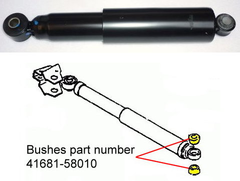

Post by Darrell » Sat Aug 24, 2013 3:29 pm
You can get bushes for 1 end.
But if it's too far shagged http://www.jimnybits.co.uk/shop/sj-/-sa ... d_619.html
Steering damper bushes SJ.jpg (26.62 KiB) Viewed 7498 times

As for the steering damper, I have no idea if it's shagged or not - I think I'll have to take it off and test it (I have to take it off to fit a new bush anyway!).
A new one seems like a good idea, if I'm honest - but funds just do not allow me to go there at the moment!
