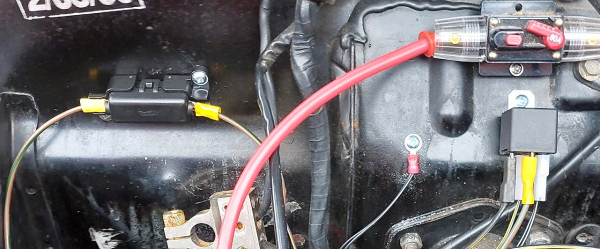

With dry but very cold weather managed to get auxiliary fusebox and relays in position and wiring connections underway.

Slowly but surely wiring is getting done.

More wiring. Sorted out Starter solenoid relay.
30A fuse added. 80A fuse above relay is for Volvo power steering pump.

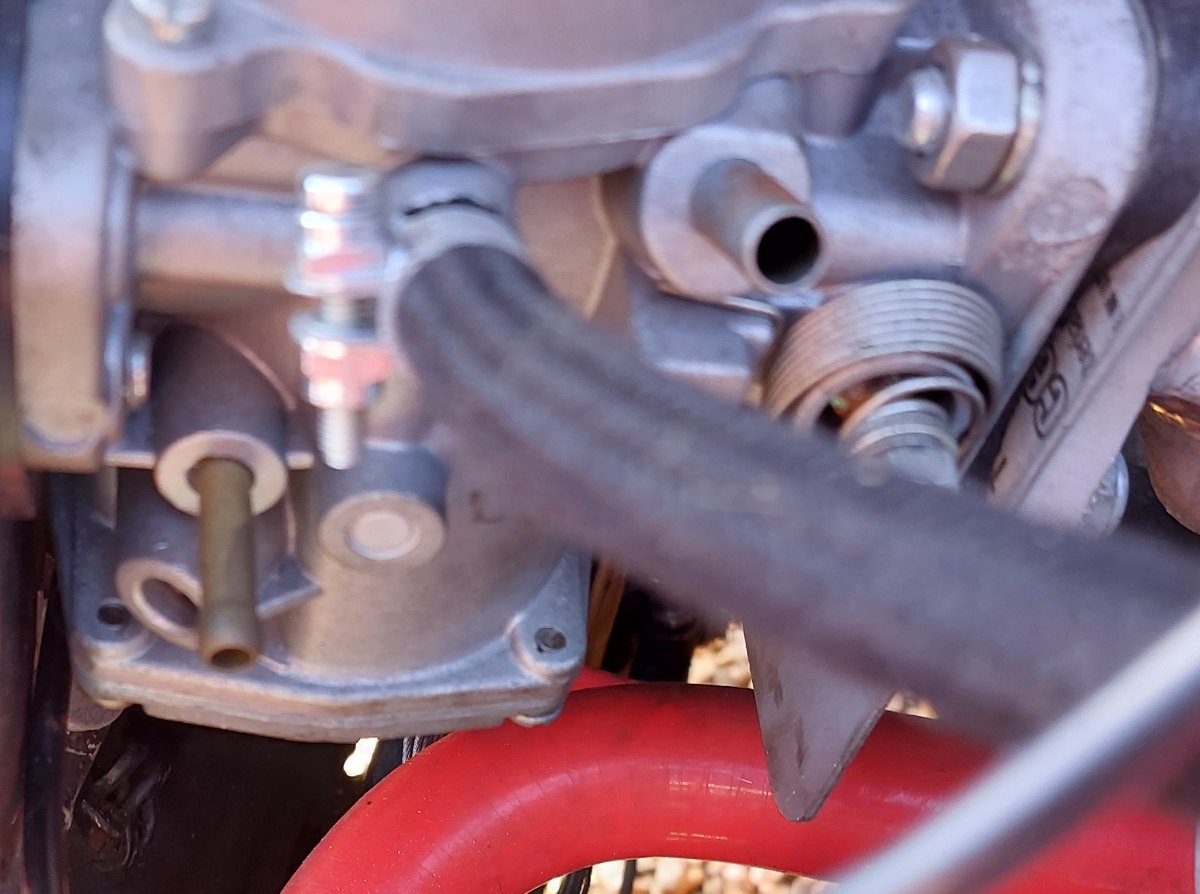

Can anyone help with a small problem I have on the SU carb.
Feed sorted as is fuel overflow connection.
What is connection at bottom left of picture for please?

by ScottieJ
Bottom left is fuel feed.
See pic in post 2 on this page.
viewtopic.php?t=2249&start=40
