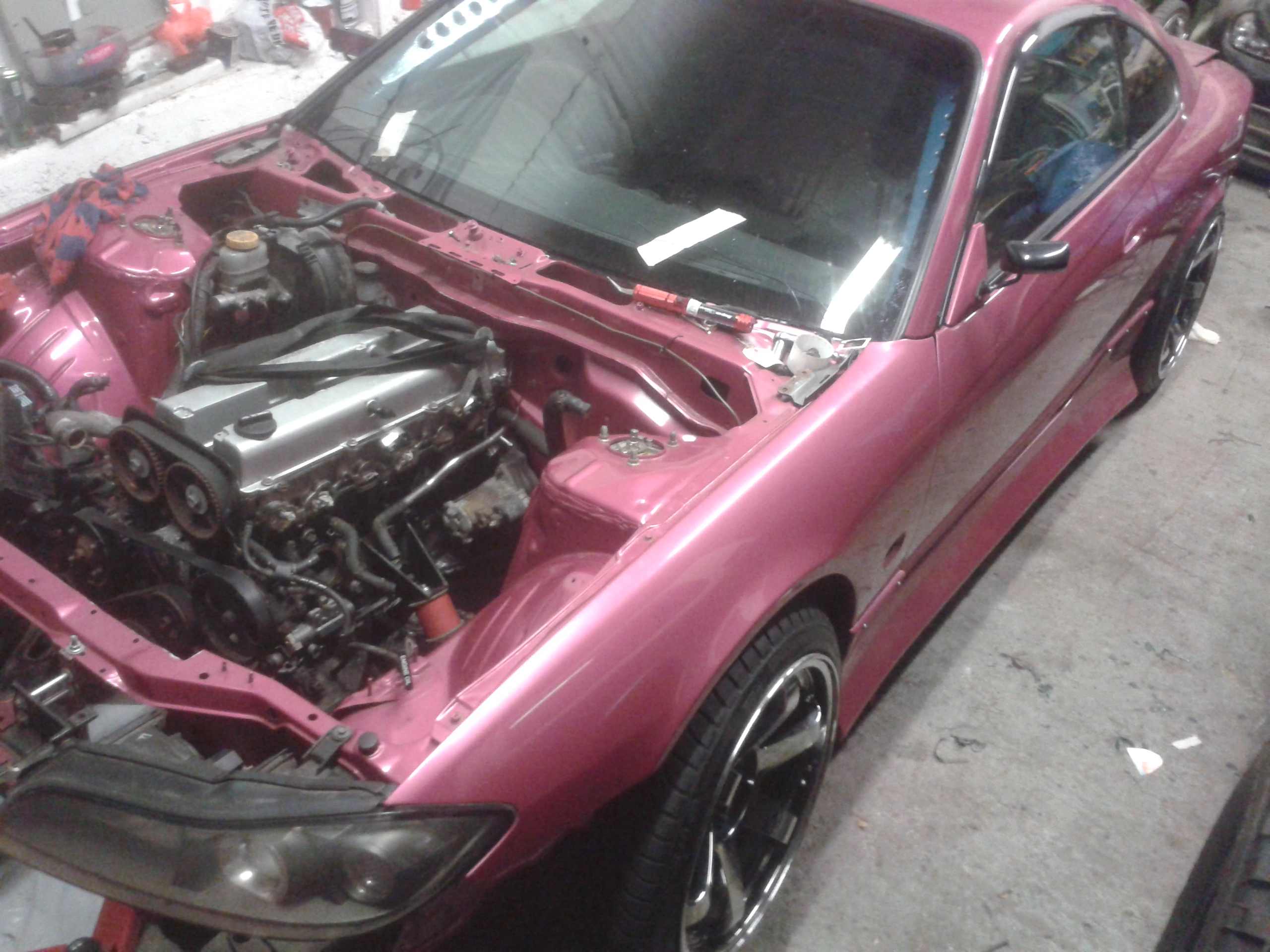

Slightly different but this was sprayed in my workshop
And the laquer resembled something similar to bubble wrap
With dead bugs and dust in it. I thought it was a redo job
But a friend of the owner flattened and polished it up lovely

oooh i do like S15's haha now that you say it i would say my paintjob looks like bubblewrap haha
