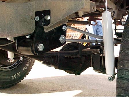

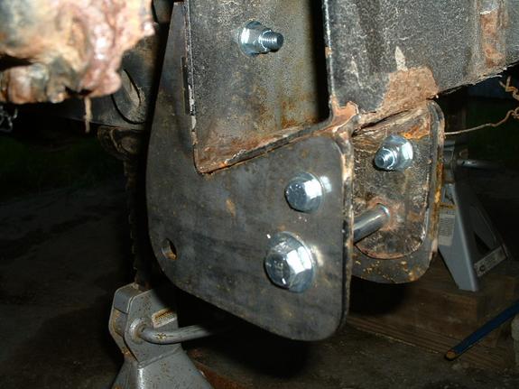

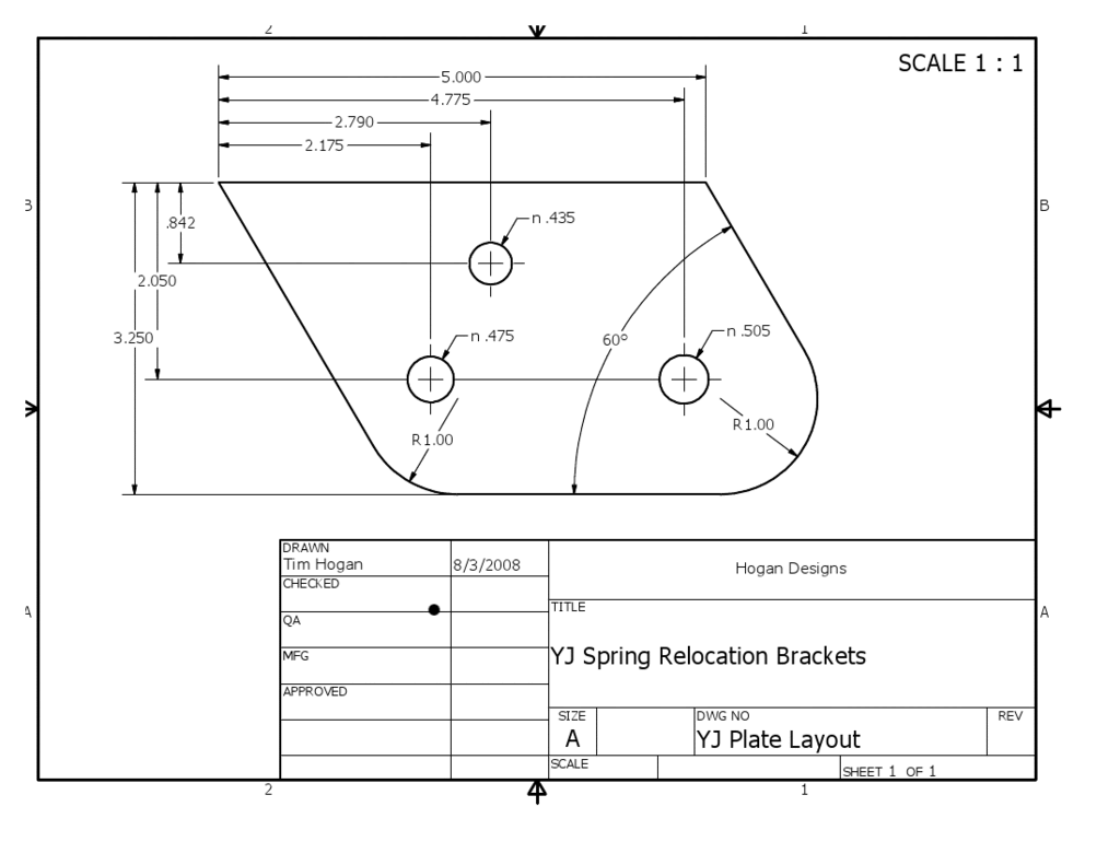

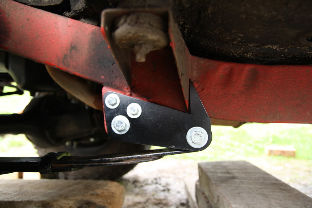

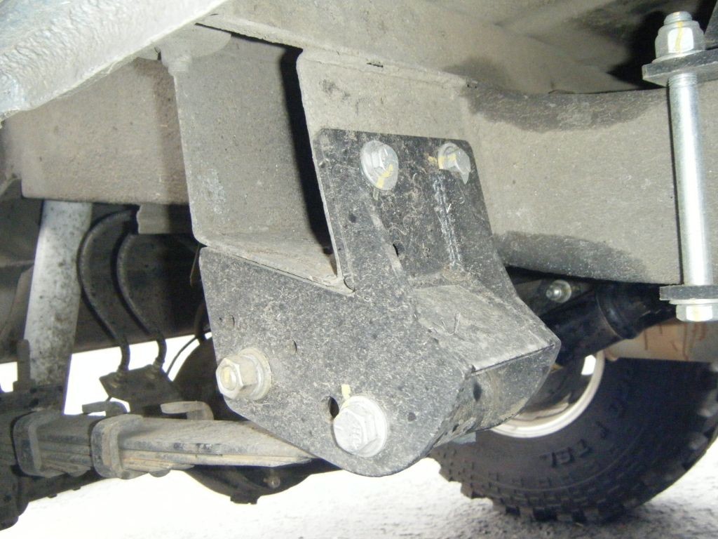

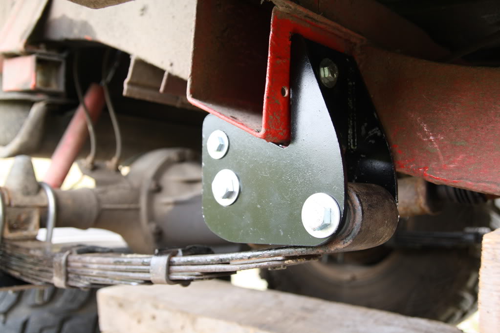

Anyone got a link of plans on how to make the DIY spring hangers ?

This seems to be the standard conversion plate, but I see people often weld extra plates to it or make something stronger/similar ( I would! )
