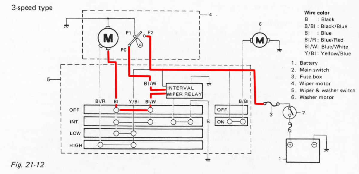

Re: windacreen wipers Not Working
The original switch is quite complicated and when in the off setting supply's power to the motor via the position switch until the wipers are at the low point. It is not easy to replicate this with standard on off switches.kibris wrote:I got rid of my dash ages ago and fitted an Ally one - with smiths clocks and retro switches - something that's bugged me though is the wiper park don't work any more - if you turn them off they stop where they are. How does the park function work?
cheers
Shown in red just make it easy to follow.
- wipers.png (333.63 KiB) Viewed 3804 times
Darrell wrote:The original switch is quite complicated and when in the off setting supply's power to the motor via the position switch until the wipers are at the low point. It is not easy to replicate this with standard on off switches.kibris wrote:I got rid of my dash ages ago and fitted an Ally one - with smiths clocks and retro switches - something that's bugged me though is the wiper park don't work any more - if you turn them off they stop where they are. How does the park function work?
cheers
Thanks for the reply Darrell - I shall study the diagram carefully, have a look at my wiring, scratch my head a little ..................... and leave it as is
no seriously thanks that makes things look a little clearer will give it a go
