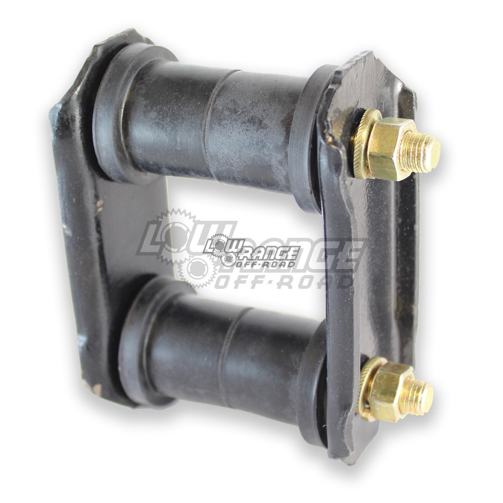

Stock caster is only +3degrees30minutes so running big lift shackles can push you very close to or even into negative caster. They can also allow the axle to move from side to side more while steering giving the steering a very vague feeling like the delay you speak of.
What size tyres do you have fitted? Could you run them with stock shackles? I would be inclined to refit some standard shackles and go from there as well as a new steering box if yours is fully adjusted.
Out of interest could you measure the shackles from bolt to bolt and/or post some pictures.

the shackle size is .midlle of the bolt to midle of the other bolt is 6 1/2 inch almost 6 3/4 inch cheers
Re: streering box is fubar anyone help
Post by Darrell » Tue Jan 22, 2013 11:40 am
Standard are only 70mm, at 170mm it will make the handling interesting :D

:D it does well it keeps you on your toes .but that is a big diffrents im guna have to change them thats mental size cheers
Post by ScottieJ » Tue Jan 22, 2013 1:37 pm
whoooaaaahhhhhh! no wonder it handles badly! I bet the caster is way out as well!
I'd cut those down asap! 90-100mm is an ok length for lift shackles not 165mm :shock:
Those tyres will fit fine with standard height shackles as they are pretty much stock height.

yeah so is that 100mm from midle of bolts or plate .ok cheers for that scottie must be a easy thing to do then
Post by ScottieJ » Tue Jan 22, 2013 2:40 pm
Well stock are 70 between bolt centres so if you want slightly longer than stock somewhere between 90-100 between bolt centres should be ok and hardly effect the caster angle.

ok cheers but looking at the shackles i got i dont think i could cut them without cutting off one of the serport bars that run from side to side .i think im guna have to try suzuki to se if i can get a set of standerd size ones cheers for that have you any luck with the streering box scottie .as you can tell im a rookie with sj so is there that many problems with them cheers
