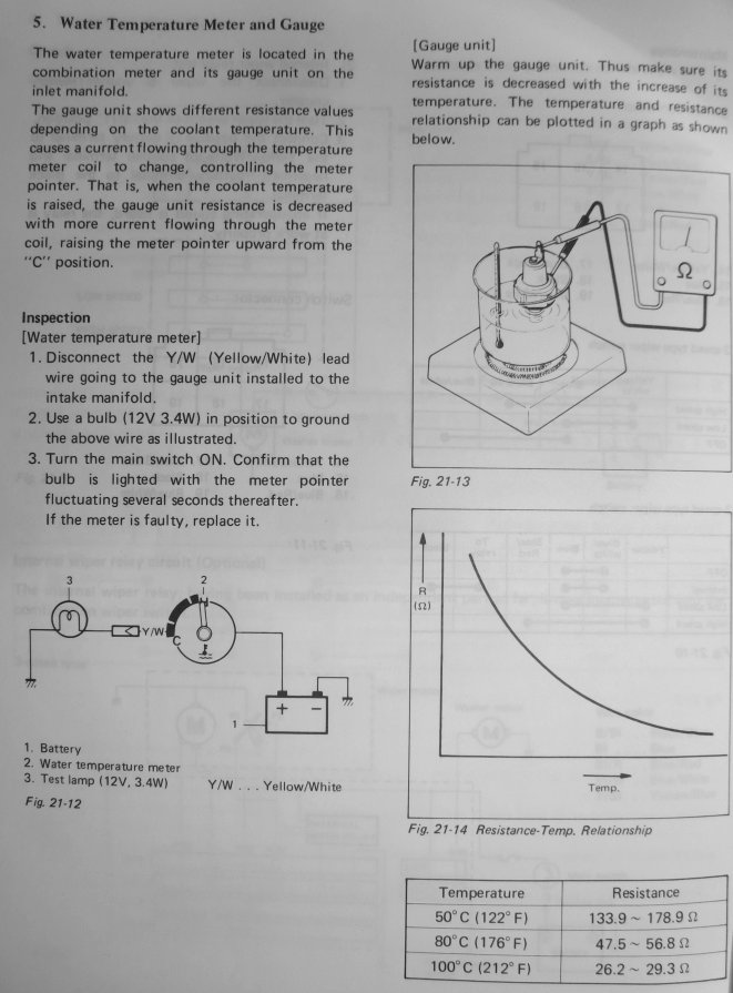

ScottieJ wrote:
I am a bit confused about the temp sender reading wrong though as I'm pretty sure both jap and spanish sj410s should use the same resistance senders?
Just checked my workshop manuals and it's the same resistances for the 410 and 413 but says nothing about the Spanish ones being any different (But we know what Suzuki are like )
- 410 temp sender info.jpg (90.17 KiB) Viewed 6375 times
