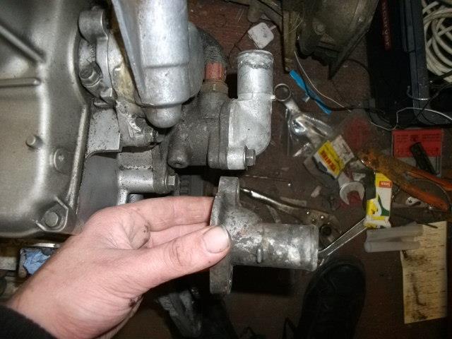

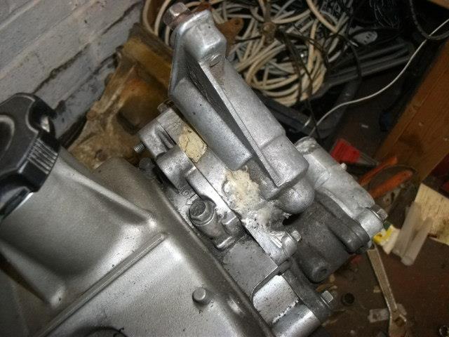

Hi,
I havent got that many pics but here we go....
Basically Tim has attached the majority of a samurai dizzy onto the base of the 16v vitara dizzy...
He's also had to put the distributor shaft on the other side of the camshaft gear so it spins the dizzy the right way round

can you explain what was done to adapt the distributor housing to the 16 valve head.
Many thanks
gell
Many thanks
gell
