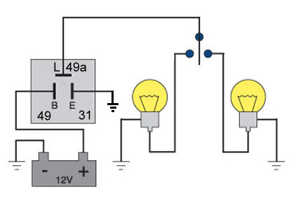

hi still not sloved this problem could do with another flasher but dont no were to get one from can any1 help its for the lwd 413 sameri thanks
Re: hazards an indicators
Post by Darrell » Sat Oct 29, 2011 8:31 pm
Done a bit of searching (and a diagram) and believe this would be a replacement. A "Ring RFL9" , nothing too special and should be easy to get.
However I can not fully confirm this is the correct one not having tried it. Also here is a pic of my original unit.
