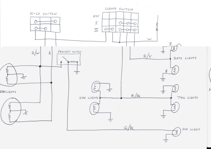

ScottieJ wrote:I think in they do use the red and white for the fog in the Spanish wiring though darrell? Problem is I can't find a Spanish wiring diagram anywhere, I pm'd you earlier as in this image you have posted before it shows it
Have you got a circuit diagram for the fog light that goes with this set up?
I assume this is a normal jap headlight circuit but shows the foglight earth coming from a choice of 2 places. One would allow the foglight to work when the headlights are on and the other would allow the headlights to work only on low beam. I have still been searching for a spanish wiring diagram but the only diagram I can find showing positive switched lighting is in a german samurai manual here.

Extracting the headlight circuit from that manual gives you this.........Sorry best I can find Scott.
Looks old though, with a dynamo instead of an alternator and just a few fuses.
Tinterweb and can't find a soddin spanish diagram :argh:

Post by ScottieJ » Sat Sep 03, 2011 10:36 am
That's all good darrell :doublethumbs: nice work!
