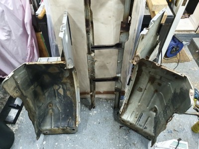

I've sorted all the parts and put them in storage in my spare room. They take up surprisingly little space, which is nice. Also I've disassembled one of the doors, and stripped the tailgate of all its parts. Going to keep going stripping stuff down for now. Not much more to do.
When it finally stops frigging raining
![argh :argh:](./images/smilies/32.gif)
I will get to stripping the remainder of the chassis. Then can get to rebuilding.
A noteworthy achievement I think is disassembly of the front section (front wings and the 'H'-shaped cross-piece that holds the front grill). LOTS of rusted in bolts in difficult to reach places. Also the four corners of the 'H' were all brazed in place. As this was done consistently I suspect this was how they were built.
To remove the braze, I heated to red hot and then (while red hot) hit it with a wire wheel. Wear face protection unless being sprayed with red-hot metal is part of your beauty regime.
While there are some rust holes in the lower part of the windscreen frame, overall the panels are in very good condition. The doors in particular have just some light surface rust on a few spots, but are otherwise perfect. This is remarkable for a 30-year-old British car, however given the amount of hay embedded in the interior I guess my little beastie spent most of its life on a farm.

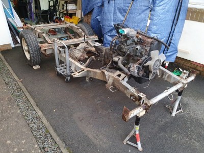

Nearly there.
Could do more today but my back is complaining. That front axle is bloody heavy. Just T-case, rear axle and springs... oh and the engine.
May have to weld up a little steel cradle for it, and screw to a wood frame with wheels. I don't have any lifting tackle so I am planning on lowering the chassis rather than lifting the engine.
Can I rest the engine on the front section of the sump?
I do mean rest, as I would support it there and then lower the chassis, and then slip in the steel cradle to bolt onto the engine mounts. Whatchareckon?
B
Re: SJ413 Driveway Rebuild
Posted: Sat Dec 28, 2019 9:42 pm
by donkeychomp
Personally I wouldn't rest it on the sump. Maybe arrange some wood offcuts so you can wedge the engine secure on the floor without putting too much weight on the sump itself. They are pretty thin those things!

Hmmm, like around the perimeter of the sump? That could work.
What kind of gasket do they have - is it cork like the rocker cover? And, where do you get sump gaskets from as I can't seem to find one.
I believe I spied two M8 tapped holes on the crankcase on the other side to the alternator, maybe for PAS pump or summat. Could use one of those plus alternator lower mount just to hold it while I attach the cradle. More work tho. Will look tomorrow.
B
Posted: Sun Dec 29, 2019 11:18 am
by Jordi
Just get a mate and lift it out. I can lift a g13 and carry, not the biggest, heaviest engines in the world.
