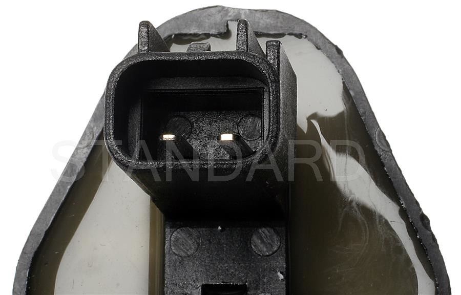

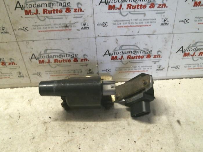

Info I found .....
SJ coil - 33410-80C20
Swift SF413 coil - 33410-60E00
Igniter on both 33370-60G10 = Denso 131300-2240
SJ coil Primary windings 0.87-1.05 ohms Secondary windings 10.9-14.5K ohms
Swift coil Primary windings 0.87-1.05 ohms Secondary windings 11.2-15.2K ohms
Both have a connection like so
