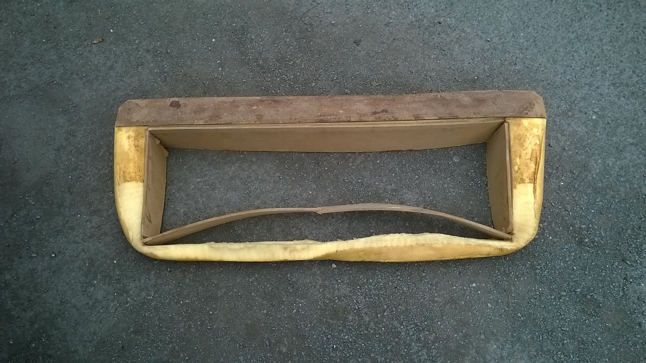

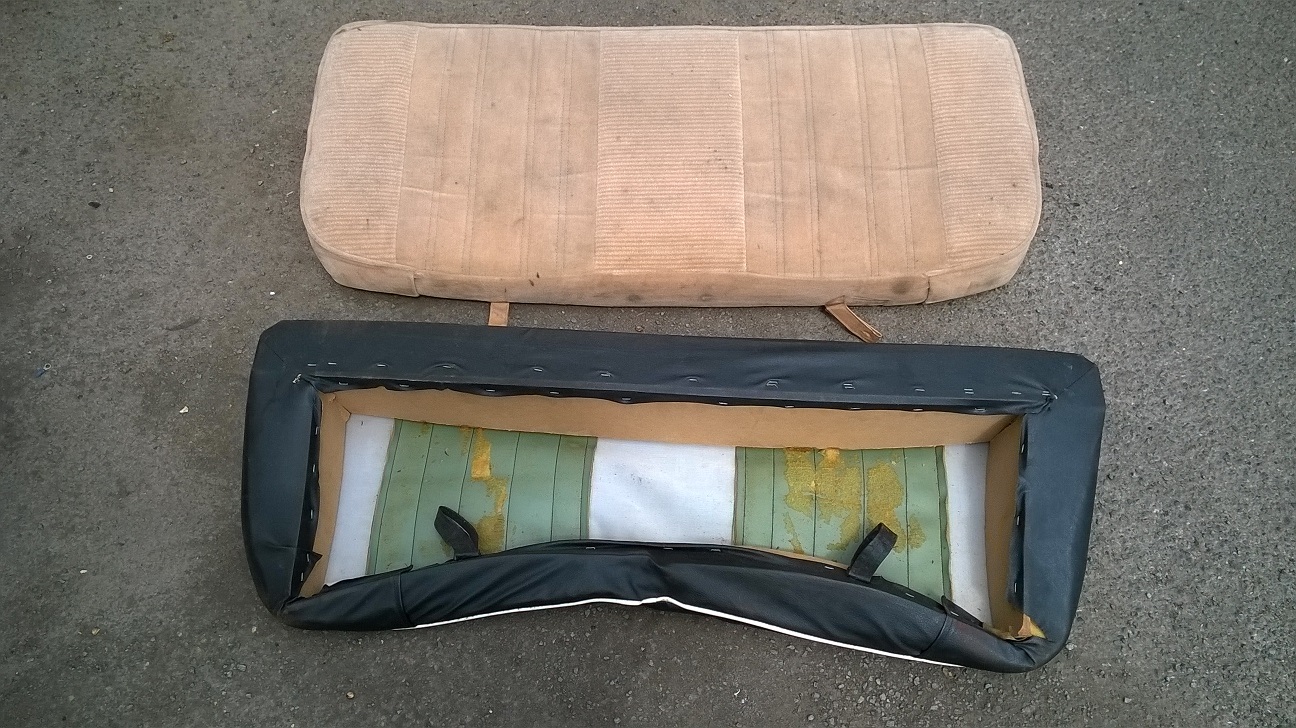

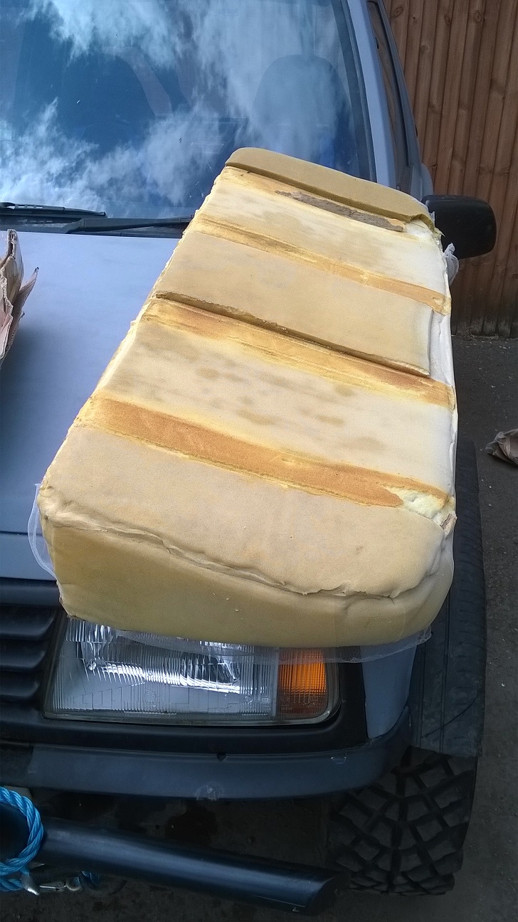

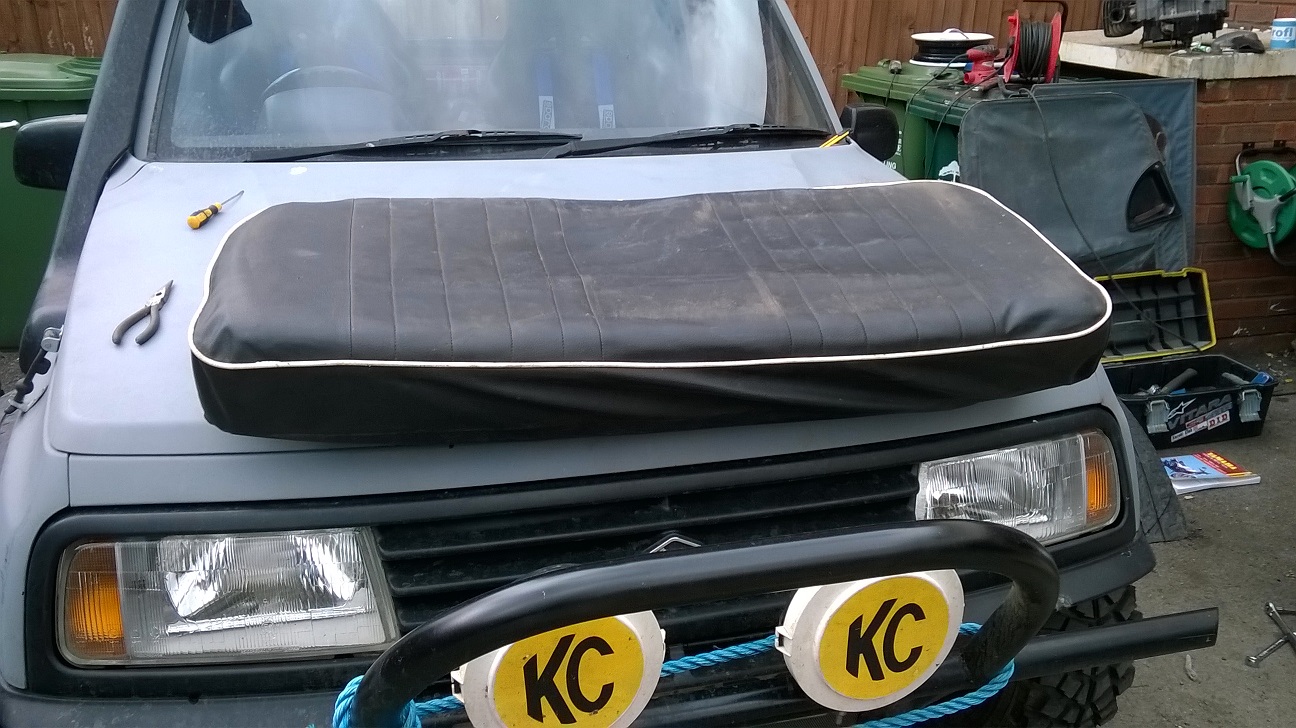

The rear seat had been butchered at some point to put speakers in...why? Anyway a lump of foam to fit is £68! Yikes! I found a complete rear seat on ebay and offered the guy £13 for it...and he accepted. A doddle to fit, took maybe 15 minutes. So my passengers have a comfy seat now...

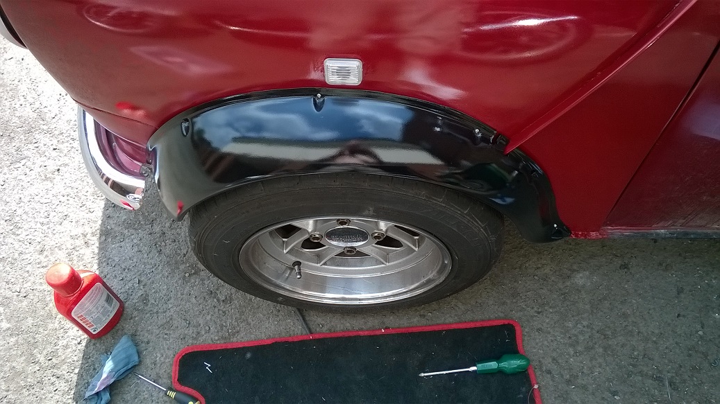

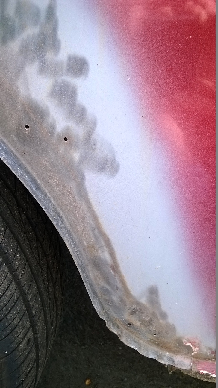

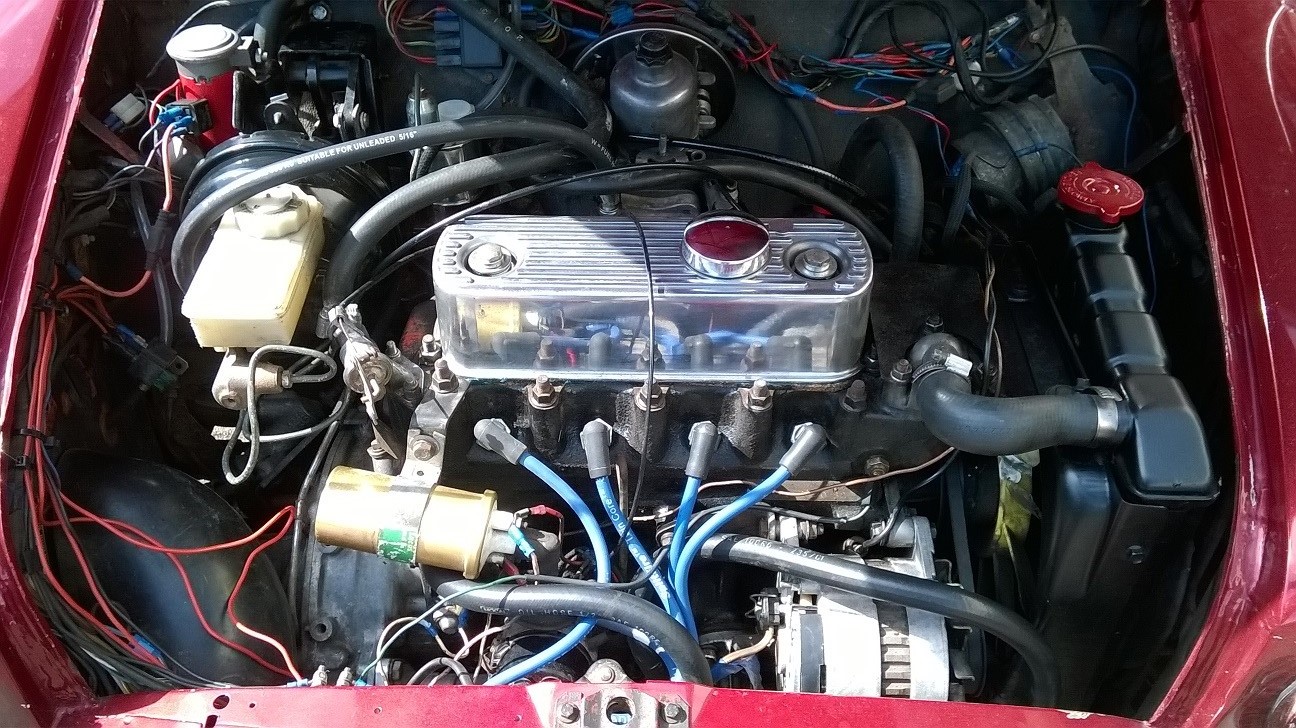

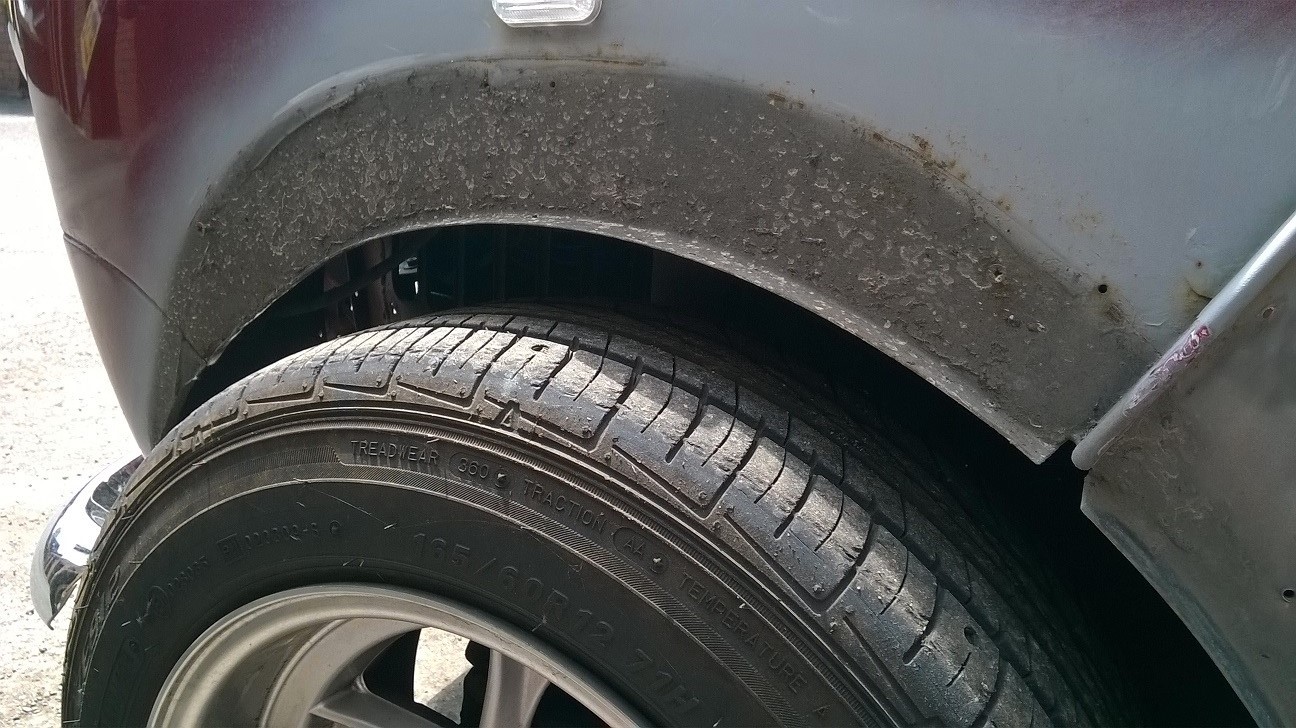

Decided to sell the Mini. I can't bear to part with my Vit so I made a start. The engine bay cleaned up a treat, changed the oil and filter, drained the crap out of the rad and made a start on the wing. Just very minor surface rust and it cleaned up easily.

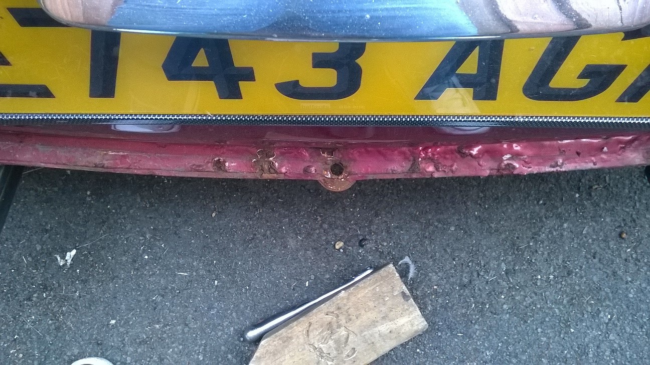

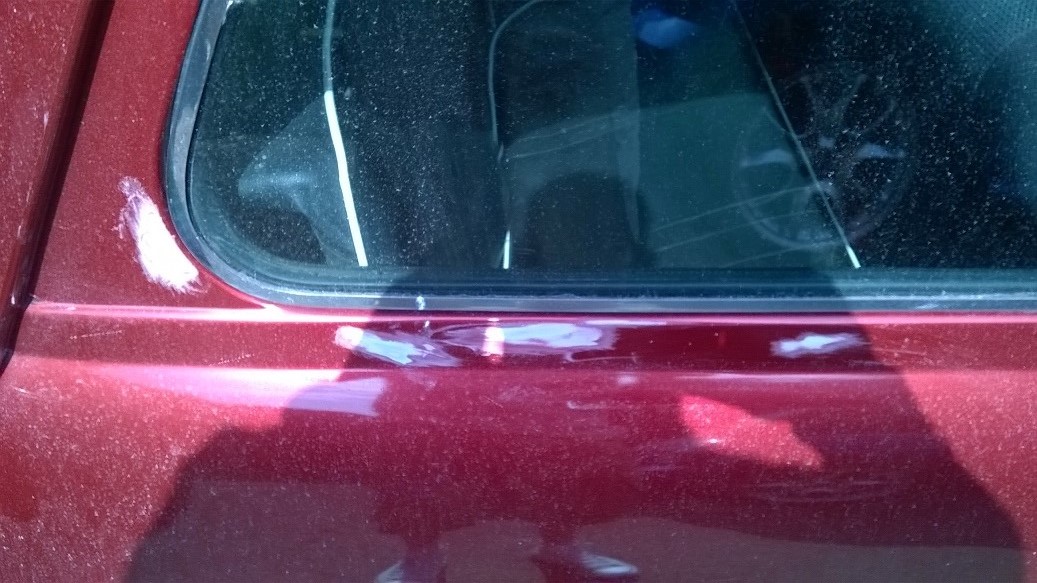

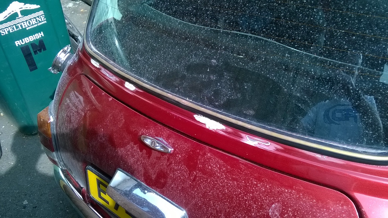

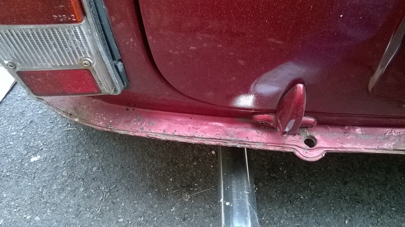

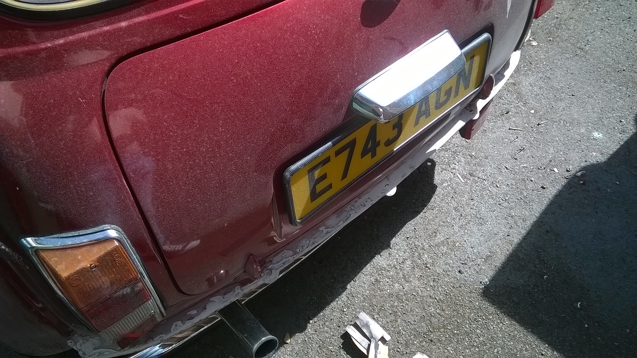

The work progresses. There isn't much to do really but I noticed under the rear bumper a lot of tell tale lumpy filler/rust signs. Got the bumper off, surprisingly easy, thought the nuts would be rusted solid ans saw this mess. Someone had been her before with a load of plod and not done a very good job. So I did a proper job. All the rust and filler removed, cured the metal and a quick skim and it's ready for paint.
Re: The some dosh Mini revamp
Post by donkeychomp » Fri Jul 03, 2015 12:09 am

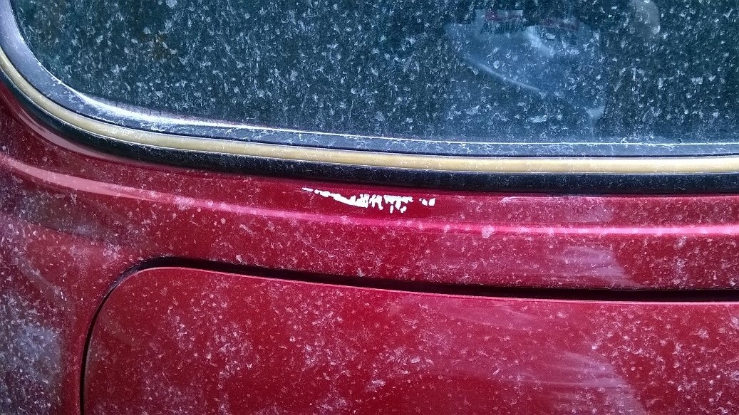

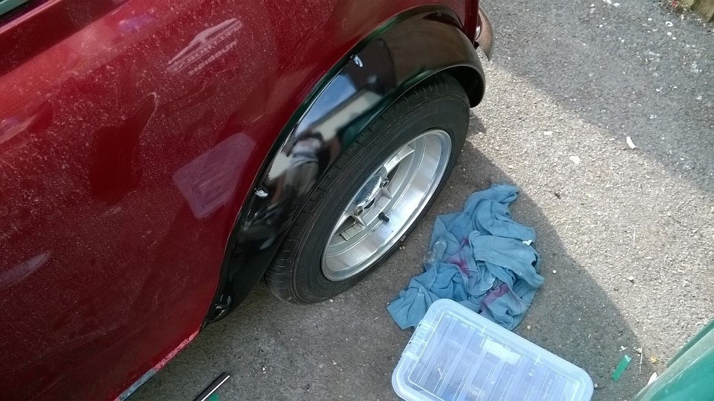

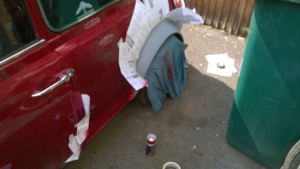

Bumper side done and it's back on, nearside all done, offside started and the small patches where some idiot put gaffer tape on still wet paint...when it's all finished I'll T cut and then mop it all. Should look sparkly!

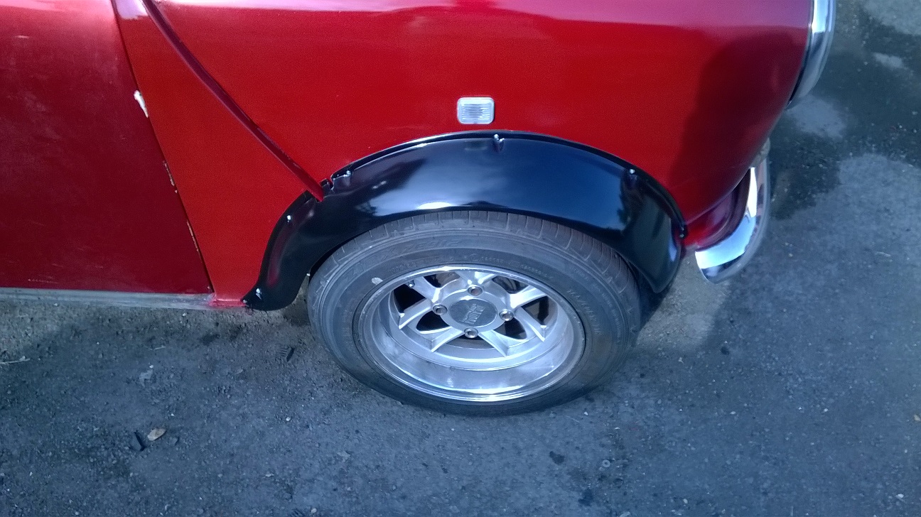

Post by donkeychomp » Fri Jul 03, 2015 9:25 pm

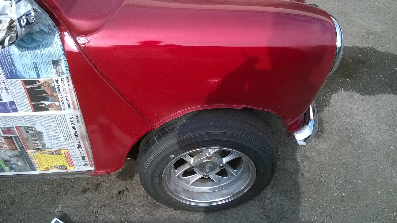

One arch and that bit above the boot to do then the bodywork is done. Interior next up.

donkey,some nice bodywork spraying especially when its metallic paint which is hard to match.
