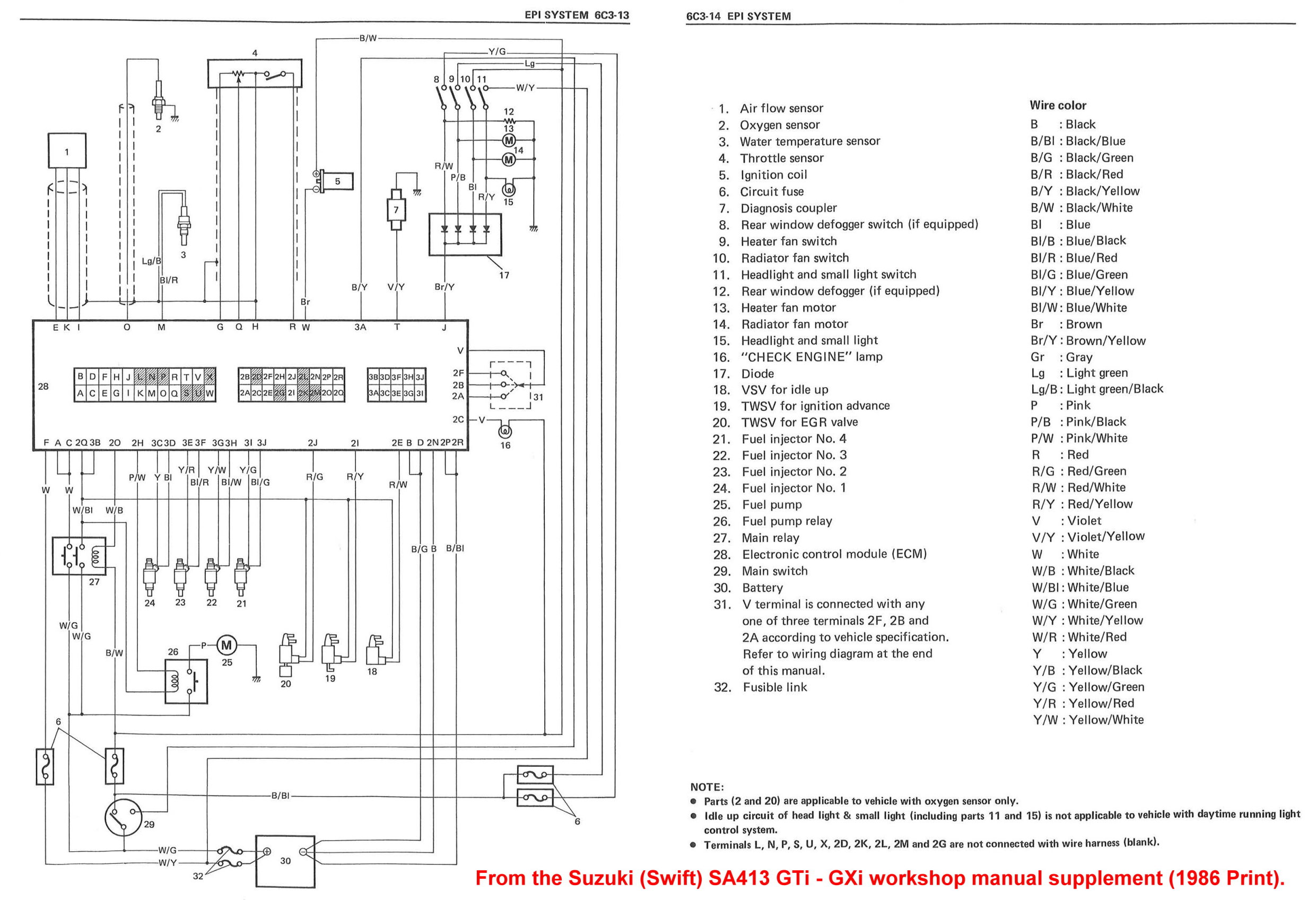

Hi guys.
Wonder if anyone can help or put me in the right direction. I've lost my wiring diagram for my gti swift mk1 engine. Can't seem to find a replacement diagram. Think it's a 1986? Defintly mk1
Cheers

Post by Darrell » Sun Nov 16, 2014 11:30 am
I could not find a sa413 manual online anywhere :argh:
However I did manage to find the GTi supplement.
Again however It did not include the full size wiring diagram which I would expect to find
at the end of the manual :evil:
But I robbed this from the injection section, hope it shows what you want.
Suzuki Swift MK1 GTi Engine wiring diagram..jpg (498.7 KiB) Viewed 9748 times

Thanks very much Darrell. It's not exactly the same but might just get me though! I've hunted the Internet hard so most impressed with that.
Thanks again! :thumbup:

Post by Kiwibrad » Thu Nov 20, 2014 10:27 pm
I did look through that quickly. Couldn't find mk 1. Found Mk 2 or 3 easy enough. Was going to put the question to them but will try what darell found when I'm back at the truck. Got most of it worked out with the diagram found off Internet. Got spark and fuel but no go. Few more checks needed but the right diagram will give a bit more confidence.
