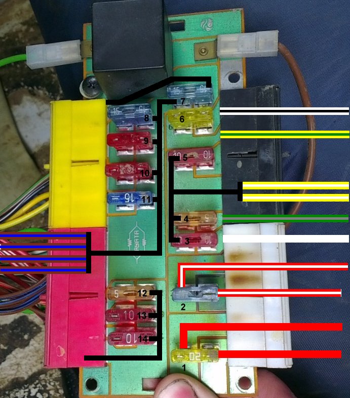

Going by this santana diagram http://forum.suzukiclubuk.co.uk/vi ... =11&t=2097 we have this

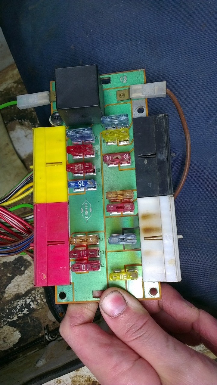

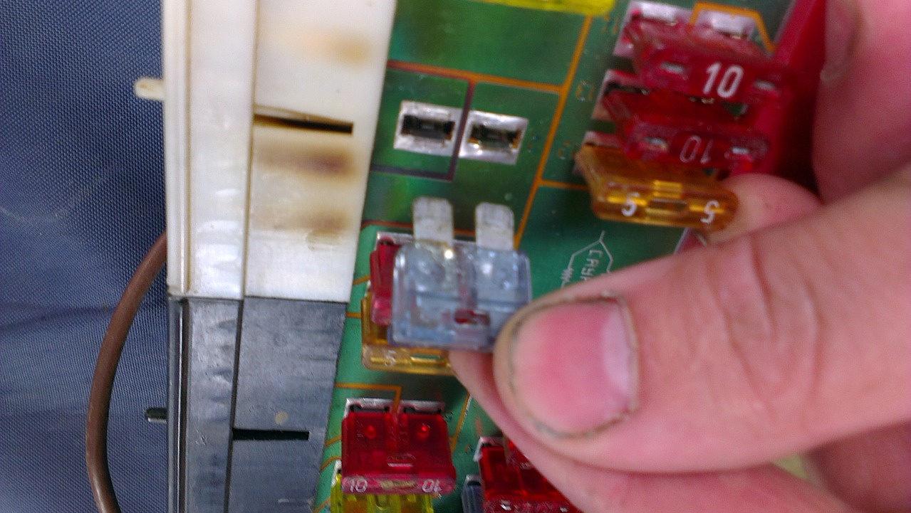

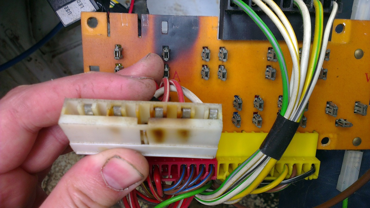

Darrell wrote:Going by this santana diagram http://forum.suzukiclubuk.co.uk/vi ... =11&t=2097 we have this
Thanks, That is very helpful! It's also very interesting, my fuse box/panel/board thing, has the same 'burn' marks on the white connector. When I bought it, the 15Amp (blue) fuse above it was melted (I mean literally melted, not fused). It's all a bit shit really! I thought it was because the previous owner had done something funny with the wiring, but it could be a 'Normal' Santana loom problem.

Re: Santana Fusebox
Post by Darrell » Sun Mar 30, 2014 10:25 pm
These are the pictures I have in my archive, including the one with the wire colours shown. I gave up finishing it as I don't know the rest of the wire colours.
Any chance of a pic or 2 of yours , or have you chopped the connectors off.
Cheers - Darrell.
