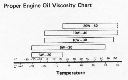

It says under the bonnet on a sticker, in England we use 10w40, I'm sure Darrell will post a viscosity chart in a minute, I'd have thought it would be the same for .

Re: Bought a very old Suzuki Samurai - In need of some help!
I would say 10w/40 should be fine
I think the one Ive bought is 50W-20.....is that going to be ok???
It was the only option at the local garage......guy asked whether it was diesel or petrol, I said petrol then he said right, this one. I asked for the 40-10 and he said, that the only one they had was 50-20 and that it was ok.....
Should it be okay? How much should I add?? a little and then check the oil and if I need more add more? Should it be filled up?
Take it back and tell him he was wrong, a 20W-50 isn't really suitable.
Remember jmods is in the Seychelles, not cold and damp Blighty, so he won't have any cold start concerns.Rhinoman wrote:Take it back and tell him he was wrong, a 20W-50 isn't really suitable.
Ummmm, take it back? really?
What about quantity to put in? I thought it would be ok, as it was the only one he had in the garage......So is a really a no go?
Well going by the chart I would say that oil is suitable given your climate. http://www.visualitineraries.com/articl ... helles.asp
As regards the level just add oil, leave 30 seconds and recheck level, repeat until oil level is at the F mark.
We don't generally use that oil over here because in the winter we can regularly be below freezing.
Darrell, thanks a million for confirmation! Ill go ahead and add the oil tomorrow when I get home from work!
And thanks for the guidance on how to go about it!! I think Ill take it to the mechanic in a weeks time or so....just so he can have a quick look at the whole thing and see if there are any issues. I just hope it lasts till my contract is up here!!
