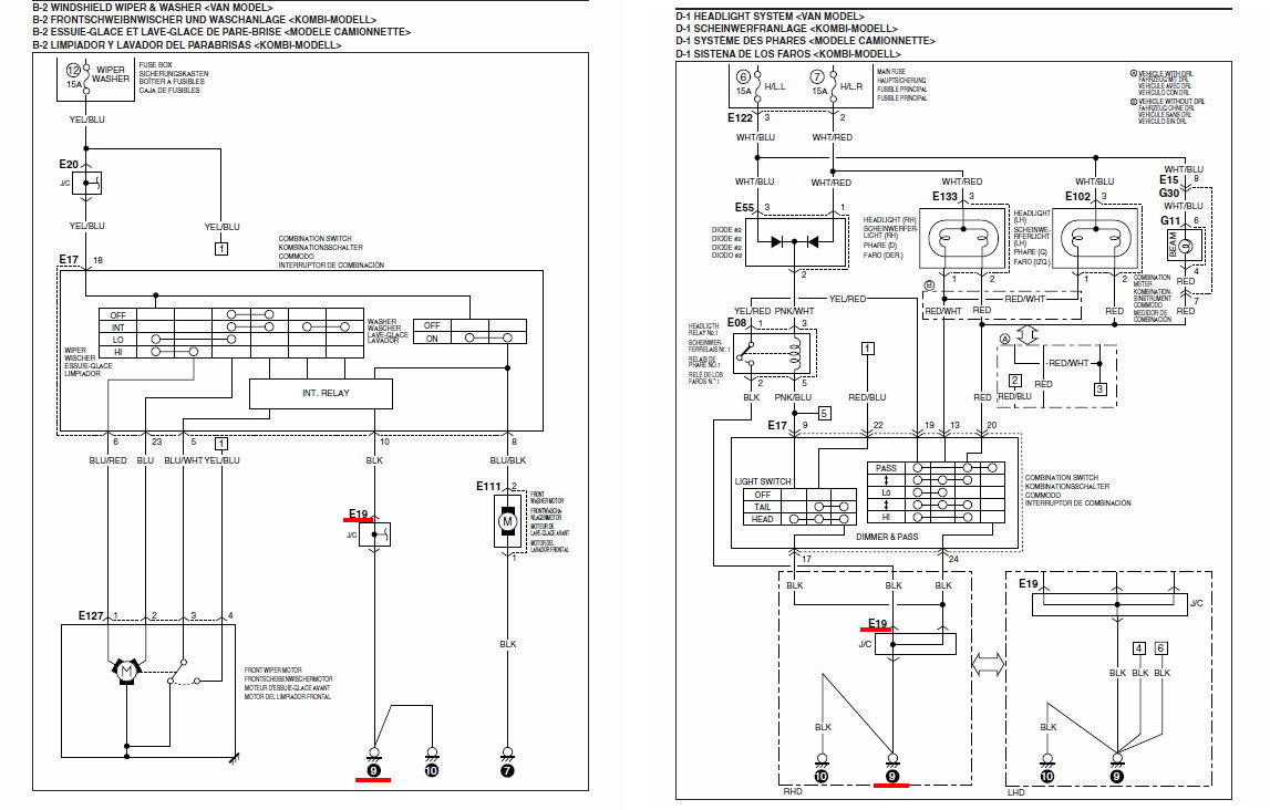

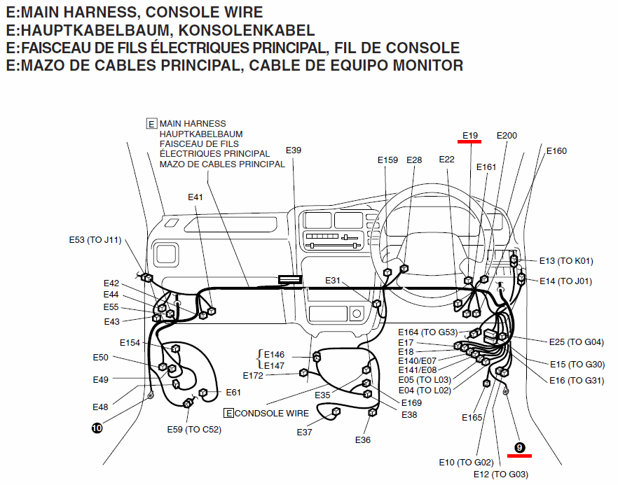

Well I've been trying to get my head around this, but can't.
Very often when you have earth problems strange things can happen.
I see both circuits share the same earth junction block and earth point.
I can only suggest checking these are OK.
I can't figure out why it makes any odds being on high or low beam
A few diagrams may help............

Re: grand vitara 2005 1600 petrol (wiper problem)
it was weird I have had car about 2yrs (never realy noticed fault) one day it would not start and I found 2 fuses blown in fuse box not sure which two now but wasn't long after that I noticed if I didn't switch wipers to OFF then they still operated when I turned ign. off (even if key is removed) then the other day I had wipers on and when I went to main beam they stopped.(switch back to dipped and they started again)
may be 2 faults but meby been there all the time and ive not noticed.
I will check earths and see if that's the problem but sounds like some sort of short and wipers are using main beam feed (which is a direct feed) rather than an ign. feed
if nessesary I will rewire wipers from ign. and see if that cures it
THANKS FOR REPLY AND ANYMORE INPUT WILL BE MORE THAN WELCOME
checked today earths all sound BUT the +ve feed to wiper switch was live all the time (don't know why) so I disconnected it and fed an Ign. live feed to it.(with a 10 amp inline fuse)
it seems to have fixed both problems so now wipers switch off when ign. turned off and I can use main beam without affecting wipers.
don't know what caused original problem (presume it was some sort of short cct. somewhere)
