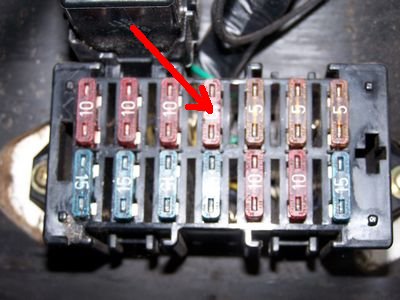

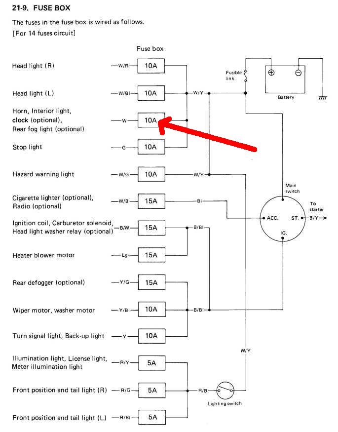

Post by Darrell » Tue Aug 20, 2013 11:16 pm
Did you fix it ??
I've been having a look at the wiring diagram and to me it just looks like a blown fuse.
If you have switched earth headlights they have a constant live.
This means the highbeam indicator light also has a constant live.
With a blown fuse this makes makes an earth via the horn coil when pressed or the interior light bulb coil when the door is opened.
Mind you I could be talking bollocks :er:
fusebox 2.jpg (29.33 KiB) Viewed 6378 times
