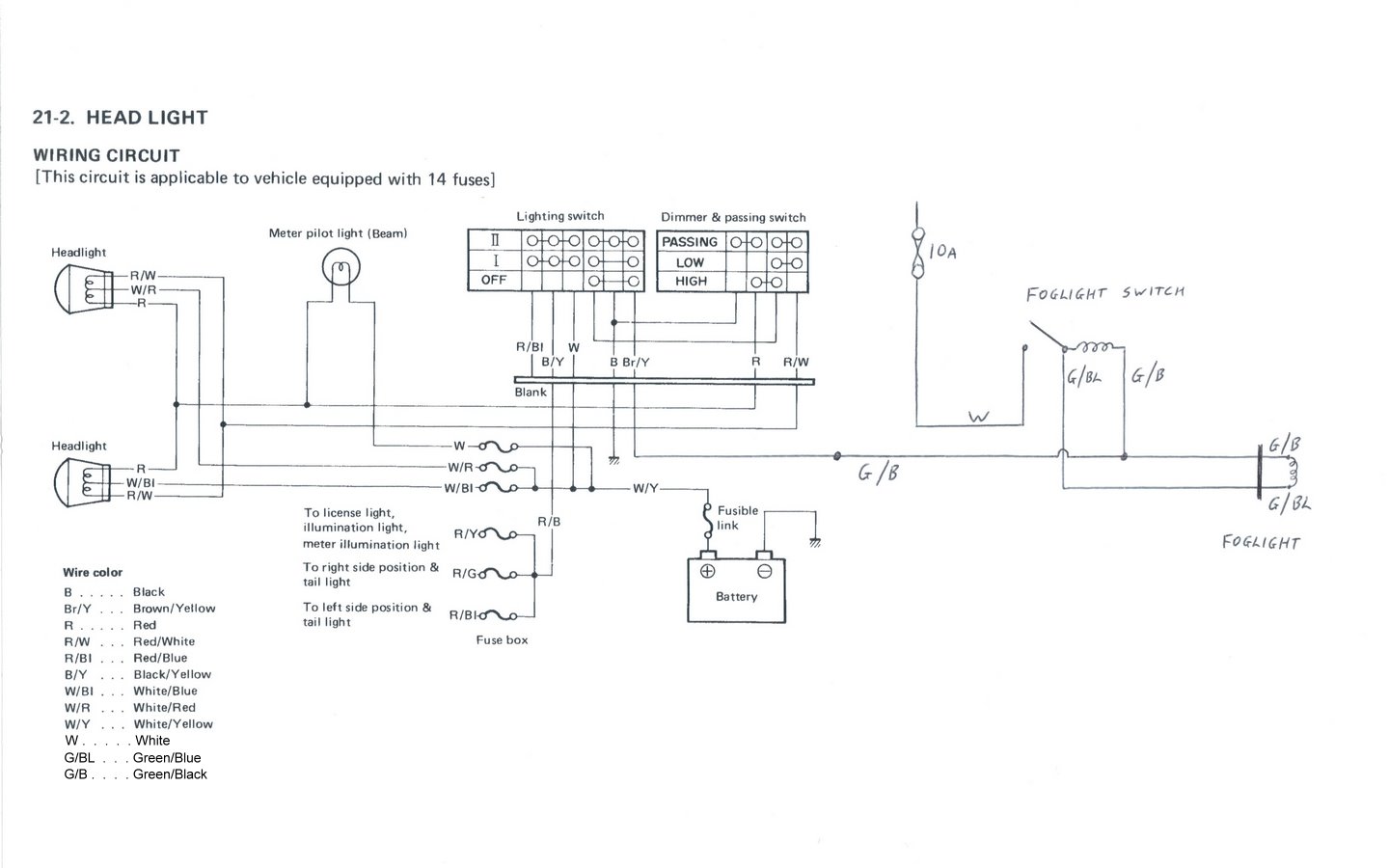

Post by Darrell » Sat Aug 10, 2013 11:09 pm
The fog light switch uses the same wire as the fog light for earth. This is so the fog light only works with the headlights on.
I guess this wires broken somewhere so that's why the fog light didn't work.
Did you just earth the wire from the fog light to get it working (Same as the switch)..

Post by penpontgreenwoodwork » Sun Aug 11, 2013 11:27 pm
I just earthed the switch (green and black wire)?. Don't know what has been changed from the original but now it all works and so does the switch light. It does however come on even if the side lights arn't on.
