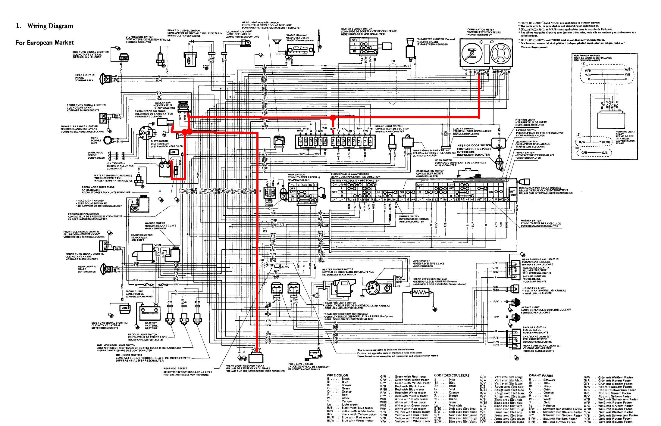

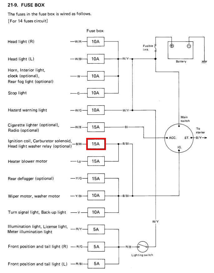

Post by Darrell » Mon Jul 01, 2013 9:27 pm
If the fuselink has blown you will have nothing at all.
This fuse covers what you describe.
Bung another fuse in and see what happens.
If it blows straight away then you've got some fault finding to do :thumbdown:
Re: No spark!
Post by turbo-tom » Mon Jul 01, 2013 9:31 pm
Didnt even know the coil was on its own fuse! :lol:
Re: No spark!
Post by Darrell » Mon Jul 01, 2013 9:44 pm
That fuse feeds the dash,coil,carb solenoid and alternator. It also goes to the headlight cleaner, but I've never seen one with that fitted..
