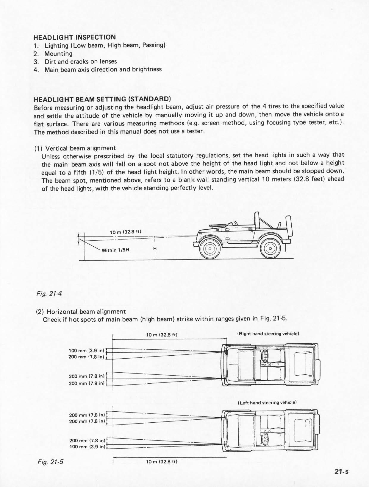

Not too bad then, just the oil leak to sort out.
Well,and a headlight tweek..
Re: Suzuki sj 410 from Cornwall PROJECT Never Ending Project
Post by Darrell » Sat Jun 01, 2013 1:40 pm
I'm surprised they didn't set the headlight there and then.
Guess what..............Diagram.

Yep the chap that motd it is going to adjust the headlights when I pop in again
