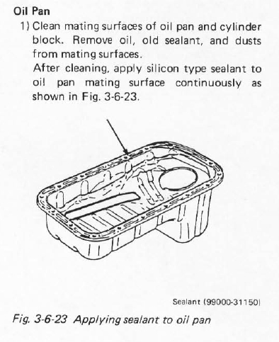

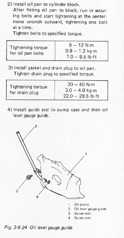

Re: Really at end of tether with sump leak on 8v vit 4u2
Post by twiss » Thu May 16, 2013 4:42 pm
Well, had a look in the service manual, it says a slightly different method of tightening... however, there is a torque spec for the nuts
