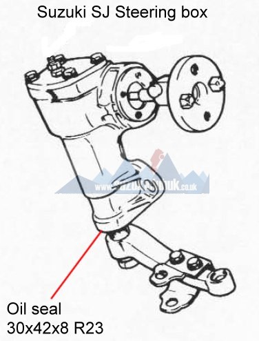

So far only found a size for the lower seal
Stock is 30x42x8 but a easily a available 30x42x6 should work fine
I'm sure the input seal will be easy to get a replacement for as well, I hope so as mines leaking on my power steering :lol:

ScottieJ wrote: So far only found a size for the lower seal
Thank's for that :thumbup: , I tried to get the number off mine but couldn't read it. It did look like an R23 seal though, So guess what.....................................

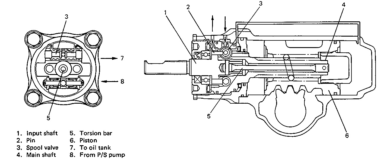

ScottieJ wrote: I'm sure the input seal will be easy to get a replacement for as well, I hope so as mines leaking on my power steering :lol:
If you have vit power steering it looks a nightmare!! :thumbdown:

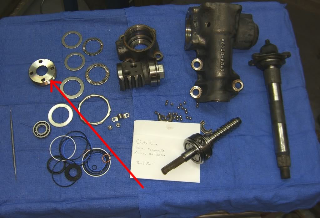

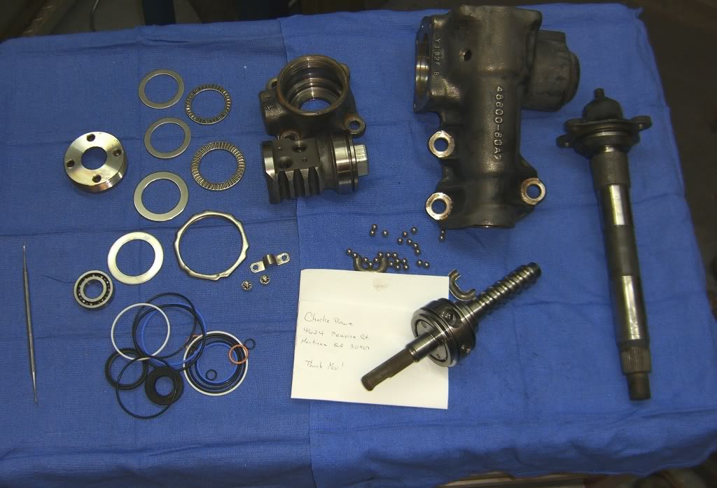

Post by Darrell » Tue Jan 22, 2013 11:07 pm
Or does this unscrew and have the oil seal pressed into it?????
Sod the rest, look at all those balls :shock: :shock:

Post by ScottieJ » Tue Jan 22, 2013 11:26 pm
Doesn't look too bad :lol: apart from all the balls :shock:
Where did you find those pics Darrell? Was it a rebuild guide?
