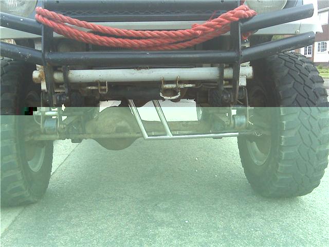

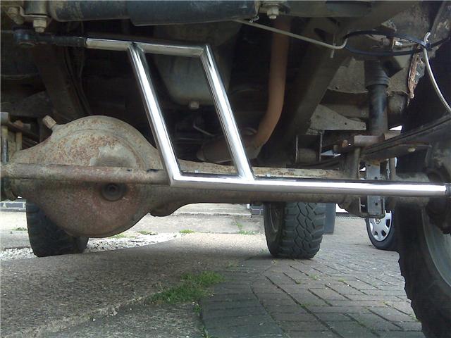

But my friend and i had been busy men this morning and hand made a stainless steal Z link to see if it would improve the horrible bump steer!
And the good news is it has improved. Also looks quite good too! Because we didnt really have much time the ball joint is in a fixed position, but after my greenlaning/camping weekend we will remove it and make up an ajustable removable ball joint on the drag link.

That looks pretty nice! fair play! you'll find that a hi-steer will imrove it even more though!
