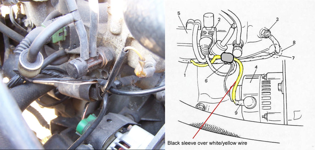

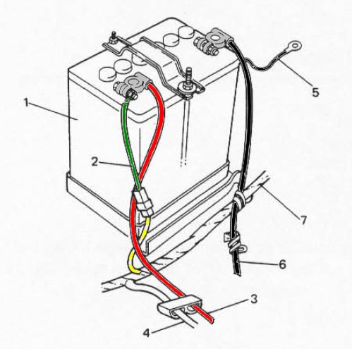

It's hard to tell in your pic but I'd say one of the white and yellows (the one with the cover?) should clip onto the wire coming off the alternator. The other white and yellow one looks like it has half the fusible link on and should clip onto a brown wire coming off the battery positive.
im about 99.8% sure of it. I presume the black wire off the alternator is bolted on to the main alt +

Scott may be right about that wire I questioned, it could be the wire from the alternator to the fuselink then battery. My fuselink is a green wire.

Alternator end
alt wire.jpg (130.62 KiB) Viewed 3862 times

Excellent , no need to buy Any Wire then,
