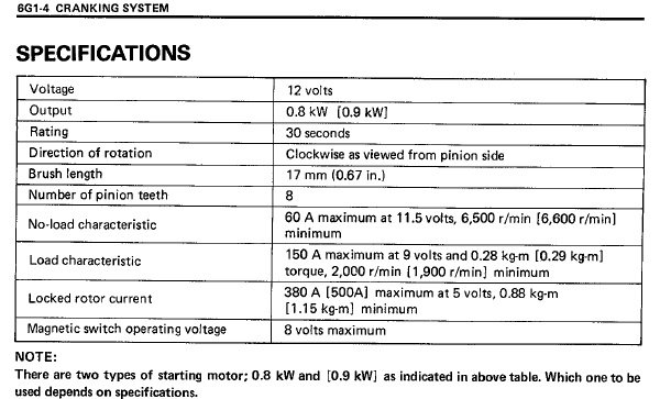

The specs for the starter on the SJ 1300 and the vit 1600 are
1600 and 1300 starter motor specifications.jpg (60.12 KiB) Viewed 8369 times
So I assume a cable rated at 150amps would suit ??
To be honest I would take the old cable to the motorist shop and let them match it, I know my local store sells it off the roll, or as above http://www.vehicle-wiring-products.eu/V ... ycable.php
I don't fully understand the figures IE Locked rotor current :er: :er:
Trying to start a locked/seized engine maybe :er: :er:

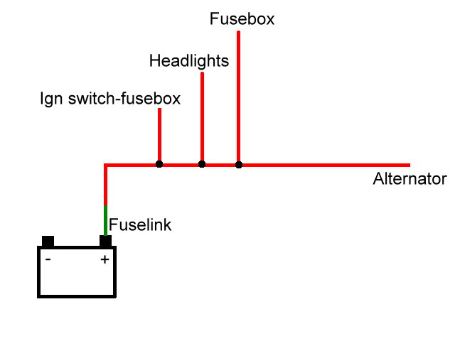

The standard cable from the battery to alternator has a fuselink on it to protect the main loom.
Also the wiring shows all the loads are spliced off it and therefore the supply to them can come directly from either the alternator or the battery. I guess you could disconnect the original wire and isolate at the alternator end, but leaving the fuselink end connected to supply everthing and run a new wire from the alternator direct to the battery. What's wrong with the original wire?

Post by ScottieJ » Tue Dec 18, 2012 11:54 pm
The only wire I'd change is the battery to starter motor.
The only reason I actually changed mine was because I moved the battery to the passenger side.

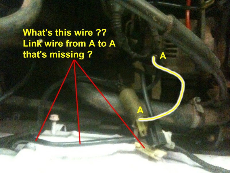

I need to basicly rewire it because when I removed the body I think I lost some wire or I've forgot where it plugged in . Ill take some pictures in abit see what u think

In the picture ur see short black wire with plug, thats from the alternator , then theres two other wires close to it, both white with yellow stripe, not in picture shown i have another power wire from starter to battery,hope u understand that :)

Post by Darrell » Wed Dec 19, 2012 9:01 pm
