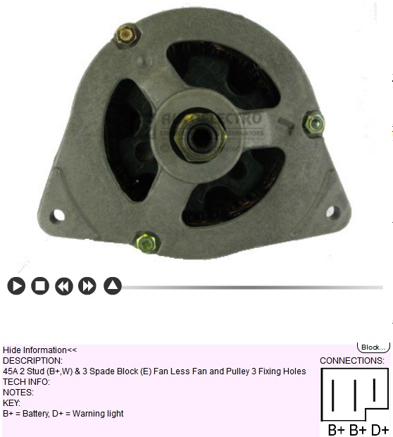

Alright guys? Well after having a tinker at the weekend I found my alternator is not putting enough power.
My problem is this, I took some numbers off it and it doesn't match the one listed for the zuke.
I've attached a photo of the numbers from my current alternator. Blue print say it's a 35amp unit.
Any ideas?

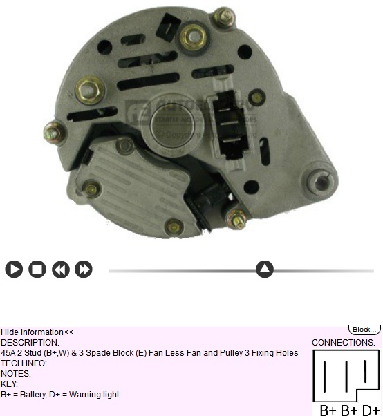

Post by Darrell » Mon Nov 12, 2012 7:24 pm
From what I could find its a landrover defender one :yuk:
Can I assume it no longer has the original connector plug.
Bosch 9120144289.
AEA6153 (b).jpg (69.48 KiB) Viewed 7734 times
aea 6153 (a).jpg (70.86 KiB) Viewed 7734 times
